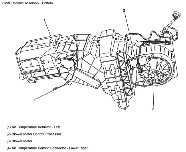

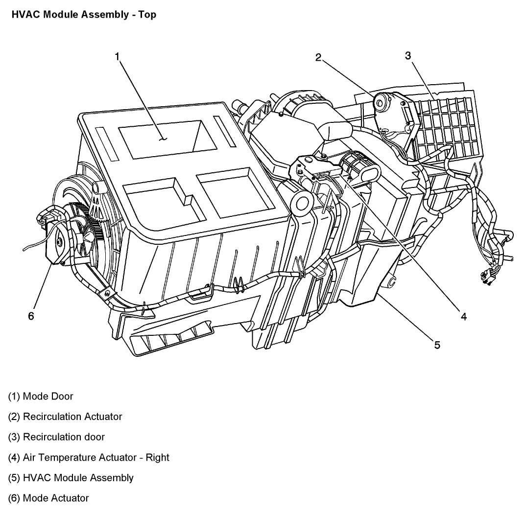

If both hoses are the same temperature then it is likely a blend door problem. The blend door sends air through either the AC or heater cores depending on how you set the temperature controls. When the actuator fails on them it no longer moves the door and you get air at whatever temperature it failed at.
As you say you are getting no heat at all I suspect it is the core or the heater control head. Your truck should have two different blend doors and they normally do not fail at the same time. You usually get heat on one side or the other. The pictures show the two temperature actuators and locations.
