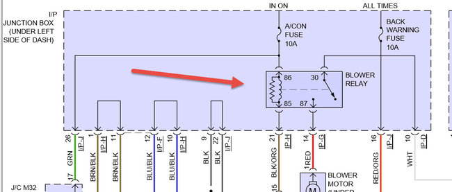

check to see if there is power coming to the blower first before replacing it . if this is auto temp control where you set temp then it HAS to be scanned by a mechanic to see what is wrong with the unit.

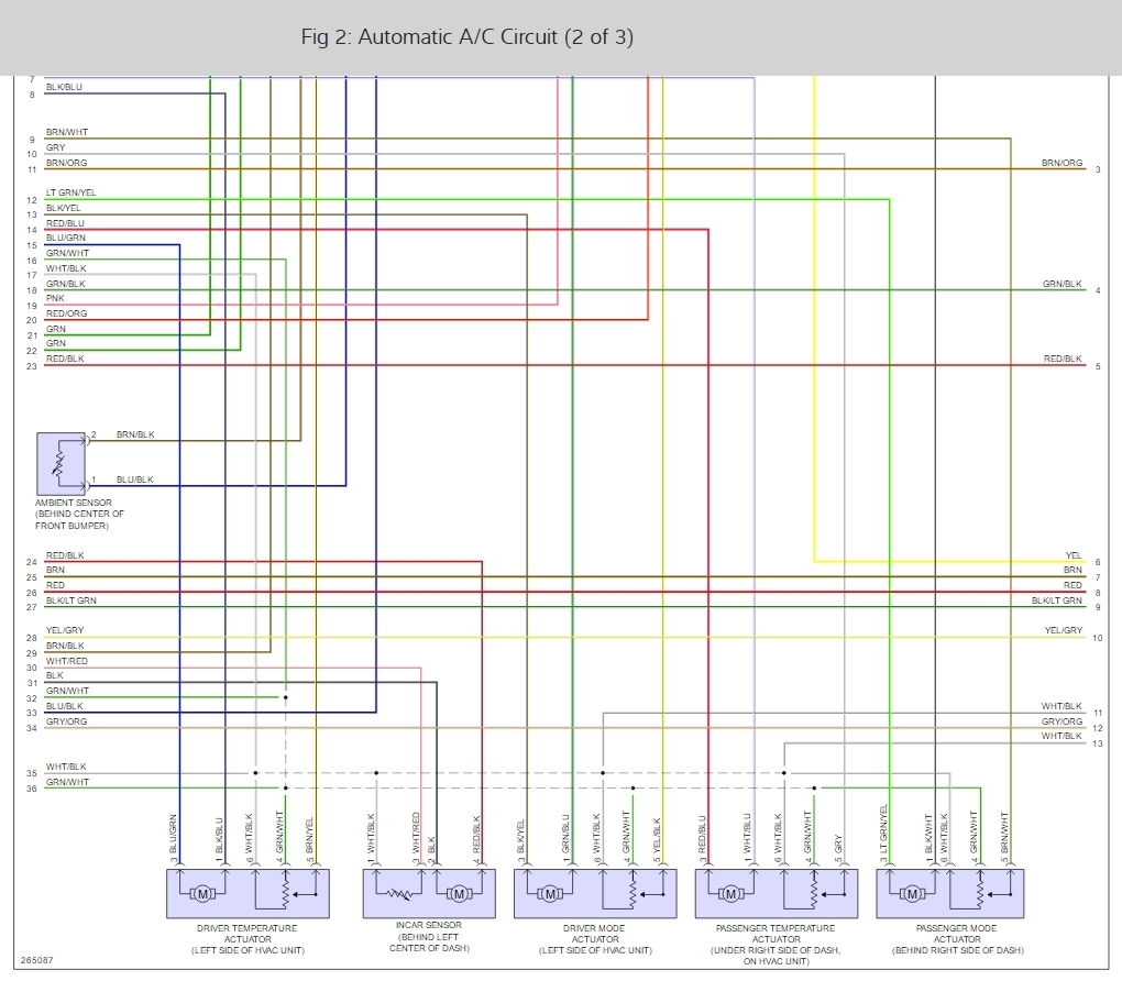

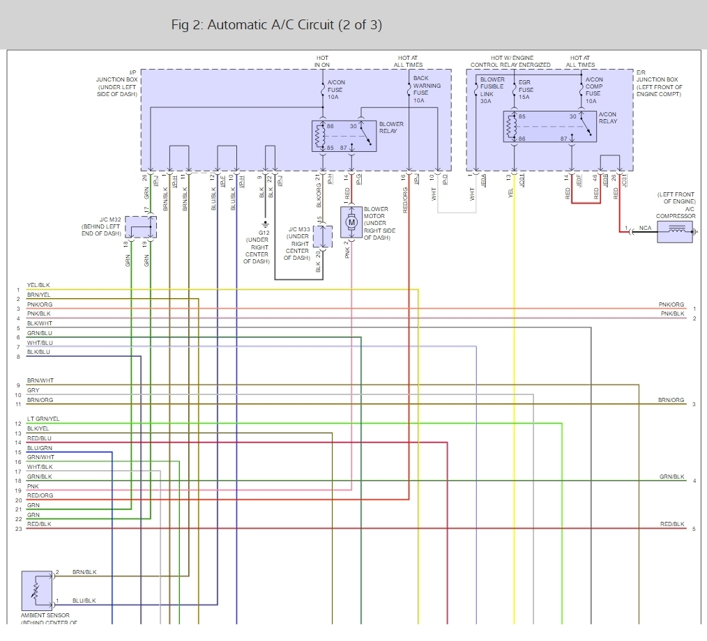

Hey Larry,
Here is a complete wiring diagram for the car, check for power at the relay first then go from there. It looks like there is a fusible link 30 amp, check there first.
Please let us know what you find so it will help others.

Thanks Ken, the blower motor runs when wired directly to the battery, and I have 9.4 volts at the connector, but still won't run using the control panel. So I guess it's back to Kia to have them check it out.
