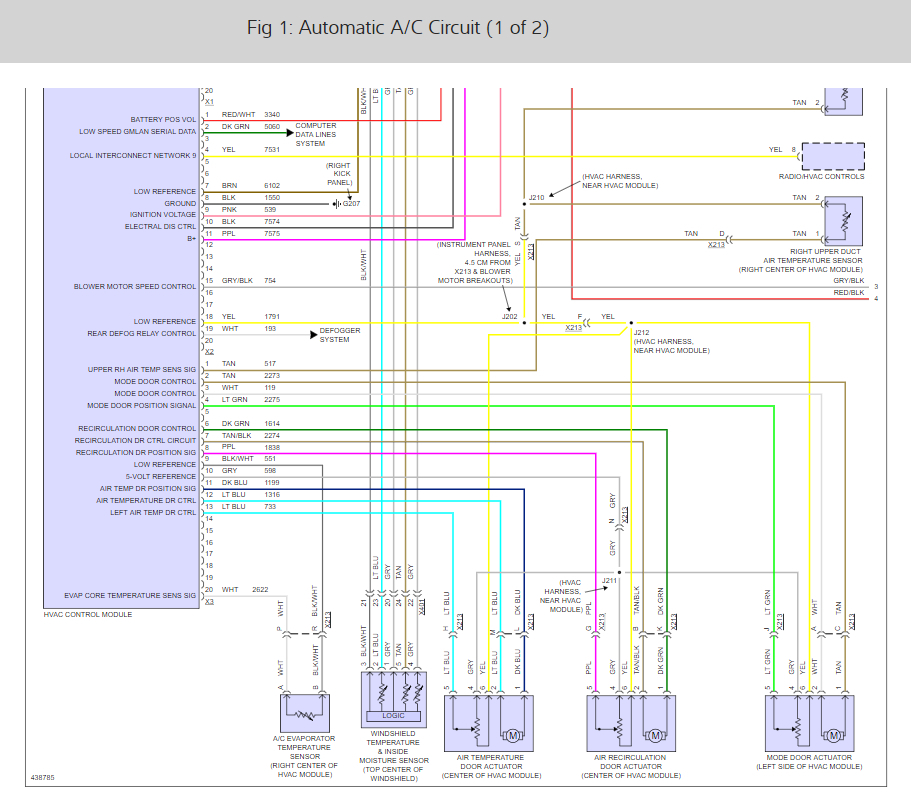

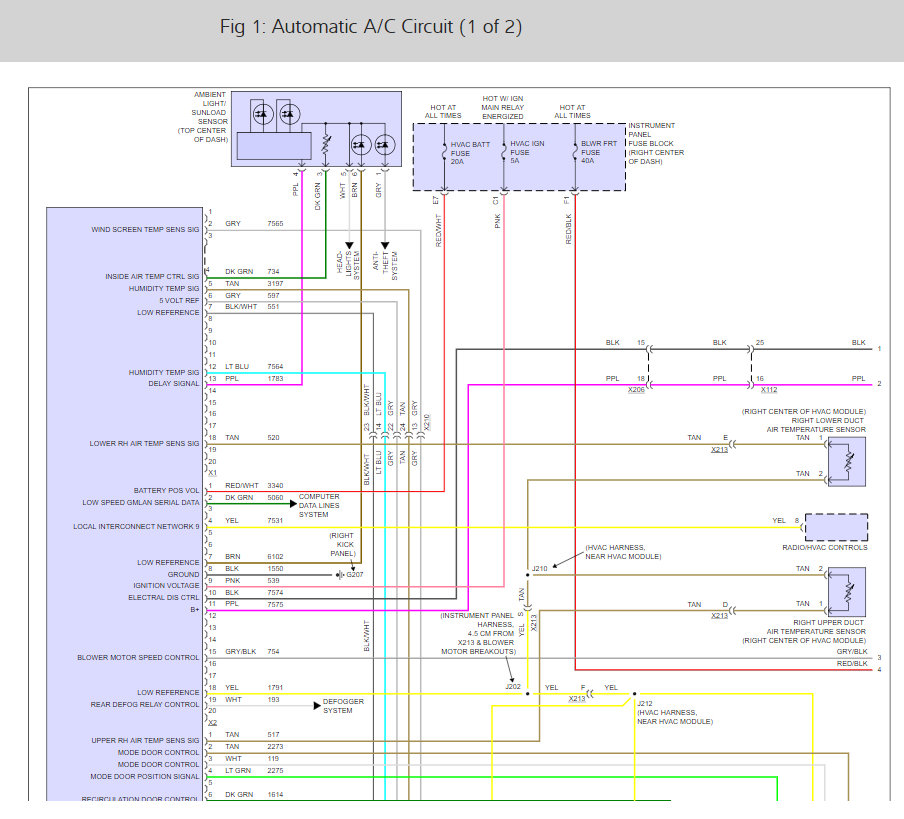

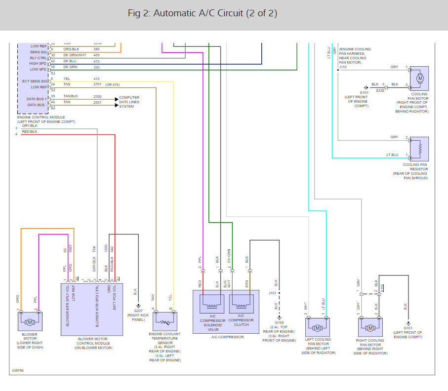

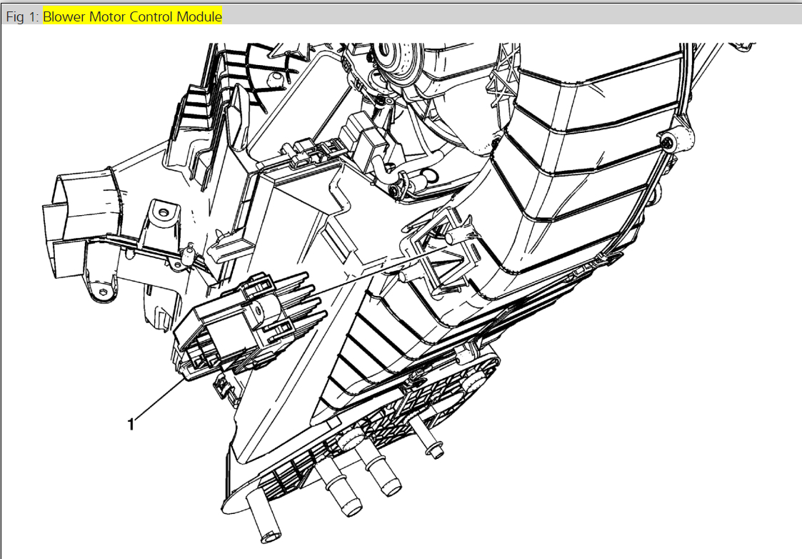

It sounds like the HVAC controller is having a problem, but just to be sure can you confirm the part you replaced is the same in the diagrams below? Also, I have included the blower fan wiring so you can see how the system works.
Check out the diagrams (below). Please let us know.

That is the part that I replaced with no result.

Thank you for your reply Ken, the schematic swear helpful still need the location of the blower fan relay.
Jul 17, 2018 at 8:30 AM
There is no relay just the power resistor and the controller. Can you see if the red and black wire has power to power resistor? Also check the ground (black) wire.

Hi Ken, yes the red wire has 12 volts and the black wire ohms out to ground.
Jul 17, 2018 at 12:08 PM

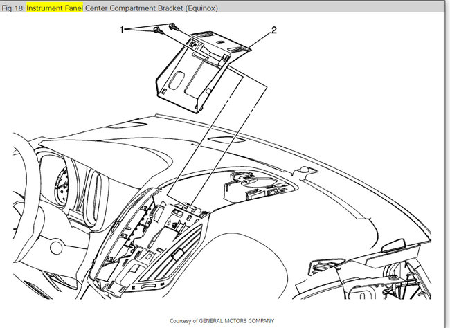

If the blower motor runs and you already replaced the power resistor it only leaves the control head. Here is a diagram to help you remove it I would try a used one but you may need to get it initialized.

Hi Ken, no wire damage and has not been wet I will try a used control head. Thank you for your help I will let you know how it turns out.
