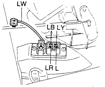

I am in the process of replacing my blower motor and blower motor resistor. I have already installed the new blower motor(old one was locked up) but still no power getting to the blower. So I checked if there was power going to the resistor, or what I am assuming is the resistor and it seems there is. But I have been searching for a new resistor and everything I pull up looks nothing like what I have behind my glove box mounted to the black case. I also have a silver in color line going from the bottom of the assumed resistor and into the heating/cooling case. So I am wondering if I am looking at the wrong part. I do not see anything else in that direct area behind the glove box that resembles what Google is saying my resistor is. Any help is much appreciated thank you

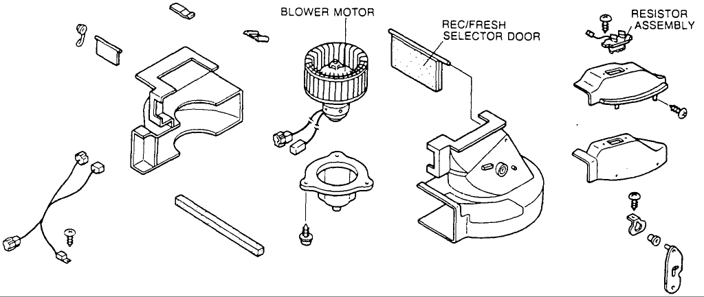

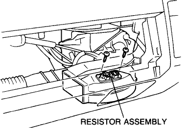

Looks like it's in the blower case right below the glove box.
