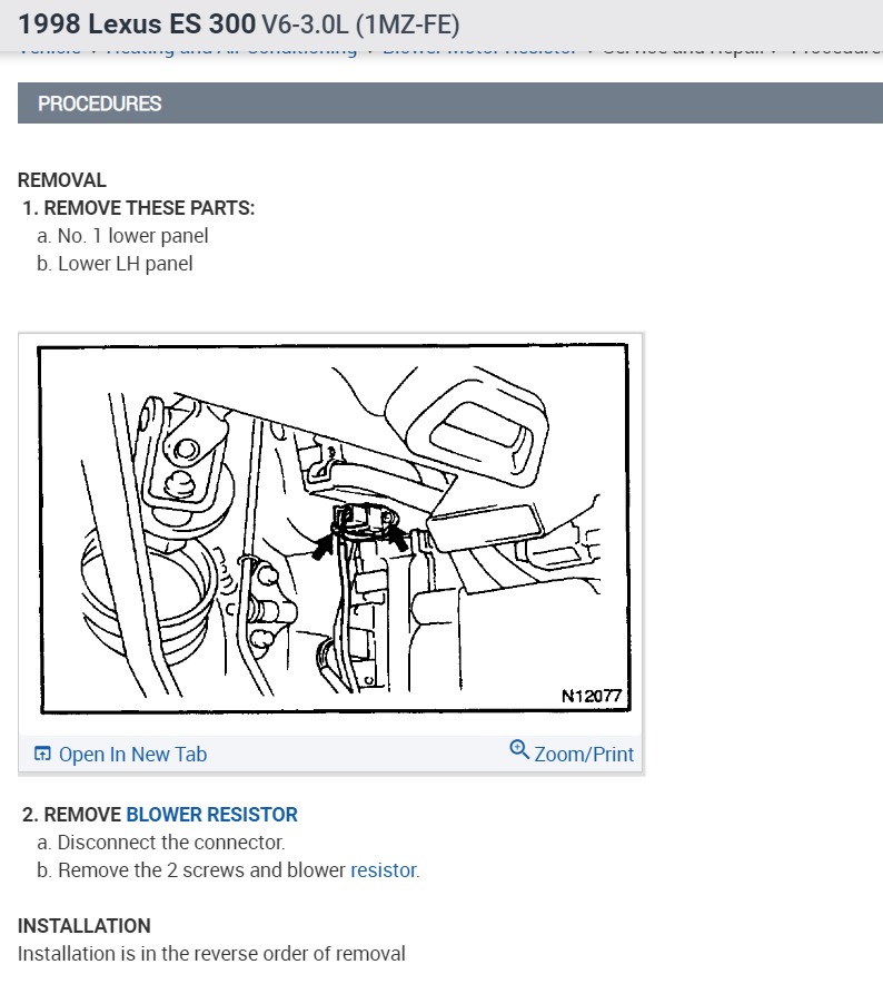

Hi, I'm trying to locate the resistor for the blower motor. My A/C will not blow. It's cool to the touch but won't go up in speed. I've replaced the blower and it comes on but goes right back off. I want to check the resistor to see if that needs to be replaced but can't seem to find it.
