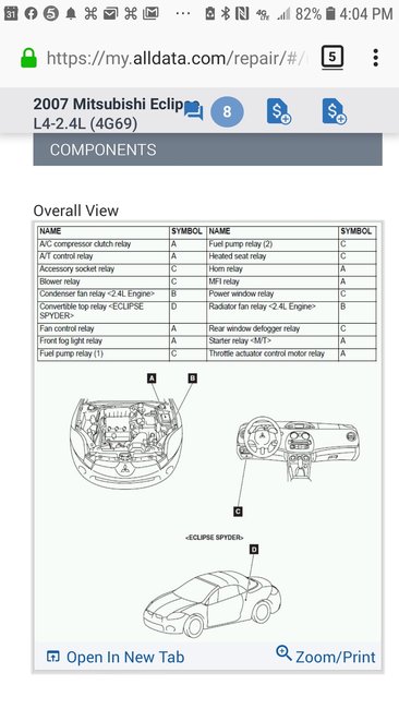

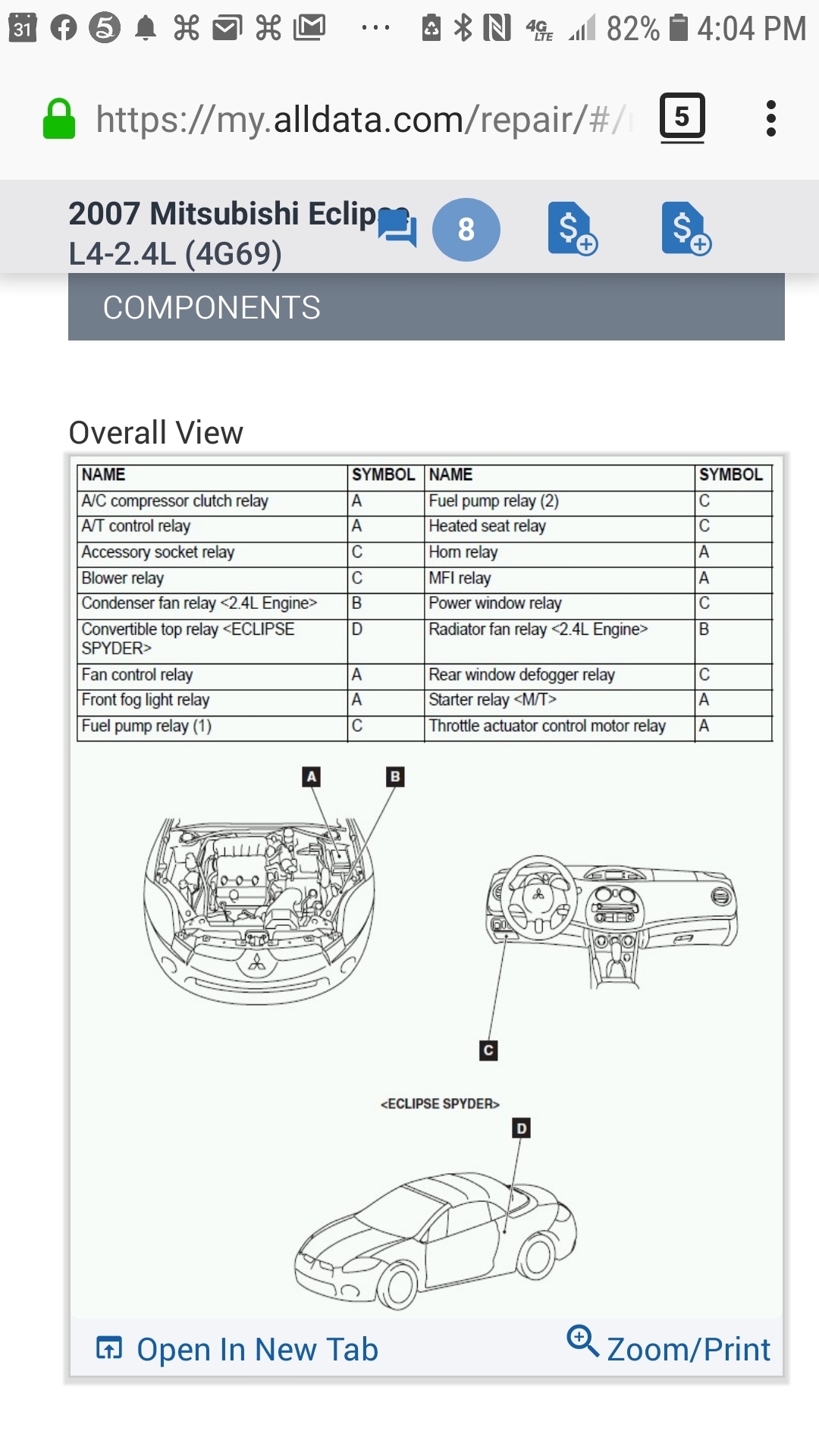

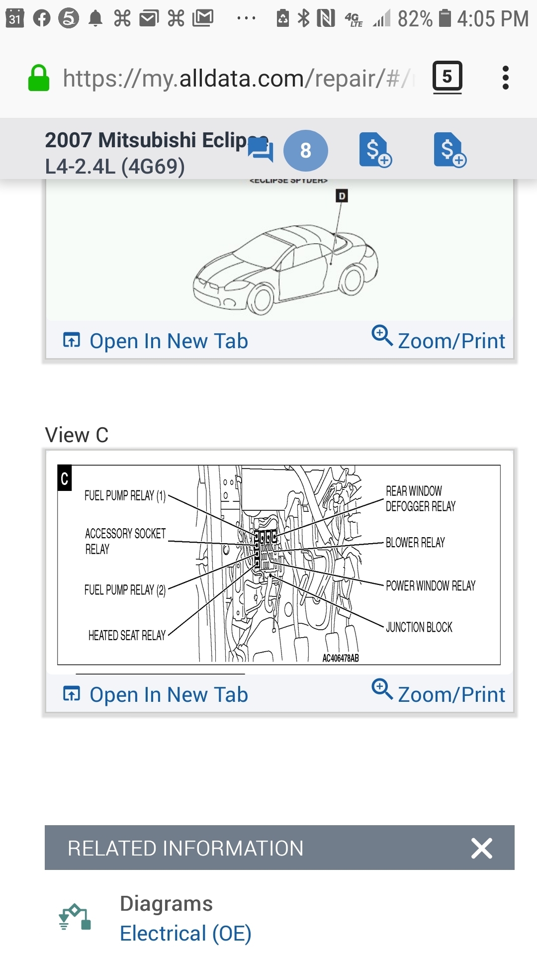

Need to locate the blower motor relay location in the car listed above. The manual just says relay but does not specify which one.

Hello! I'm attaching a couple of images that I just pulled from AllData. They should clarify things for you. Let me know if you need anything else.

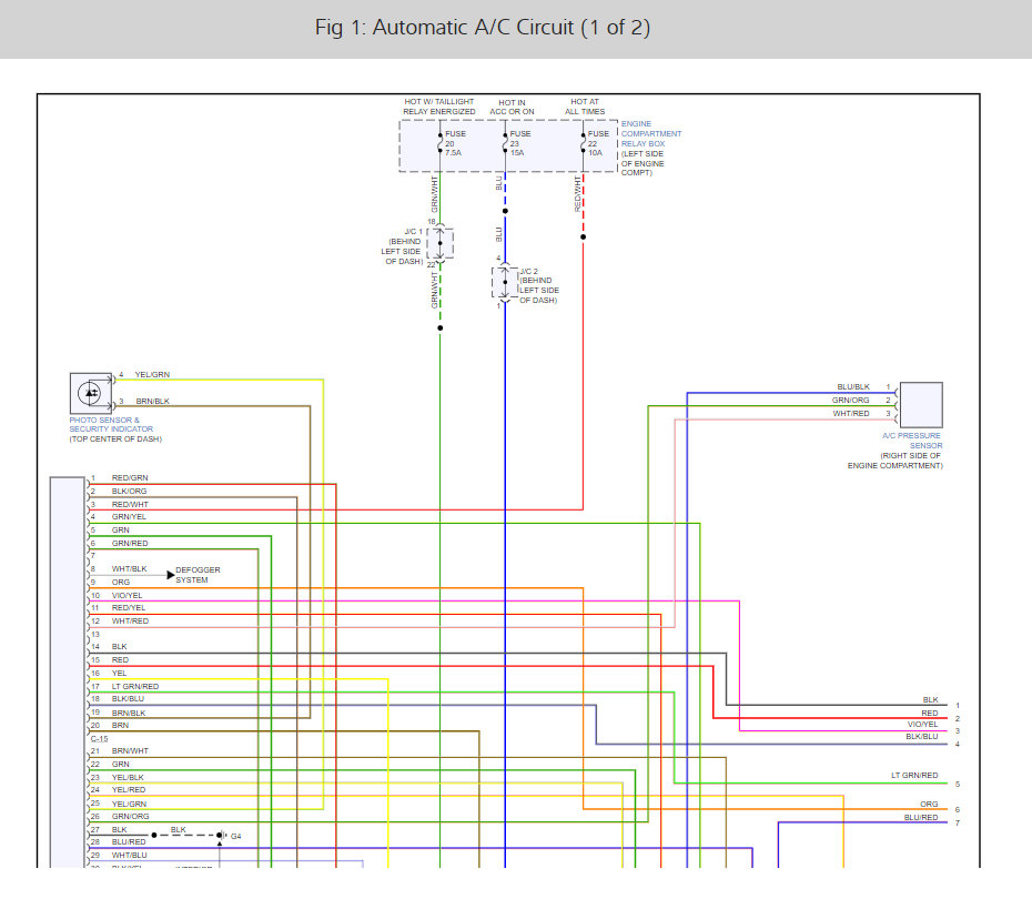

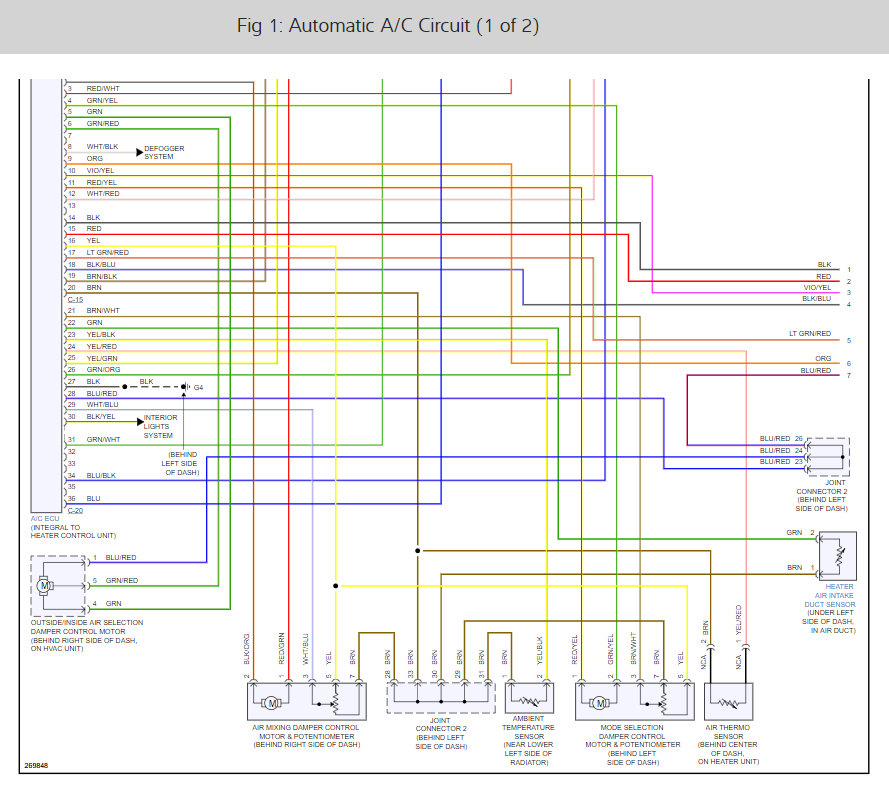

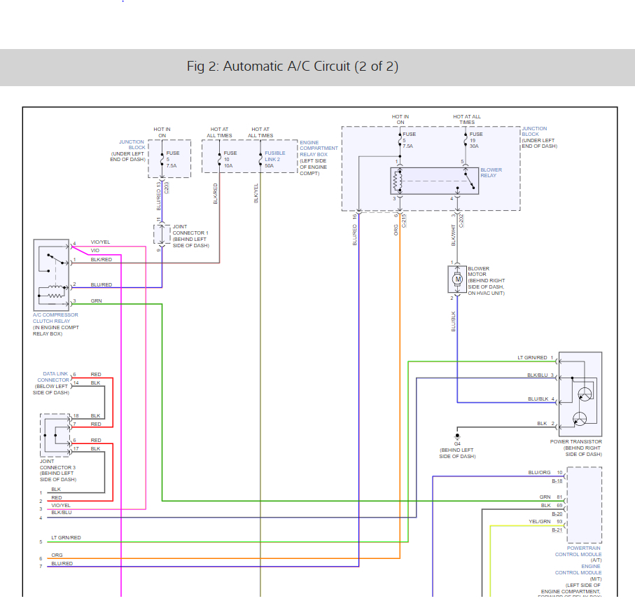

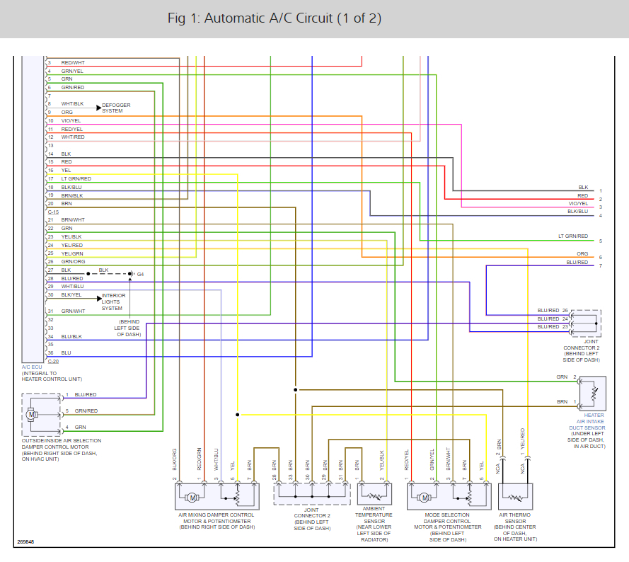

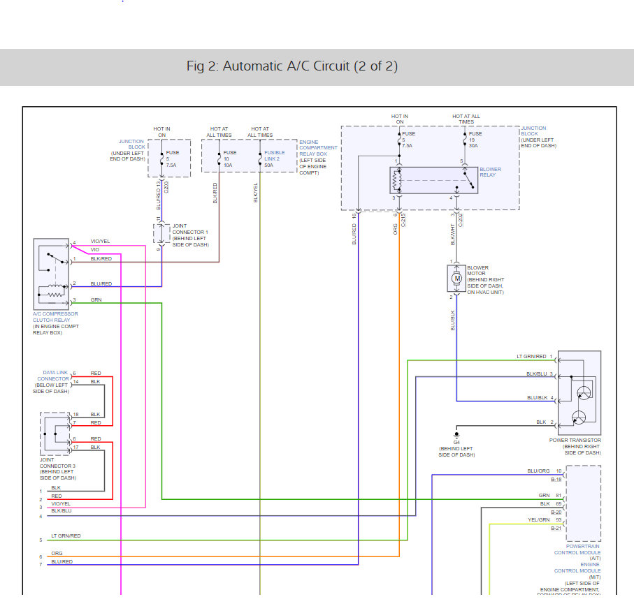

There is an A/C ECU that sounds like it is bad. To be sure we can do a CAN scan which is the future of automotive repair you can get a CAN scanner from Amazon for about $50.00. here is a video to show you how:
https://youtu.be/InIlnsjOVFA

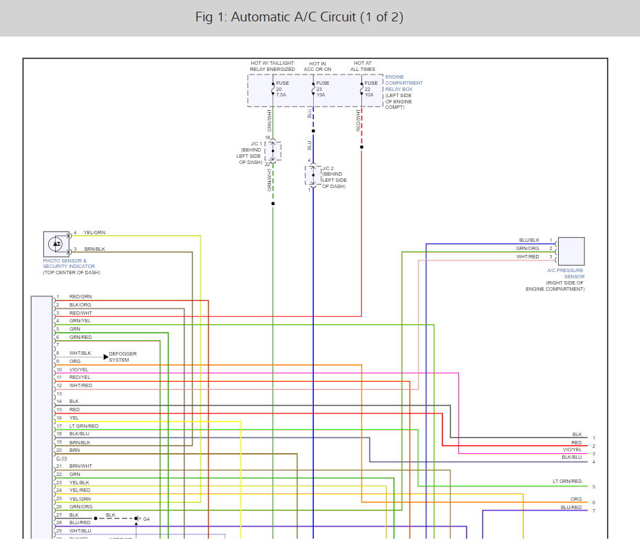

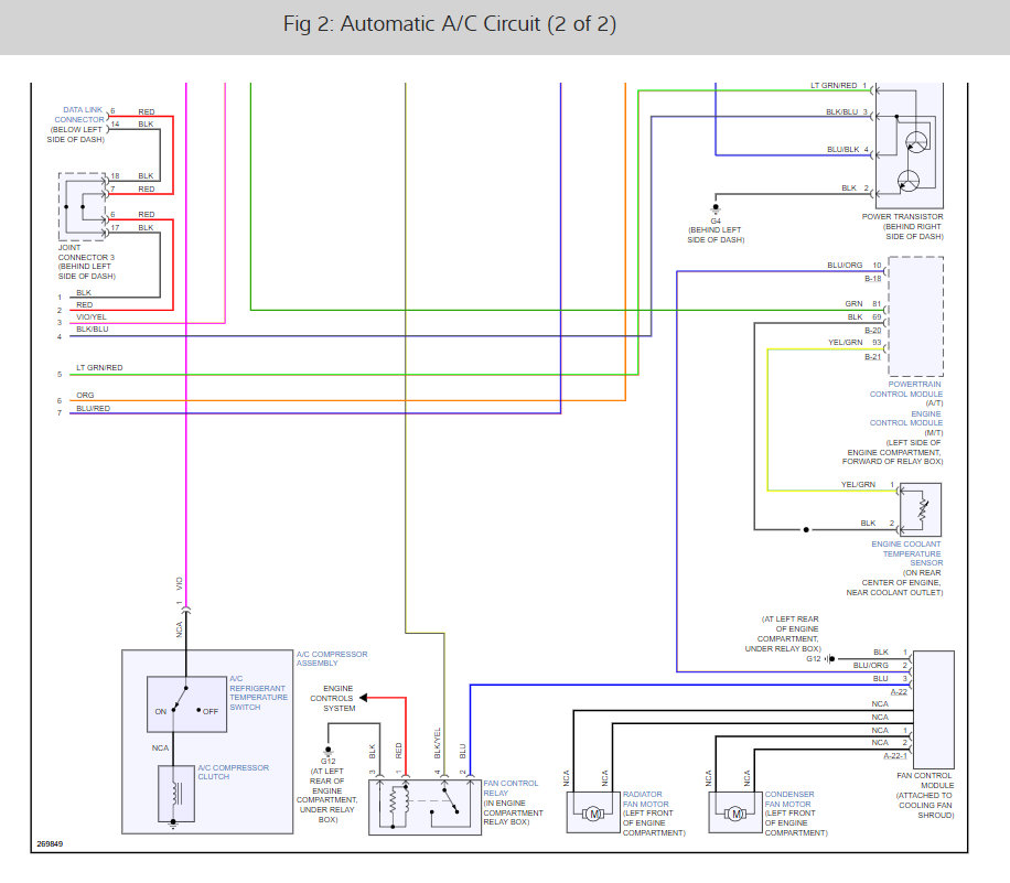

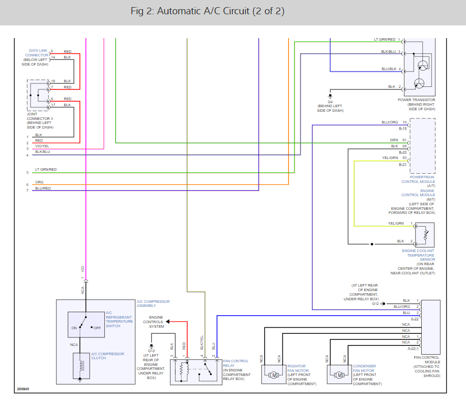

Also I have included the A/C and blower wiring so you can see how the system works. Check out the diagrams (below). Please let us know what you find. We are interested to see what it is.

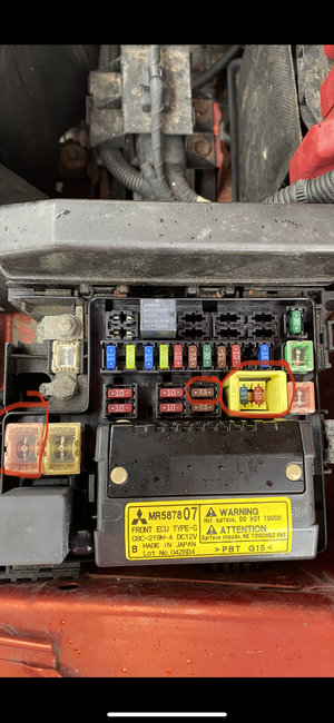

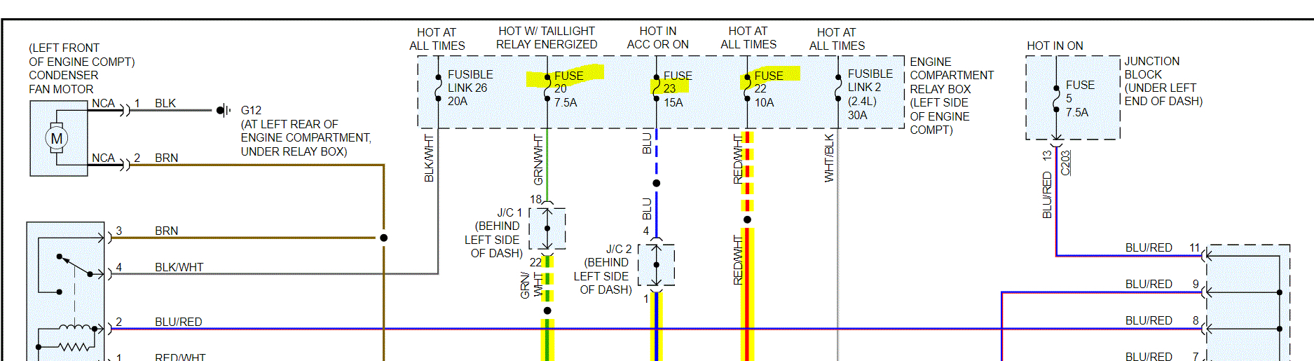

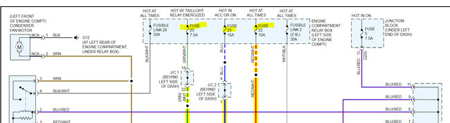

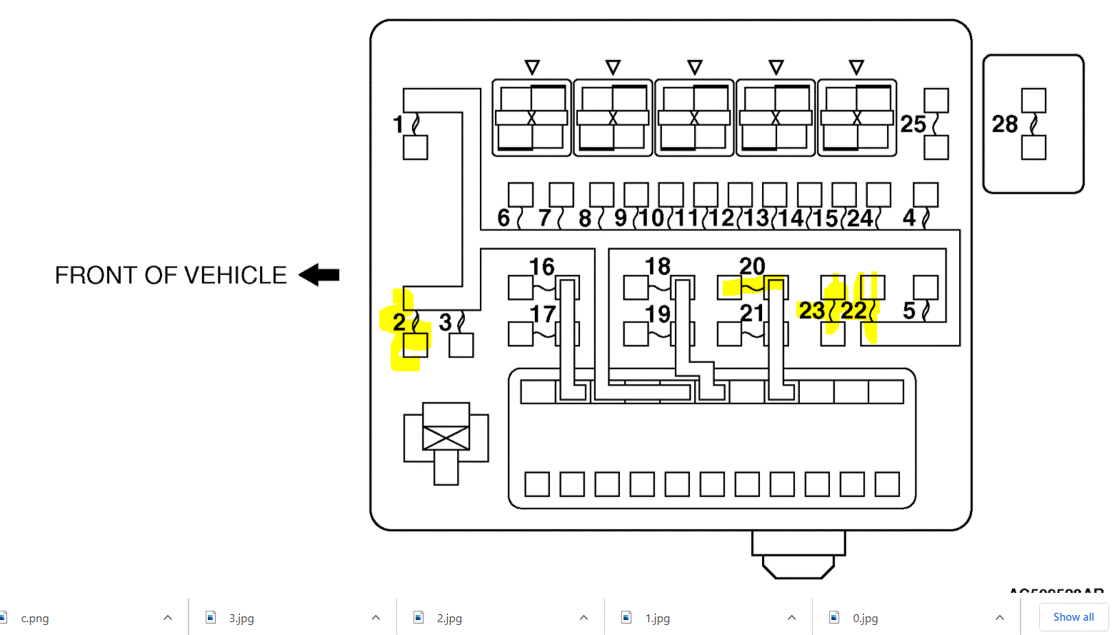

I need you to check the fuses under the hood. See that attached pics. Note that the 30 amp is a fusible link and not a traditional fuse. In addition to checking the fuse condition, make sure there is power to it as well as power out. Here is a link you may find helpful:

Included below is the fuse box. I seem to be misunderstanding which fuses to check I believe. The ones I circled are the ones I checked to see if blown, they are not. The yellow one i am not sure how to pull it off (if I have to) I will be testing power here soon but wanted to share this first. Please let me know if I’m off track.
Oct 18, 2020 at 11:36 AM
You are correct. There are two fuses in the yellow unit. You can pull one at a time.
