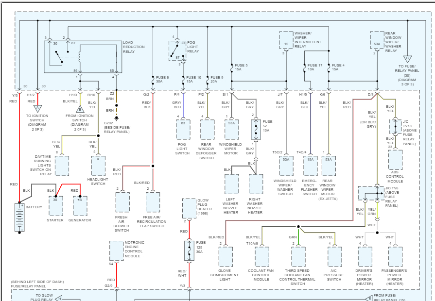

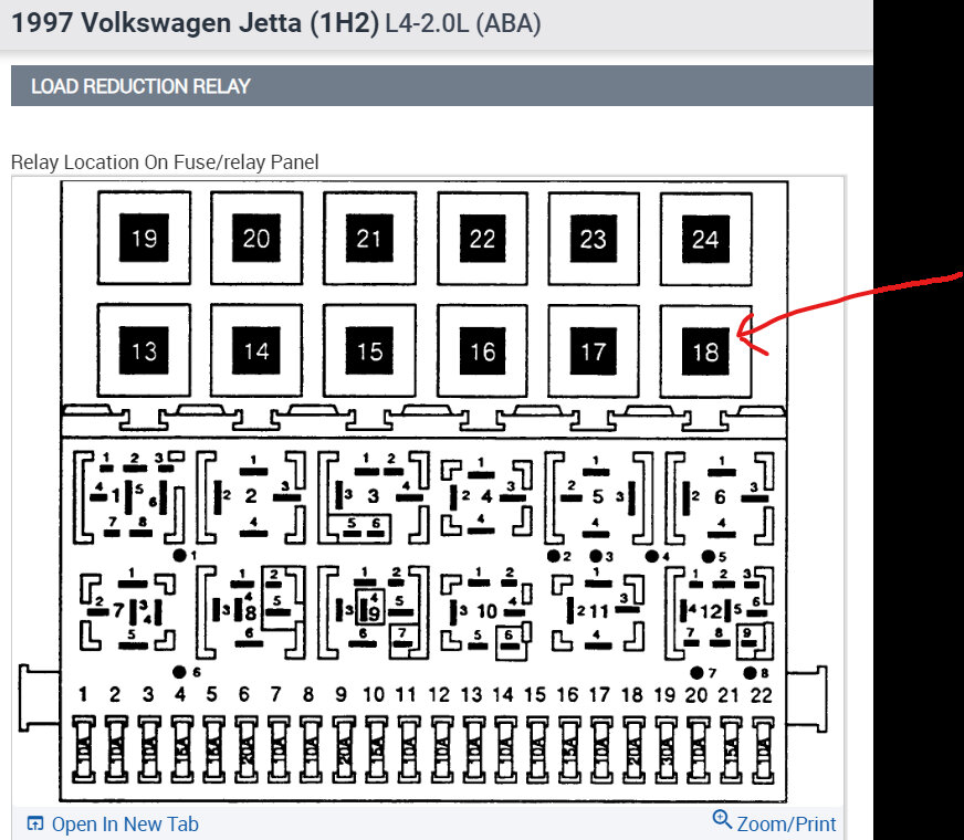

Recently replaced the blower motor and resistor in my car listed above and I am getting nothing from it. I’ve checked the #6 fuse for it and it’s not blown, but when I put a test light to the fuse there isn’t any power going to that fuse. all other fuses and relays are working except that #6 fuse. Is there a connector that is supposed to be plugged into the fuse block specifically for that or am I just missing something?
