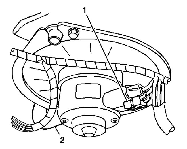

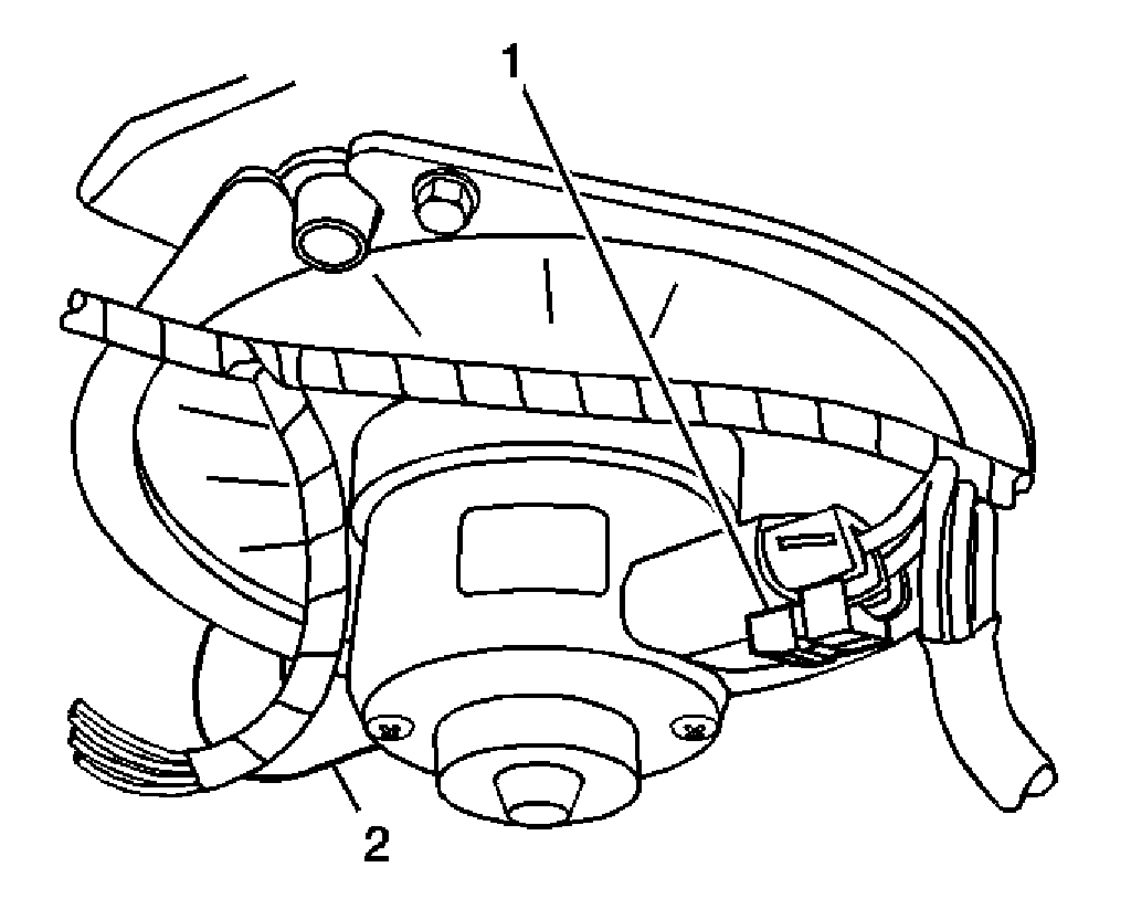

It's under the dash on the right side below the glove box. Here are the directions for removal and replacement. I'm adding them in case you need them. The attached pics correlate with the directions. Here is a guide to help you step by step with instructions in the diagrams below to show you how on your car.
https://www.2carpros.com/articles/blower-fan-motor-works-on-high-speed-only
BLOWER MOTOR REPLACEMENT
REMOVAL PROCEDURE
1. Remove the right side sound insulator.
2. Disconnect the electrical connector (1) from the blower motor.
3. Disconnect the blower ventilation tube (2) from the module.

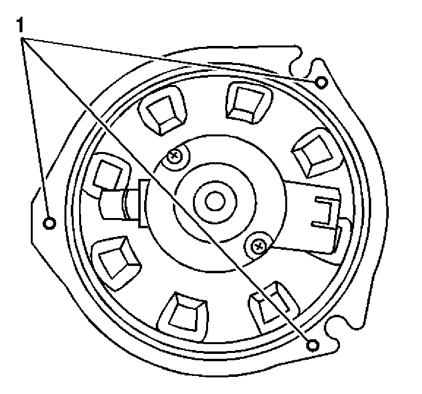

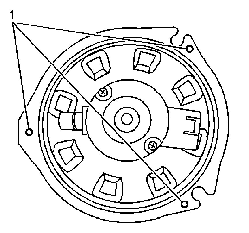

4. Remove the blower motor screws (1).
5. Remove the blower motor from the housing.

2. Install the blower motor screws (1).
Tighten
Tighten the screws to 1.7 N.m (15 lb in).
