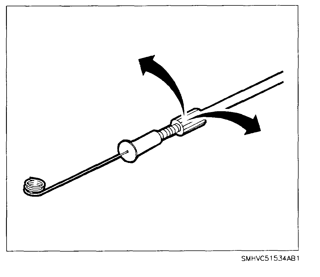

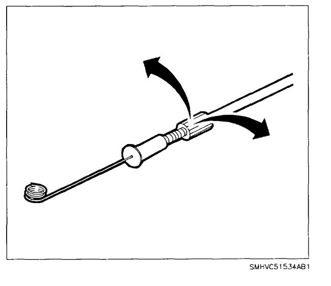

If the fan is running at proper speed and you can control its speed, the resister is not bad. Most times, a bad resister will allow the fan to only operate on high. Since there is reduced air flow, my first suspect is the mode/temperature cable needs adjusted. If the mode doors are not opening properly, it could reduce air flow.
Here are the directions specific to your vehicle for adjusting the cable. Pictures 1 and 2 correlate with these directions.
________________________________________
MODE AND TEMPERATURE CABLE ADJUSTMENT (SERVICE CABLES) - (LHD VEHICLES ONLY)
IMPORTANT: Adjust cables by holding cable housing and turning cable housing end.
Mode Lever
^ If mode knob bounces back on defrost (right) side, shorten cable housing.
^ If mode knob bounces back on I/P outlet (left) side, lengthen cable housing.
Temperature Cable
^ If temperature knob bounces back on hot (right) side, lengthen cable housing.
^ If temperature knob bounces back on cold (left) side, shorten cable housing.
