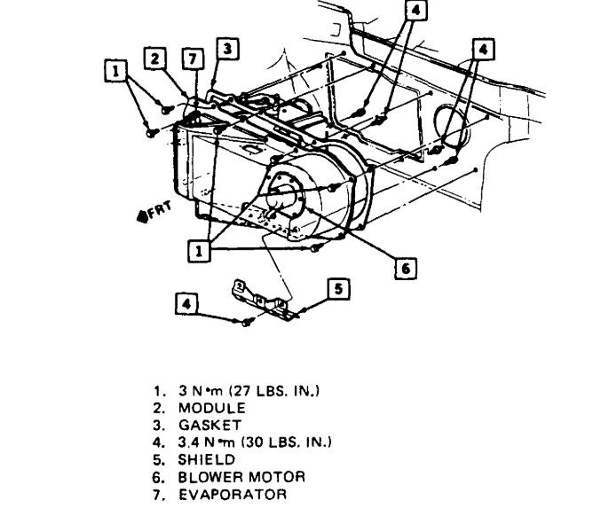

Heat and A/C will not blow, but some times I can try it and it will come on for a minute or so then fade out to nothing.

Two common issues.
1. Blower motor. It may or may not work. Check the connector at the motor.
2. Blower resistor. It is right next to the blower motor and is a common failure.
