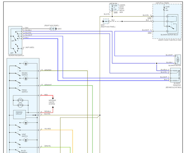

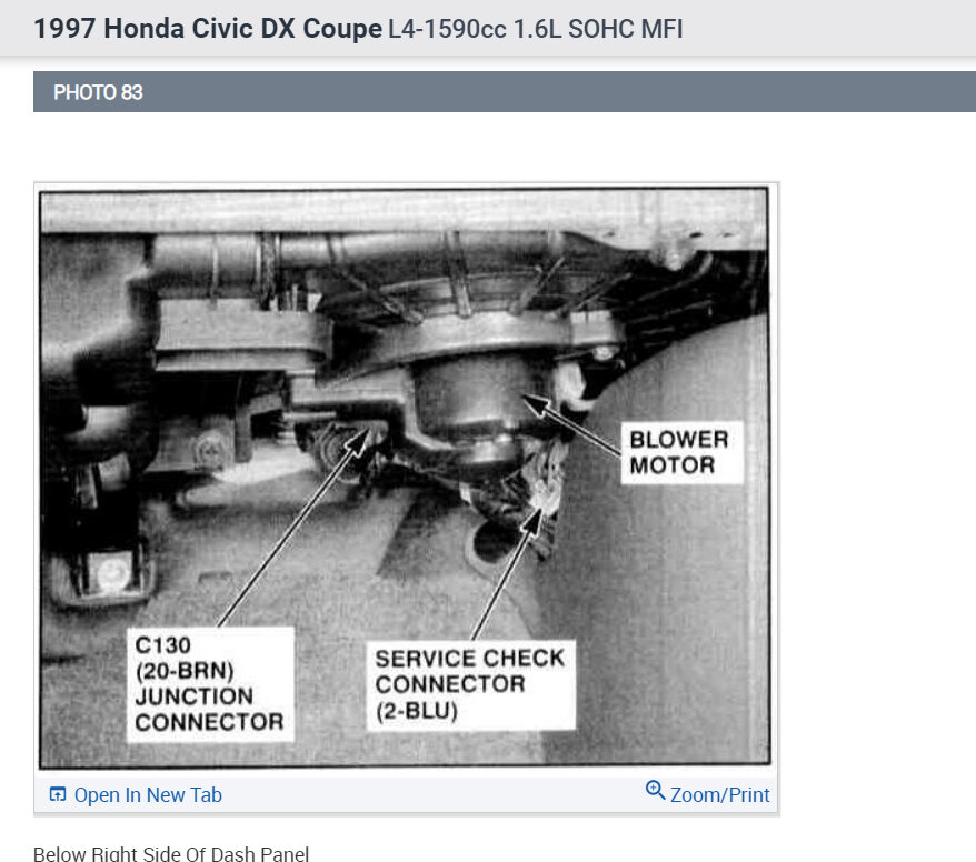

It sounds like the blower motor has gone out, but we should check the fuse #55 in the fuse panel under the hood. Here are two guides to help us fix the problem and I have instructions on how to change the blower motor out int he images below in case you need them.
This guide can show you how to check for power and ground for the blower motor:
https://www.2carpros.com/articles/blower-fan-motor-works-on-high-speed-only
This guide can show you how to check the fuse:

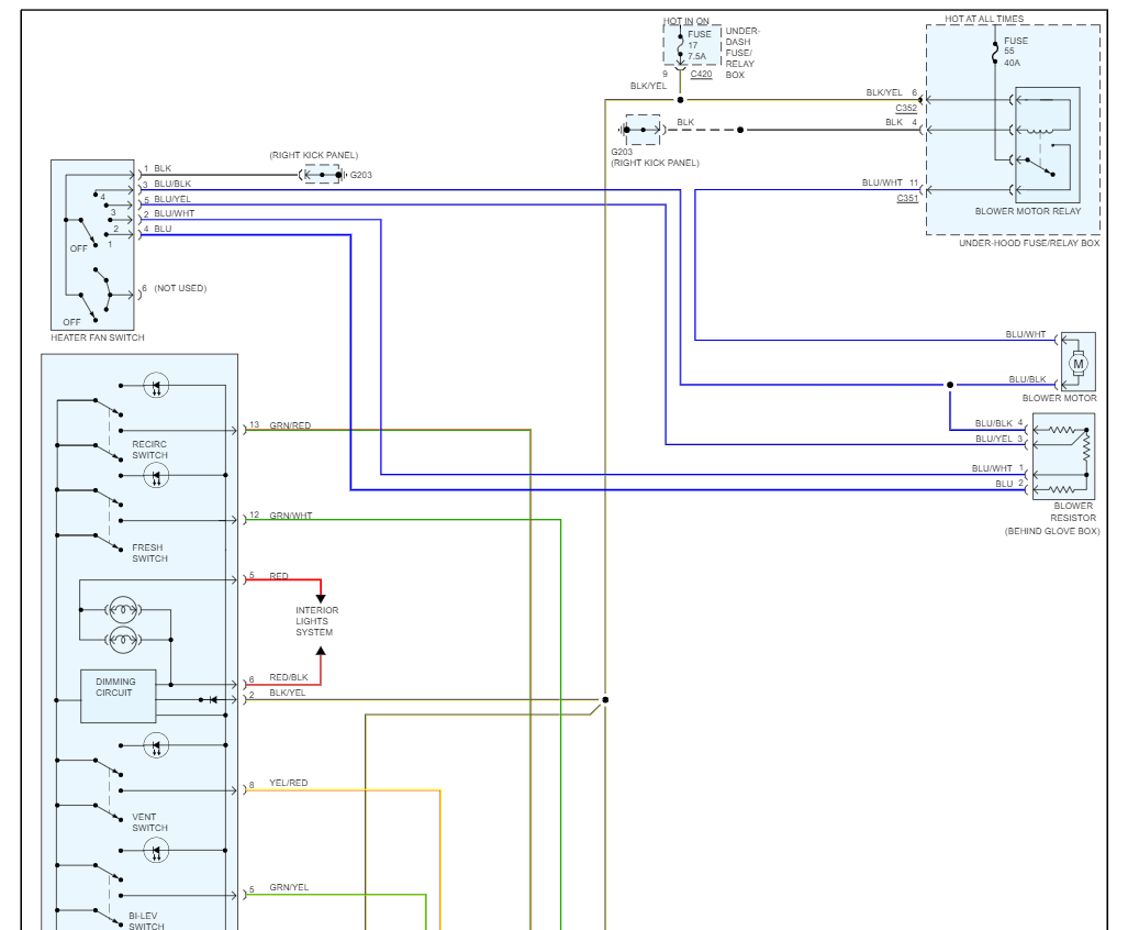

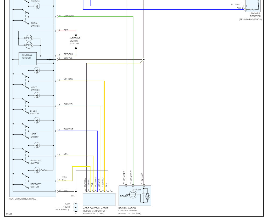

Here are the blower wiring diagrams so you can see how the system works. Check out the images (below). Please let us know what happens.
