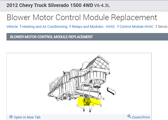

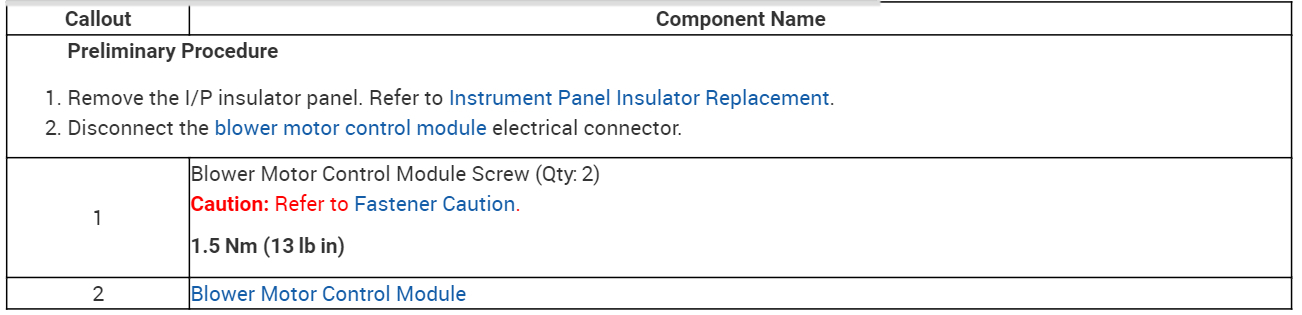

Then we don't have a short to a different circuit. I suspect either the connector at the blower motor control module is damaged or the module itself is bad.
If you look below, I attached the directions for the removal and replacement of the module. What to do is first disconnect it and inspect the connector. If it appears okay, then suspect the module.
Let me know what you find,

I have ordered a new module, I will let you know the outcome after I get it. Everything started going wacky after I replaced it. I have checked the connectors several times. So. I may have just got a bad module. Thank you. I will keep you apprised.

Okay, module replaced and everything works. Thank you for all your help. I was about to pull the last of what little hair I have left out.
