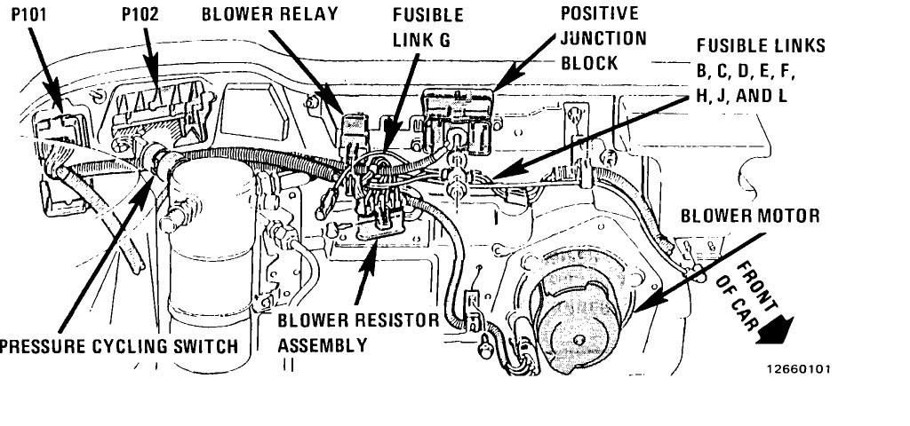

The blower motor speed resistor is out that's what they do when the go bad, here is a diagram of its location (below) so you can get the problem fixed.
