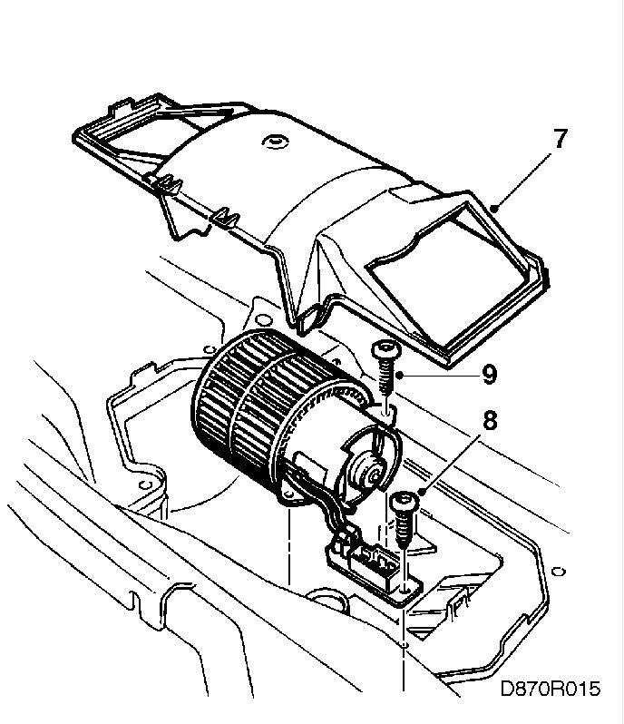

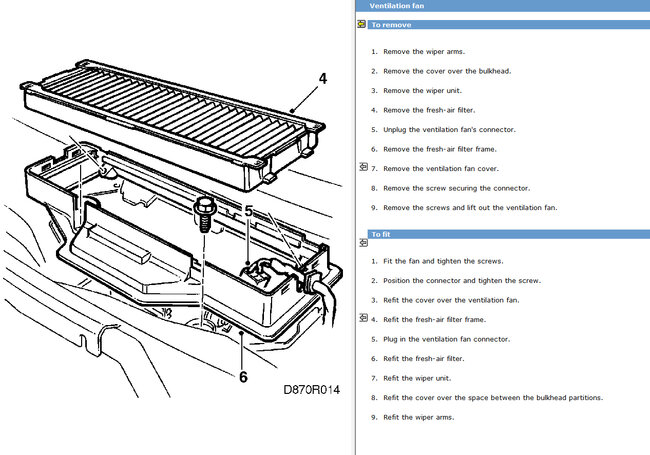

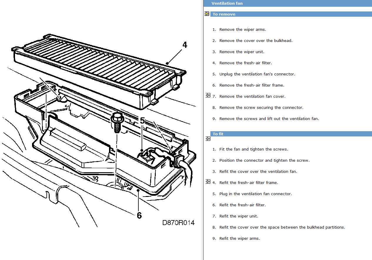

The blower motor can be accessed by removing the wiper arms and wiper motor, see illustration below.
BLOWER MOTOR
Removal
Blower motor is located in the engine compartment, behind the center of the bulkhead partition. Remove wiper arms. Remove cover over bulkhead.
Remove wiper unit. Remove fresh-air filter. Unplug blower motor connector. Remove fresh-air filter frame.
Remove blower motor cover. Remove screw securing blower motor resistor connector. Remove blower motor mounting screws, and lift out blower motor and fan unit.
Installation
To install, reverse removal procedure. Ensure electrical wires are not pinched.
BLOWER MOTOR RESISTOR
Removal & Installation
Remove wiper arms. Remove cover over bulkhead. Remove wiper unit. Remove fresh-air filter. Unplug blower motor connector. Remove fresh-air filter frame. Remove blower motor cover. Remove screw securing blower motor connector. Unplug and remove blower motor resistor. To install, reverse removal procedure. Ensure electrical wires are not pinched.
Hope this helps.
