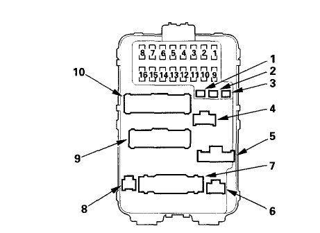

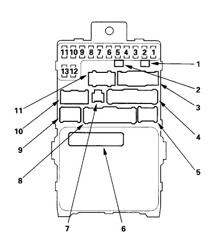

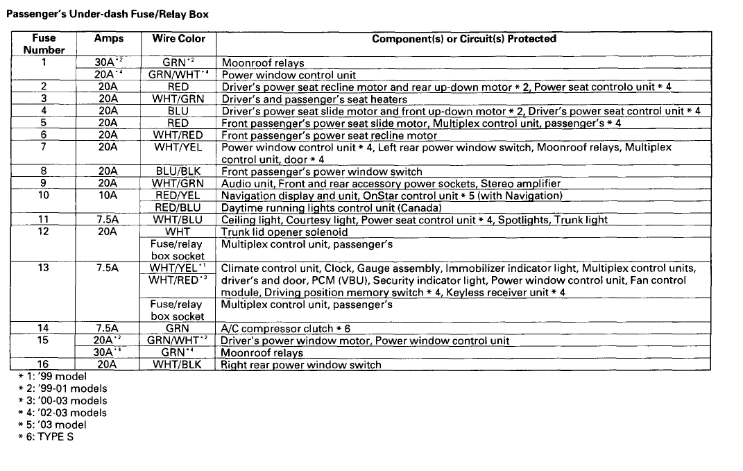

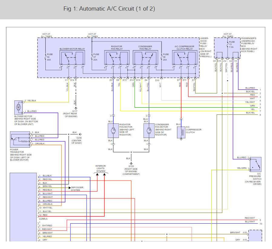

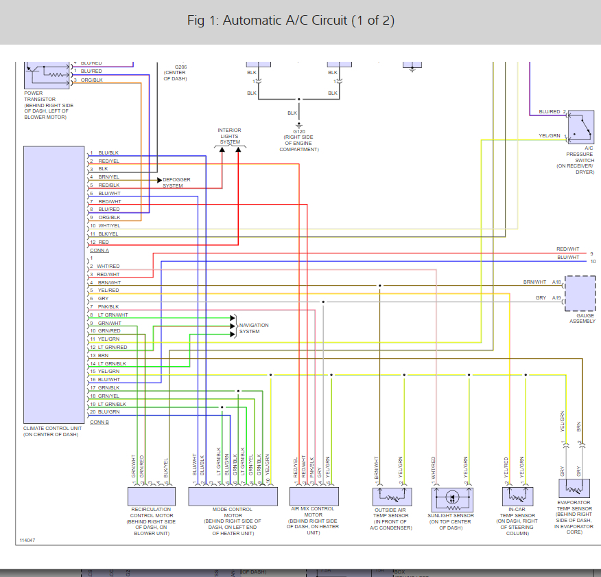

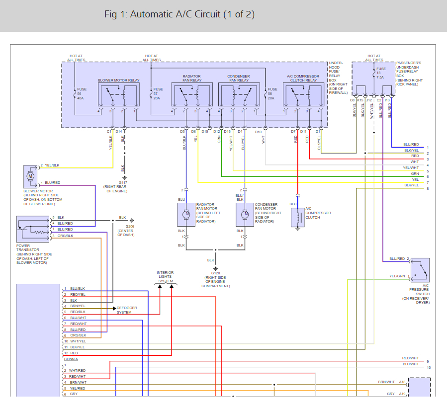

Even though the relay clicks it can still be bad. Here is a guide and the wiring diagrams to help you confirm the problem and see how the system works:

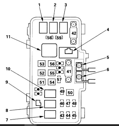

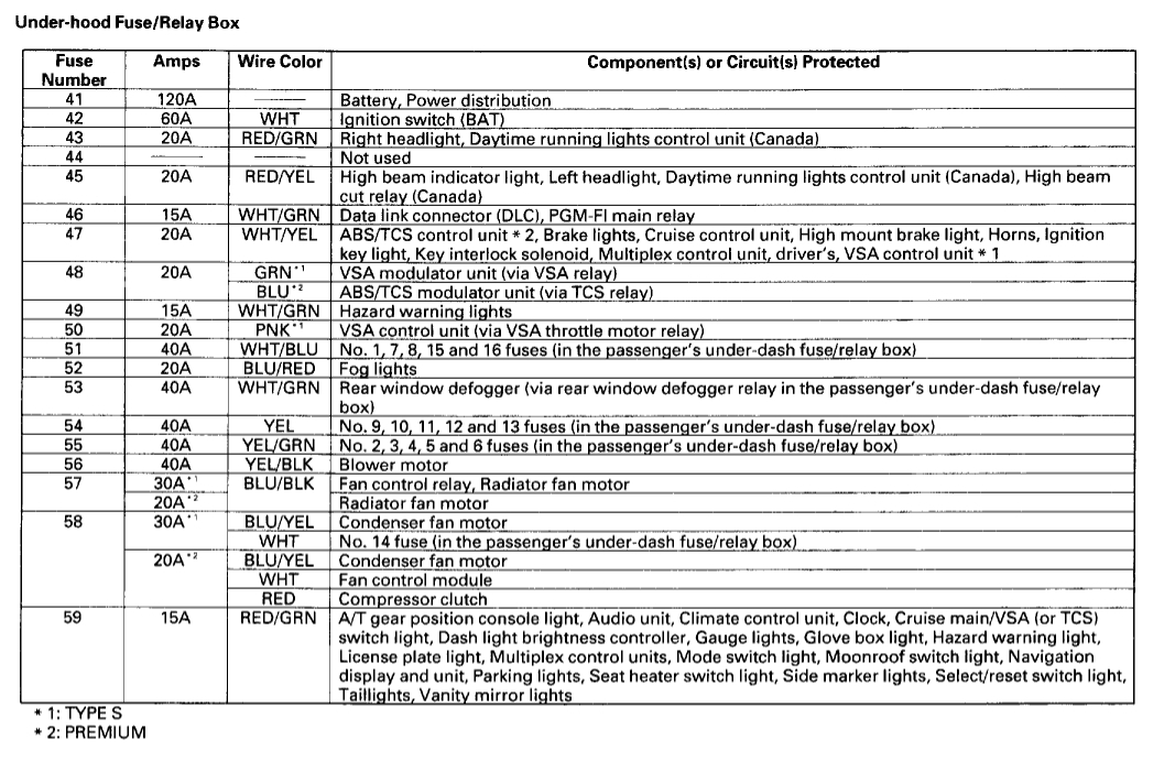

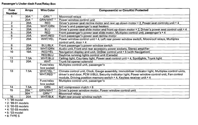

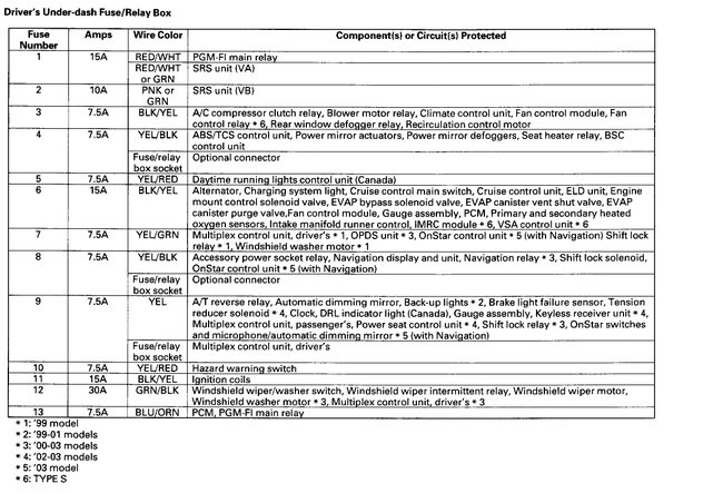

Also check the #56 fuse 40 amp. Check out the diagrams (below). Please let us know what happens.
