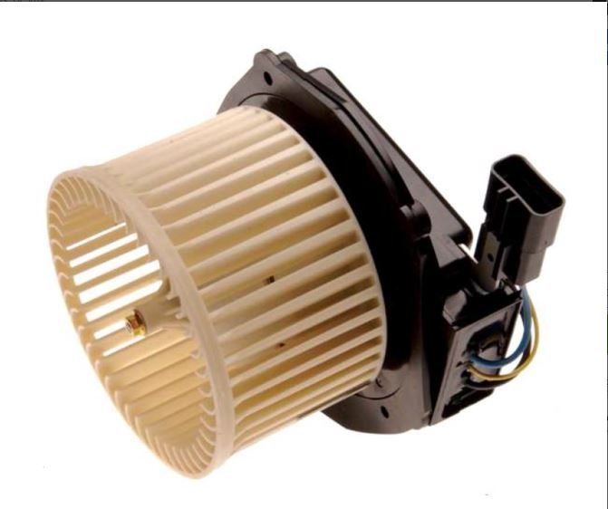

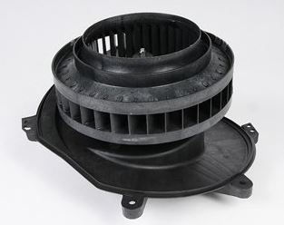

The OEM number for that car is GM #52494108 and should look like the first image. Fits 1994-1999 DeVilles. However if you have a really late 1999 version it could have the newer design in it which is the second image. Do either look correct? Is yours under the hood or under the dash? The engine bay units were 1999, the newer system has the blower under the dash.

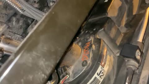

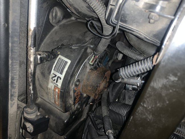

STEVE W.
  • 15,113 POSTS
Have you replaced the blower before? The orange writing is typical of salvage yard parts. I ask because that looks like the wrong motor was installed. If you look at the outline on the housing you can see that the original mount flange was shaped differently. These are a mess to get out because of the lack of room which is probably why that one is not the OE. The replacement motors available now are a different design then the OE motor which isn't what you have currently either. However they work much better.

MROULET1
  • 79 POSTS
I got the car used. That blower motor was already in. If you could see the connector that’s going into that metal plate coming off of the firewall that connector does not fit any of the blower motors that was recommended for my vehicle. Also the connector that runs off the back of the blower motor there’s a two prong and what it connects to it it’s a wiring harness this part of the vehicle.

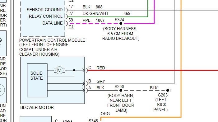

Sounds like someone adapted a different motor and wiring to fit it. The factory wiring has three pins in it, one ground (black) one full time power (red) and the gray wire which is the blower speed control signal from the interior panel. The motor speed is a pulsed signal that tells the motors onboard controller how fast to run. The replacement motors should have a short wiring harness with a plug that fits the original wiring.

I am sorry I gave you false information.. you see the metal plate that has the connector? Well it’s 2 connector on that metal plate one at the bottom that the motor plugs into not the wiring harness and the one at the top that you can see with the wire coming off the firewall..
Apr 16, 2021 at 6:39 AM
STEVE W.
  • 15,113 POSTS
Sounds like you have the correct wiring then, just need to fight the new motor in. I have seen people cut the housing as well, some cars were even marked that way. You cut out the top of the housing, changed the motor and then added a new piece over the hole. Moving the engine actually takes less time though.
