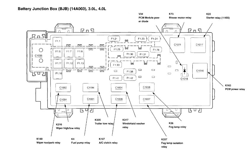

Below the diagram for the relay location. Check out the diagrams (Below). Please let us know if you need anything else to get the problem fixed. Roy

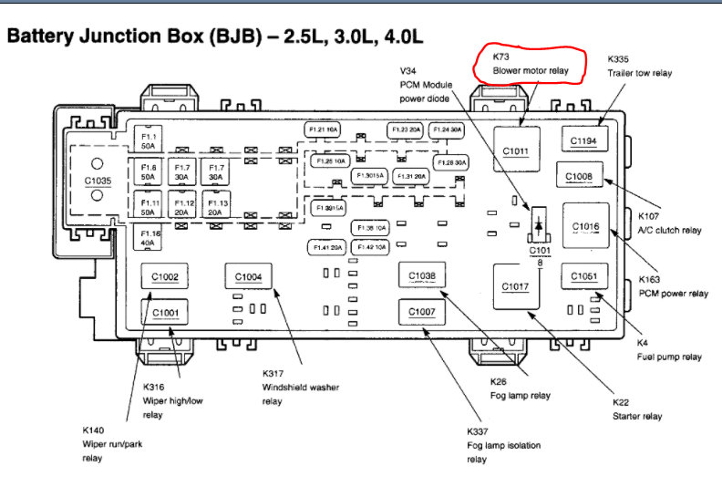

The blower motor relay is located in the under hood battery junction box. Here is a tutorial showing how to test a relay:
I've attached a picture below of the junction box showing the blower motor relay location and circled in red for your truck. Hope this helps and thanks for using 2CarPros.

THe blower relay is under the hood here is a guide to hell check it with the location in the diagrams below.
