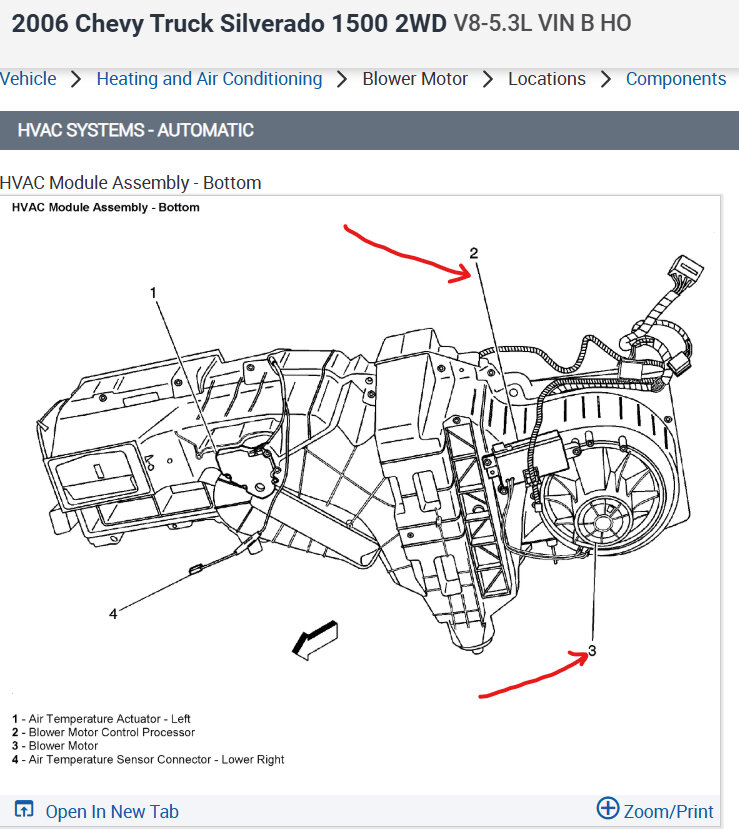

It sounds like the blower motor control processor is going out. I would replace the blower motor as well because as the motor starts going out it pulls more amps and takes out the blower motor control processor. Here are the locations so you can swap them out which should fix the problem. Check out the images (below). Let us know how it goes.
