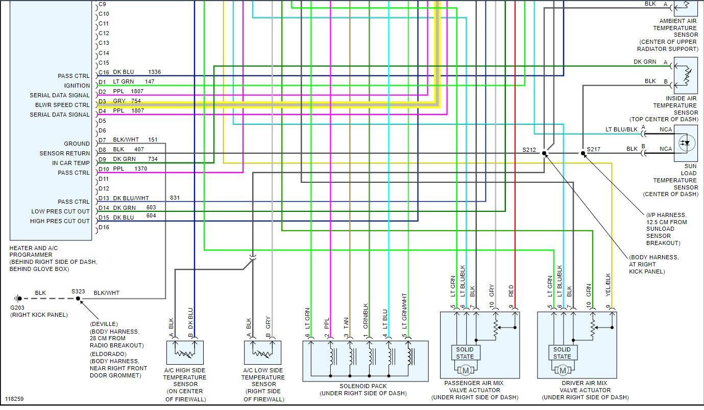

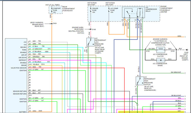

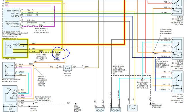

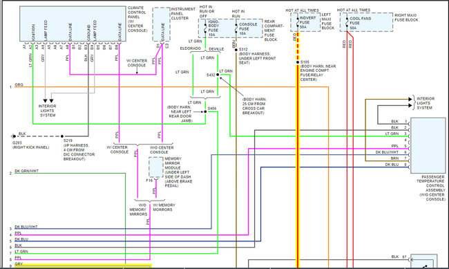

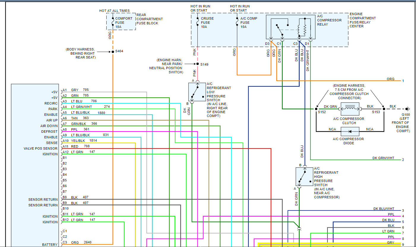

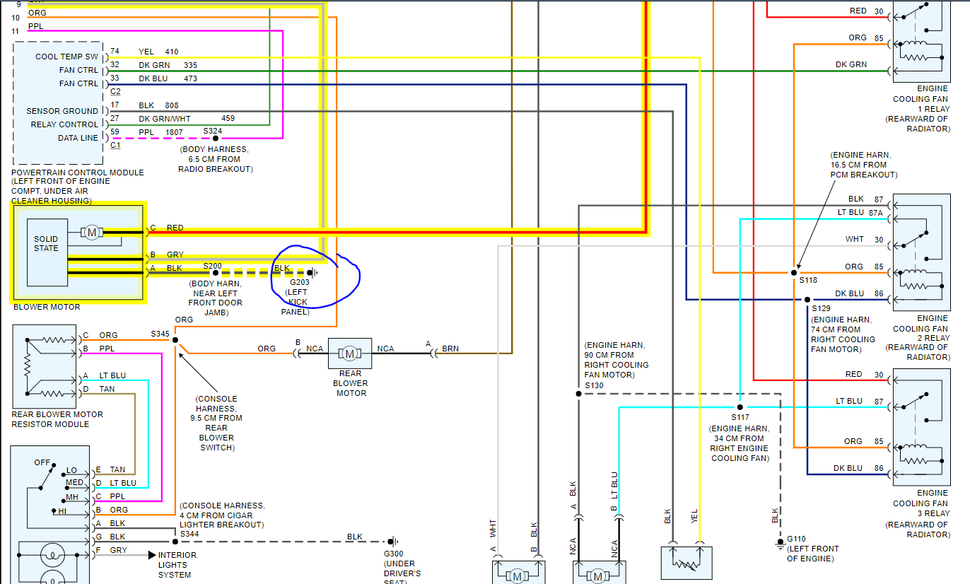

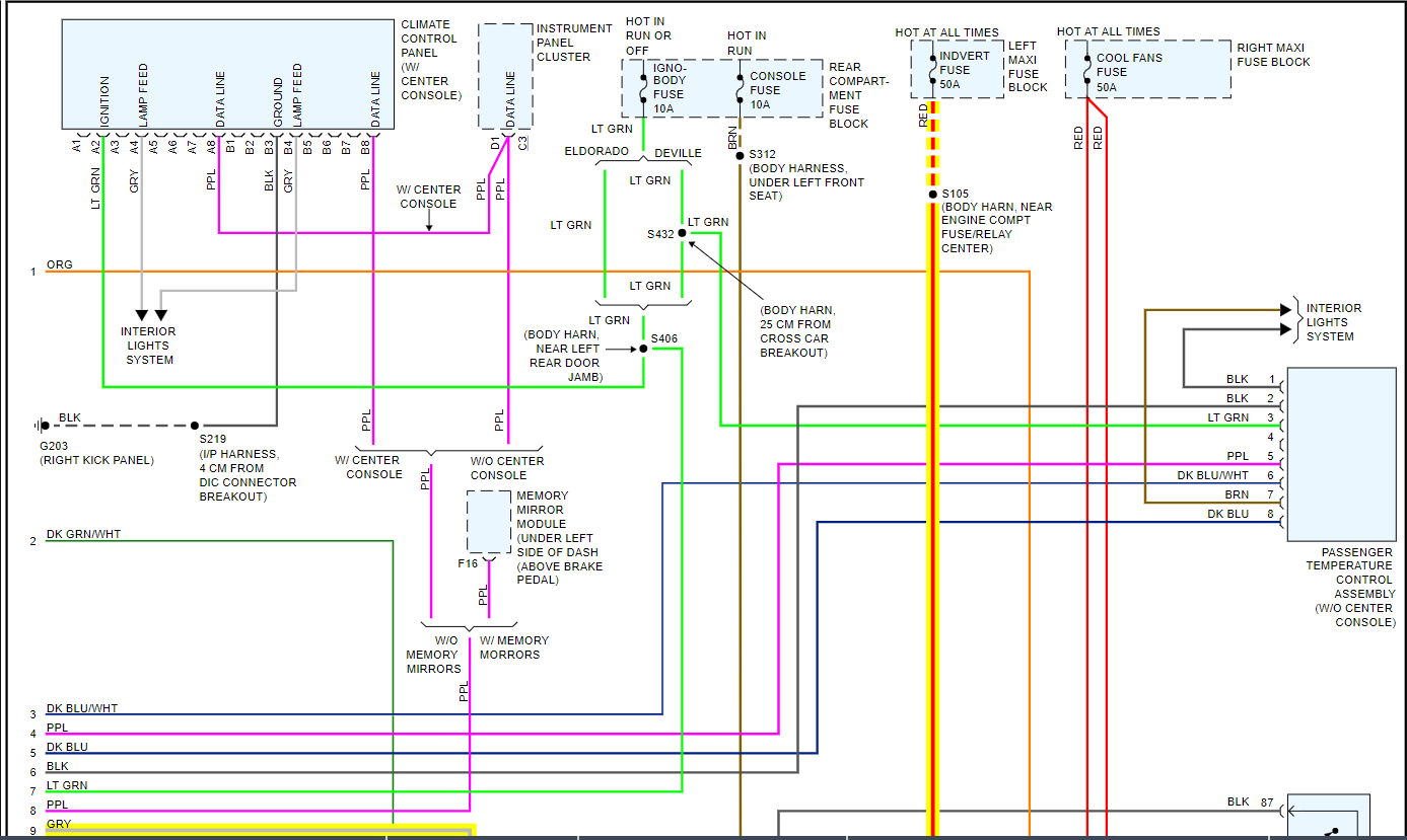

I attached the wiring diagram of the system for you. You need to do some voltage checks at the blower motor to be sure the connection is good as well as the voltage.
In the left front of the passenger compartment, behind the kick panel

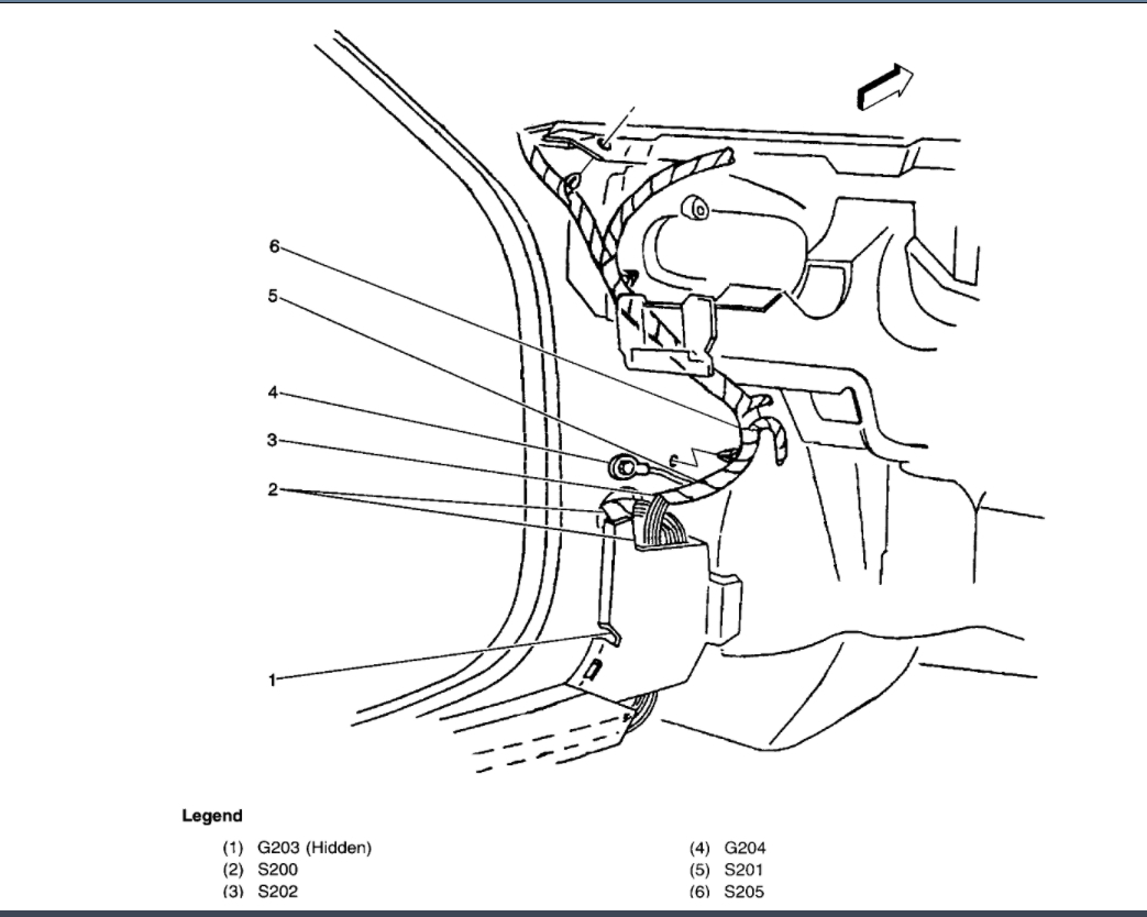

I would also check the ground connection. I attached a picture of the location for you. It is G203.
