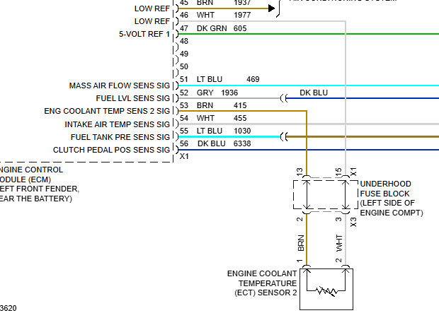

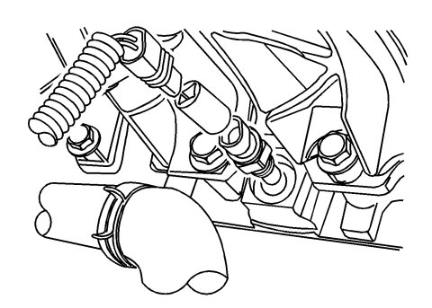

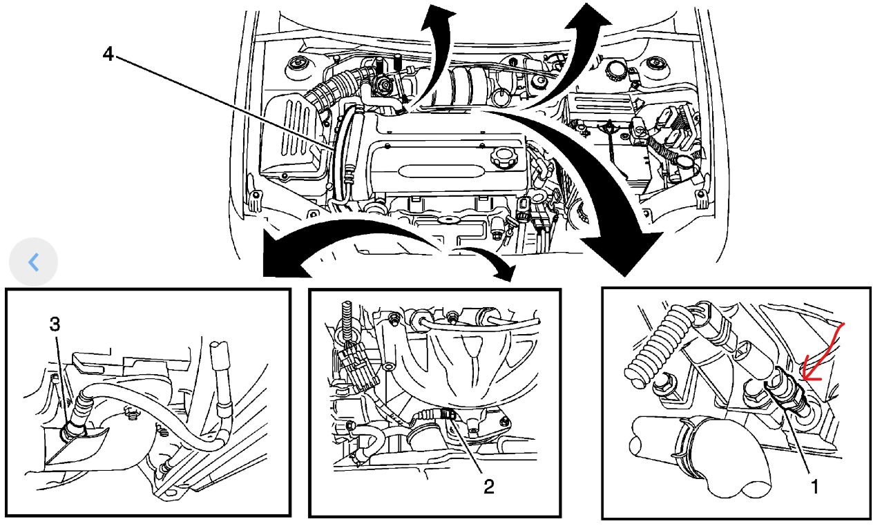

My temperature gauge quit working, at the same time the a/c quit working, i assumed that it was the temperature sensor, i went to the part store to get a sensor, and found out there were three sensors for this car, they said the one that controls the gauge is in the block, but i couldn't find it. The only videos i could find said it was under the intake on the back side of the block. i have been all over this thing but i can't find it. Please help!
