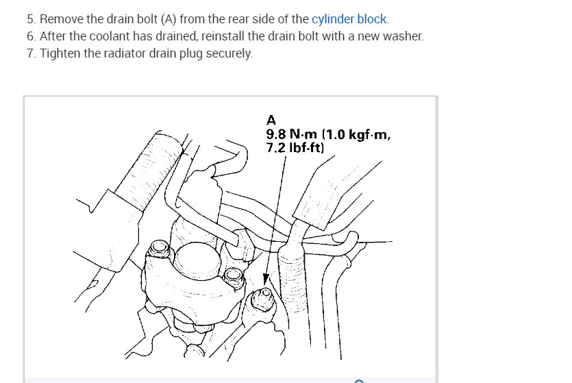

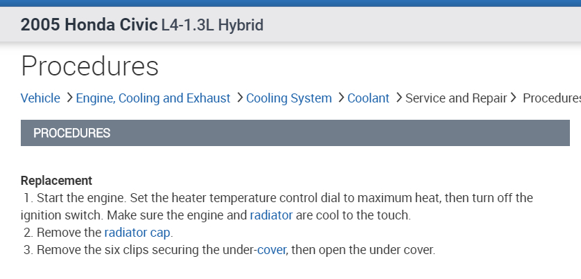

Coolant exchanger only draws out less than half capacity. Where is the block drain plug located in order to get the rest of the coolant out? Have distilled water in block after flush. I have 50/50 mix and can't dilute it more so have to drain the block first I guess.
