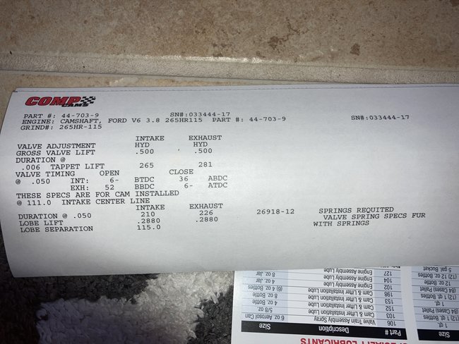

It’s a comp cam and yes I have the card.

Cam card.
Sep 20, 2020 at 11:06 AM
Lift @.500 you should not have a problem with valve stem seal clearance issues.

I'm having a hard time finding info for you. What brand of timing chain are you going to install? I contacted Comp Cams and they mentioned on your grind cam you will just install straight up and no need to advance or retard the cam upon installation due it having 4 degrees of advance built into it. Let me know about the timing chain and we'll go from there. Hope this helps and thanks again for using 2CarPros.
