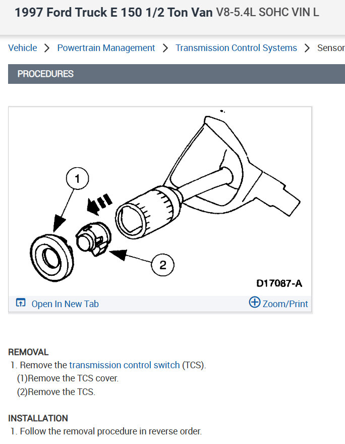

Here is how to change the switch out which should fix it. Check out the images (below). Please let us know what happens.
