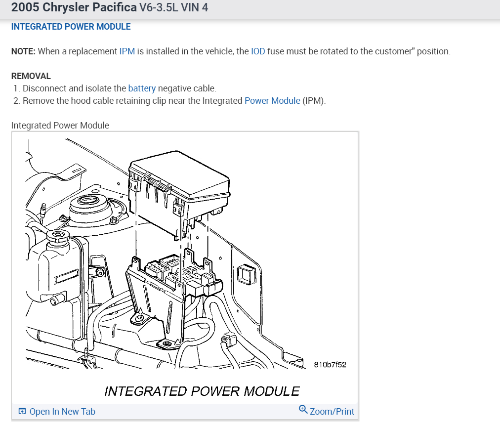

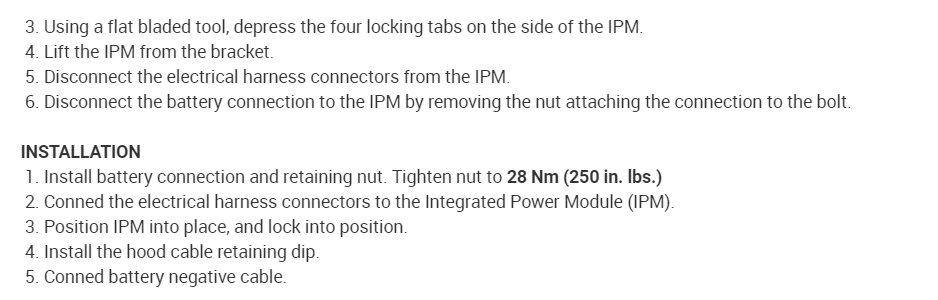

Yep, the integrated power module goes out all the time in these vehicles, to be sure we should do a CAN scan which is easy. You can get a CAN scanner (Controller Area Network) which will work on most cars from Amazon.
here is a video to show you how:
https://youtu.be/u-4syLc-ifQ
Here is the location of the IPM and how to change it out in case you need it. Check out the images (below). Please let us know how it goes.
