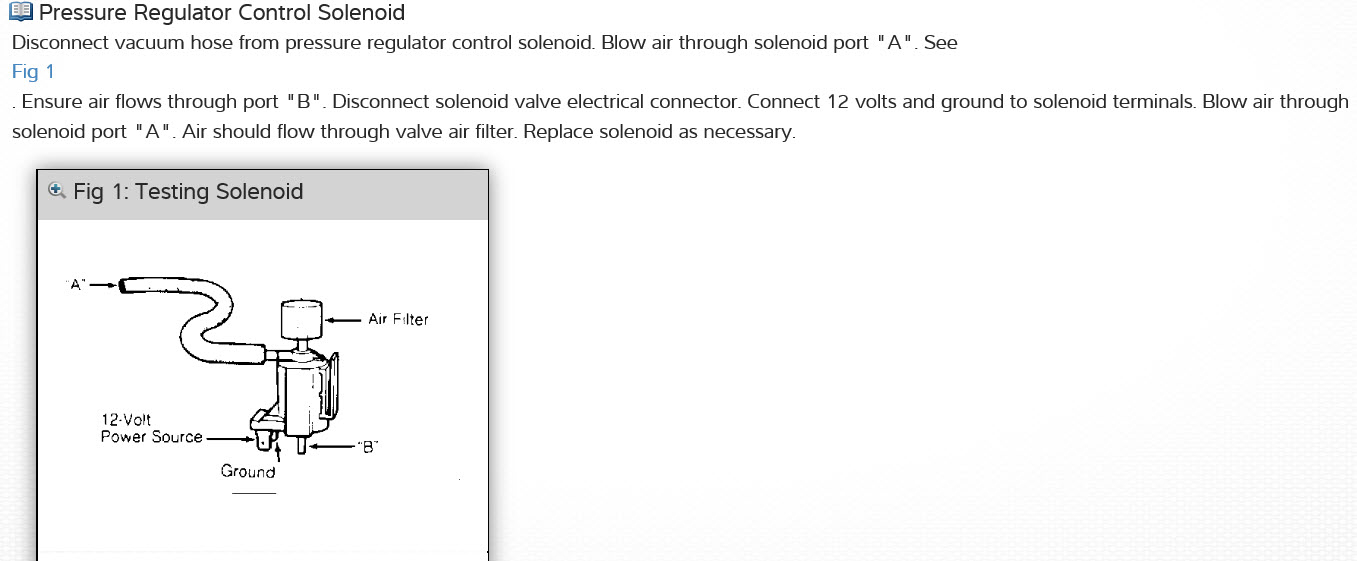

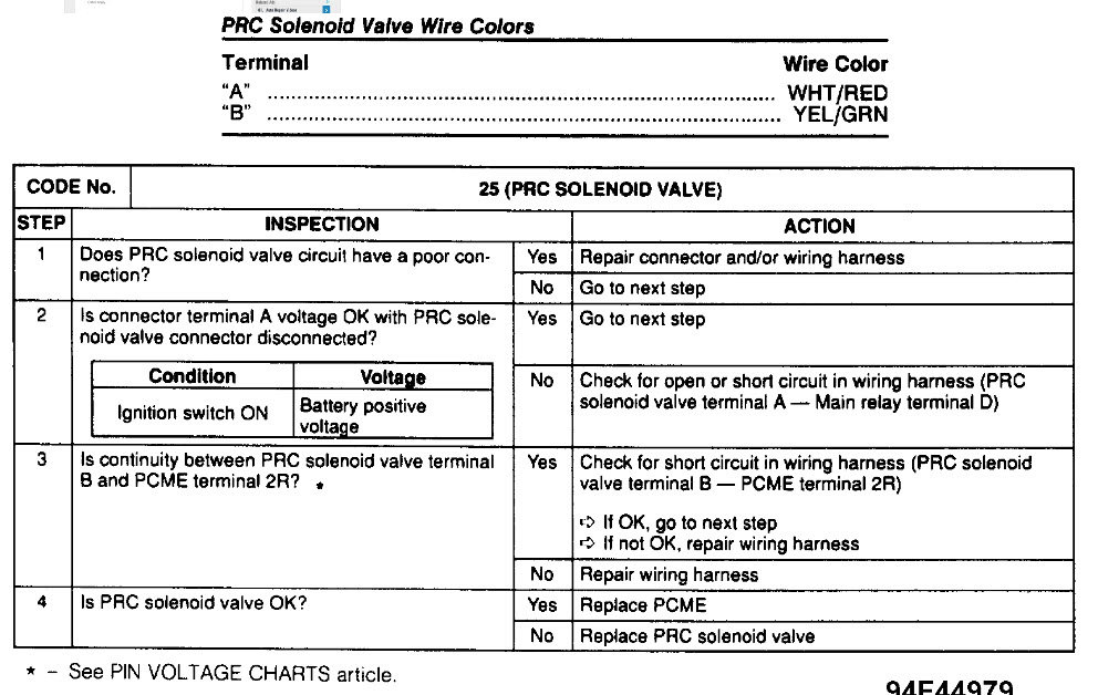

dash light blinks five (5) times, hesitates and then blinks two (2) more times. Can't find info on that particular code.
Apr 6, 2016 at 11:11 PM
HMAC300
CERTIFIED EXPERT
48,601 POSTS

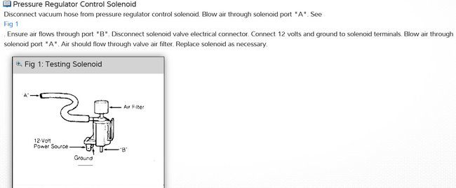

see pics the code is probably 25 and not 52
