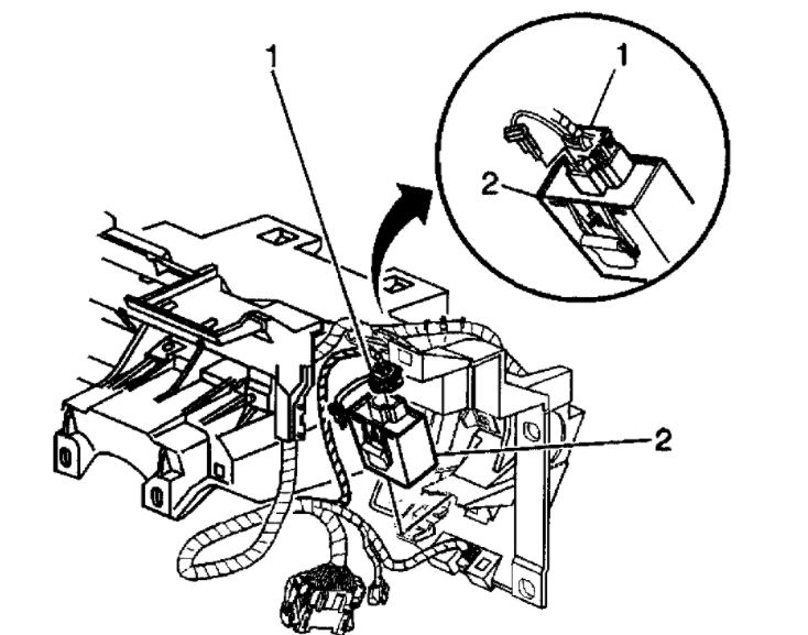

The flasher is a combo flasher for both the turn signals as well as the 4 ways.
first, be sure all bulbs work. if they all work the flasher module is the failure.
REMOVAL PROCEDURE
1. Remove the left IP closeout/insulator panel.
2. Remove the turn signal/hazard warning flasher (2) from the IP carrier.
3. Pull down and disconnect the electrical connector (1) from the turn signal/hazard warning flasher (2).
INSTALLATION PROCEDURE
1. Connect the electrical connector (1) the turn signal/hazard warning flasher (2).
2. Connect the turn signal/hazard warning flasher (2) to the IP carrier.
3. Install the left IP closeout/insulator panel.
