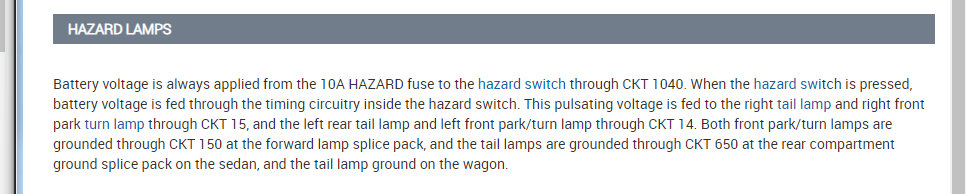

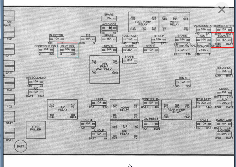

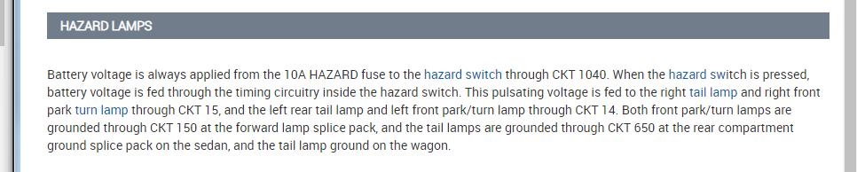

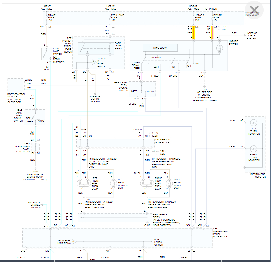

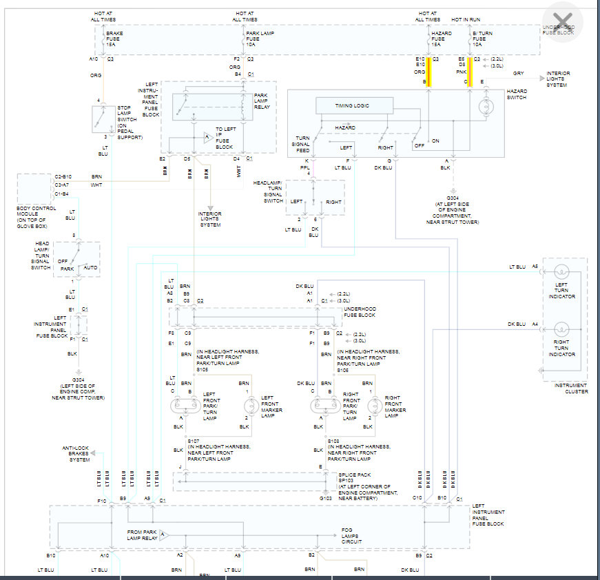

I understand you checked the fuses but we need to check for power on both sides of these fuses. Even if the fuse looks okay, it needs to light a test light on both prongs of the fuse so that we know for sure that it is passing current. I attached the info on these below:
Then we are going to have to test the output of the switch as well. Basically we need to find the place that the voltage is not getting too and then we can figure out what the cause is. Thanks
