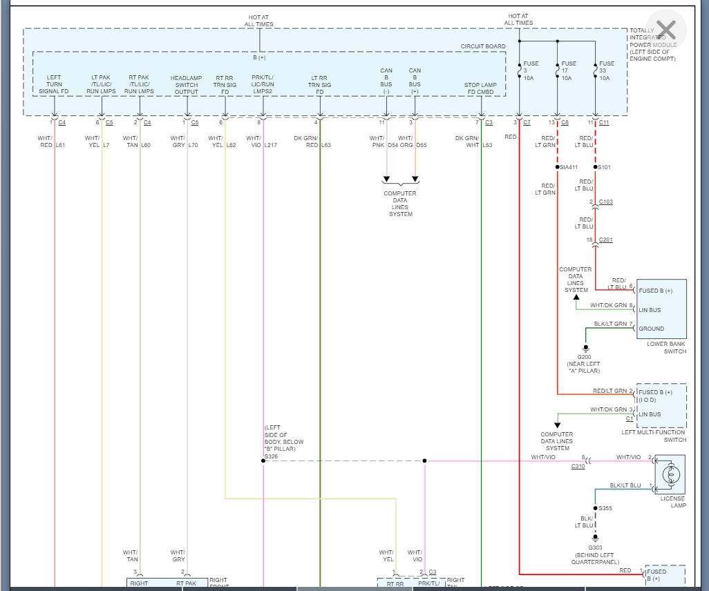

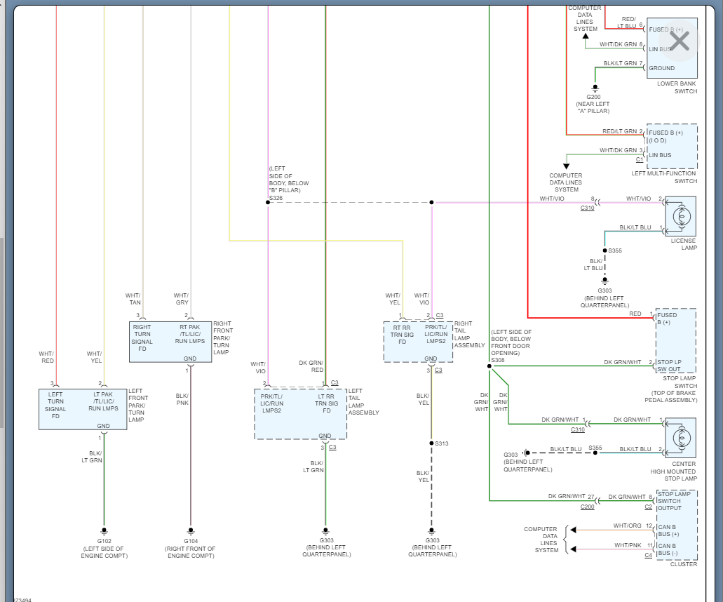

The hazard lights work but the blinkers, lights, and the windshield wipers aren’t working. The lights are stuck on the first setting, so they are on all the time.
