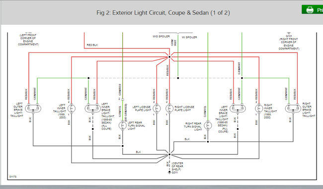

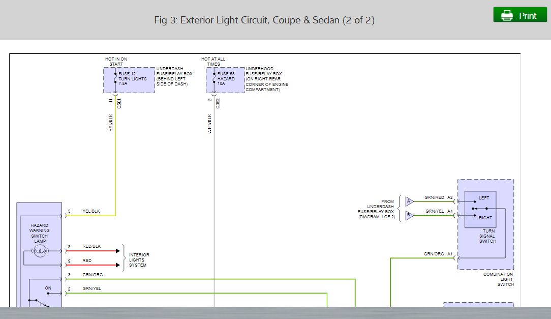

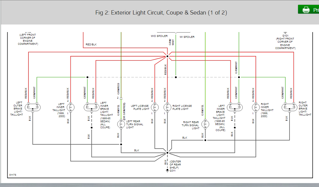

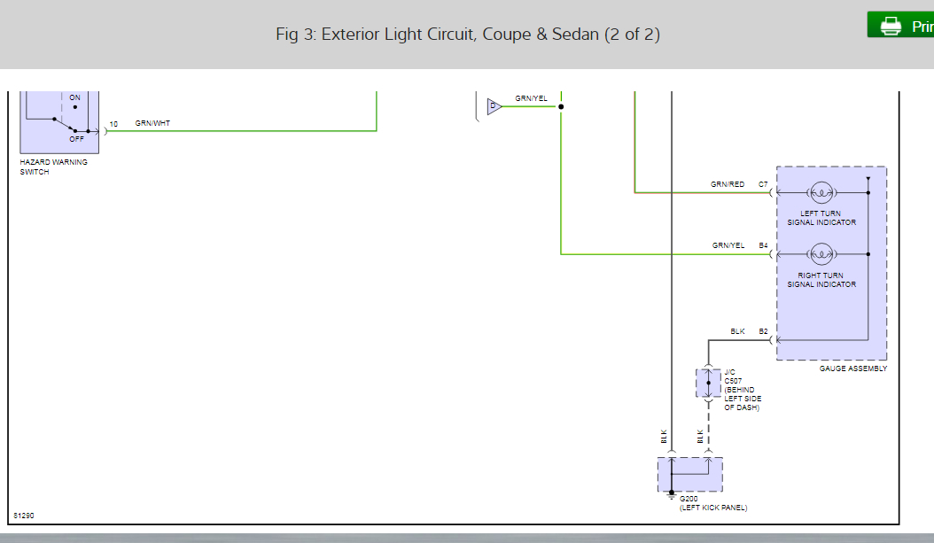

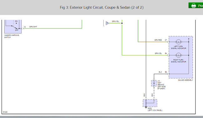

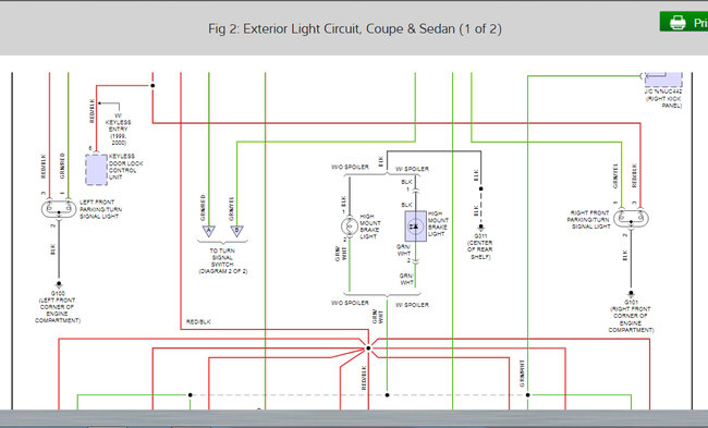

When brakes applied front left blinker starts, and when brakes not applied anymore it stop.
Back left blinker blinks but weak, the brake lights blinks as well with the blinker.
My front lights sometimes don't turn off when car is turned off.
