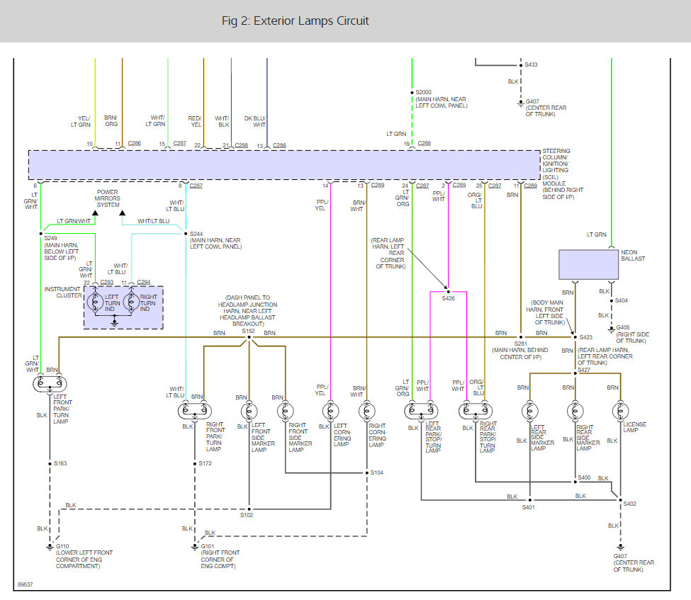

Blinkers and brake lights not working, but the middle light in window does work.
Nov 4, 2017 at 9:59 AM

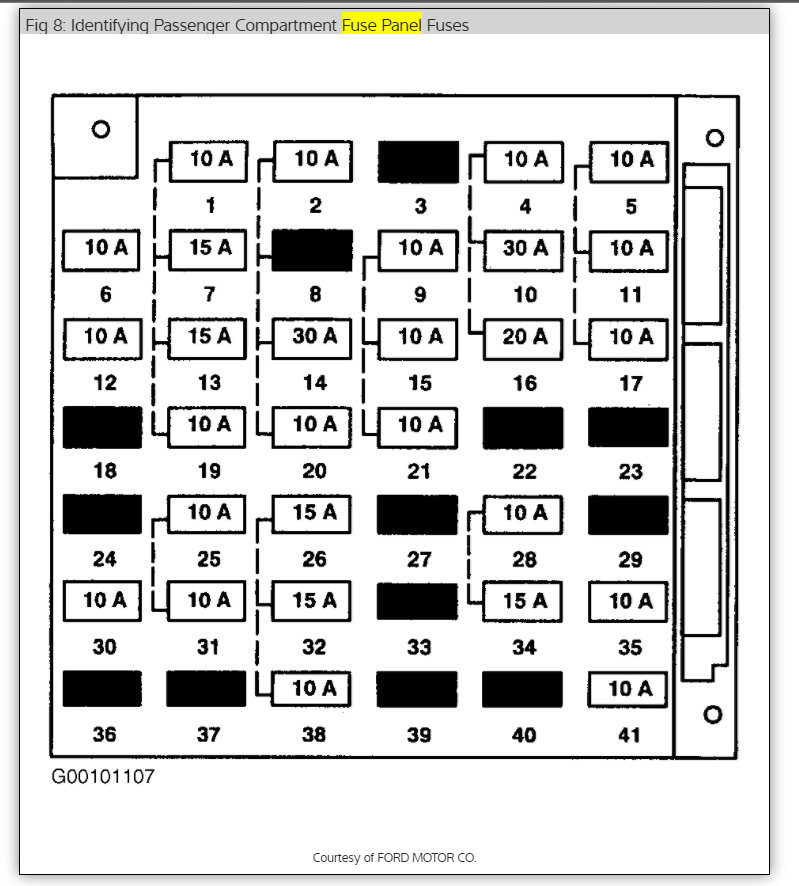

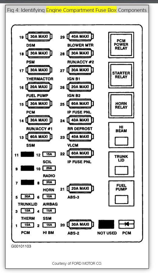

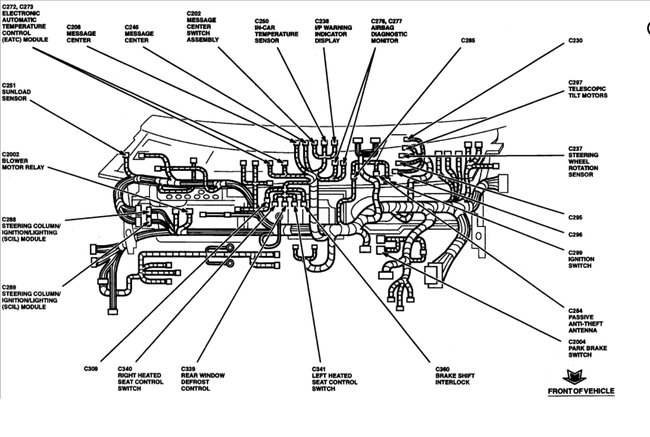

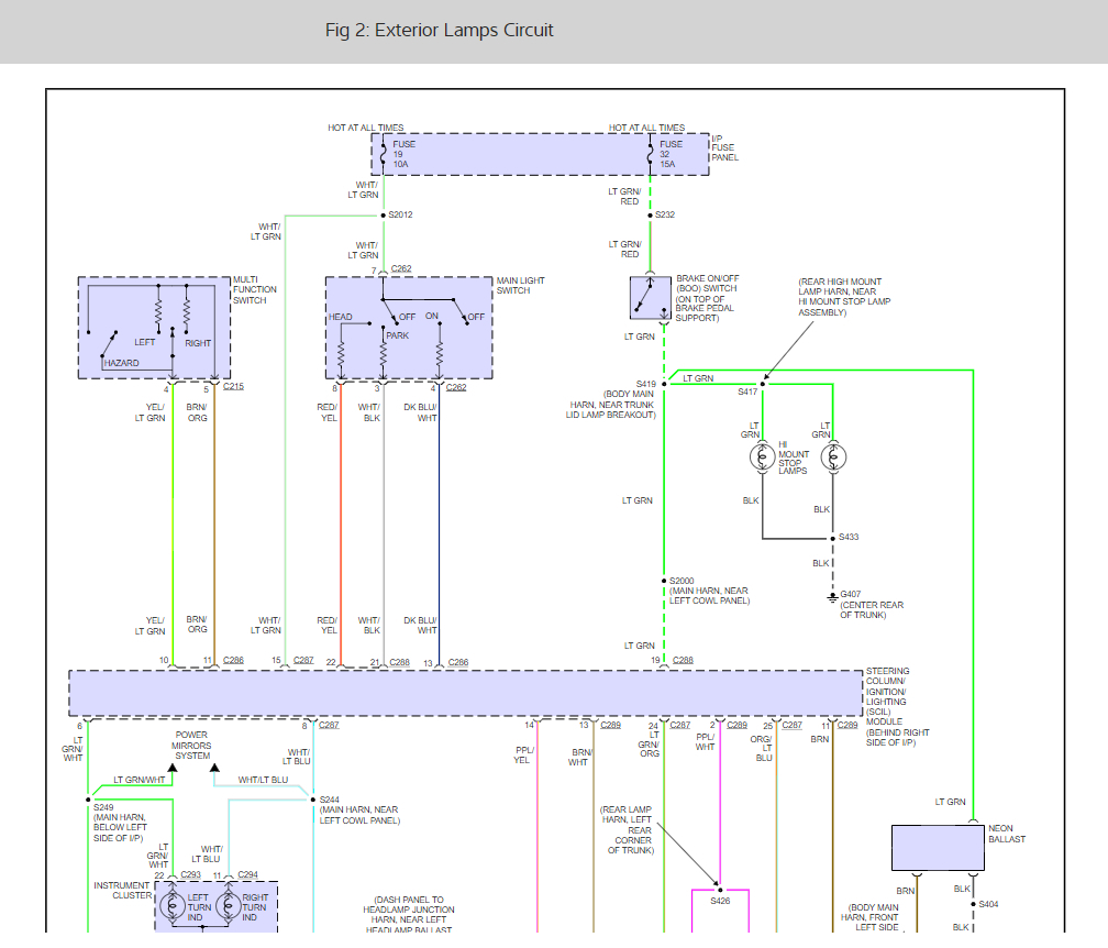

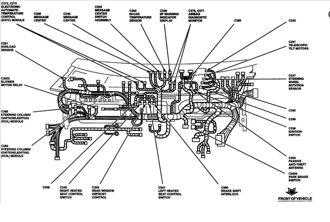

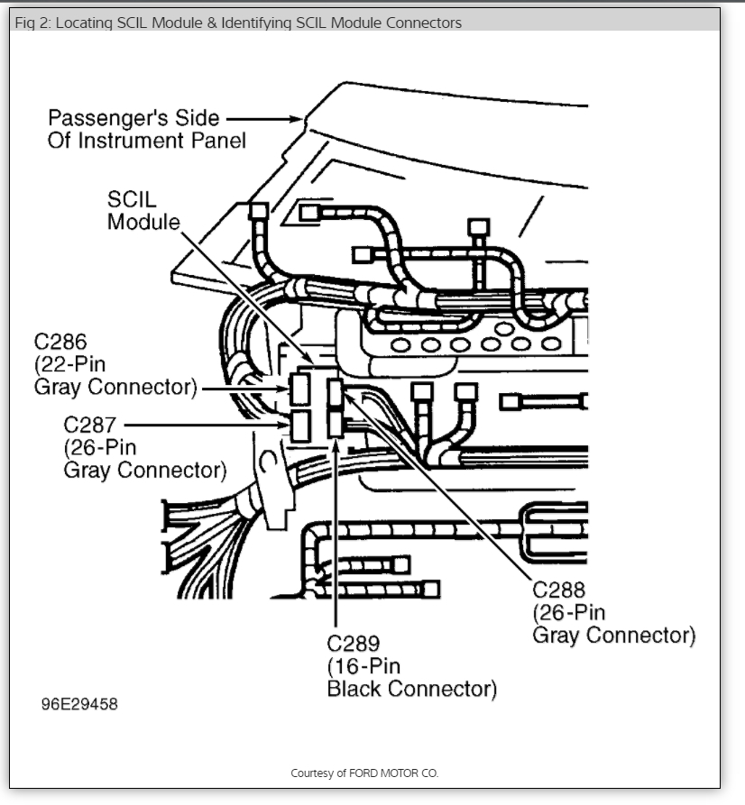

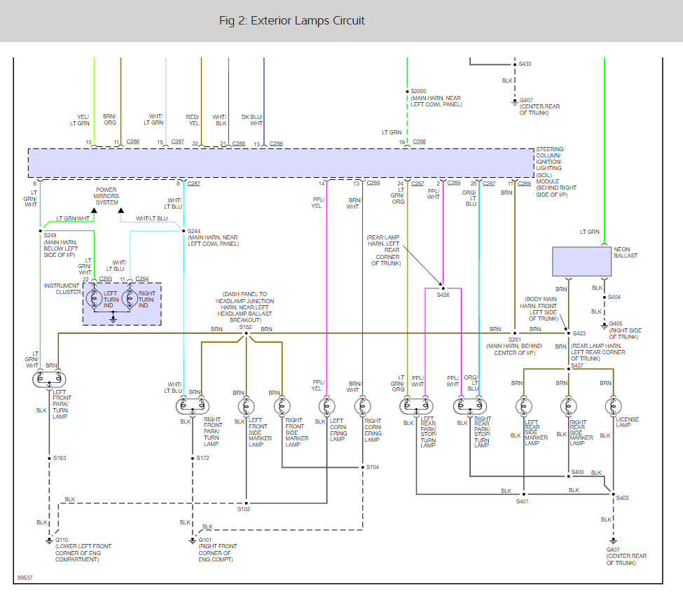

It sounds like you have a lighting module that is out. To be sure here is a guide and some wiring diagrams for the brake light system. I have the location of the lightening module as well.
Here is a guide to help with the testing:

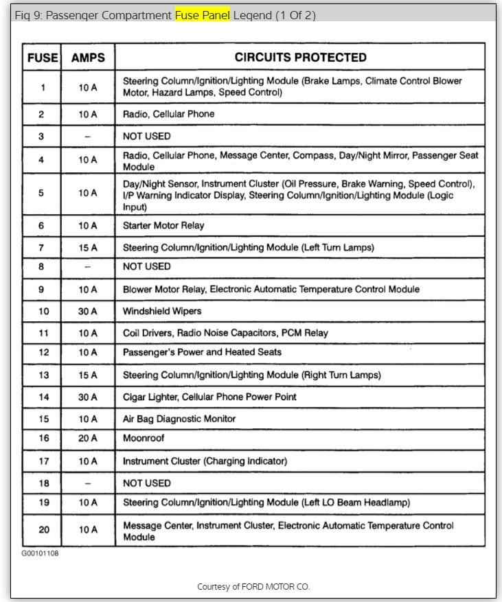

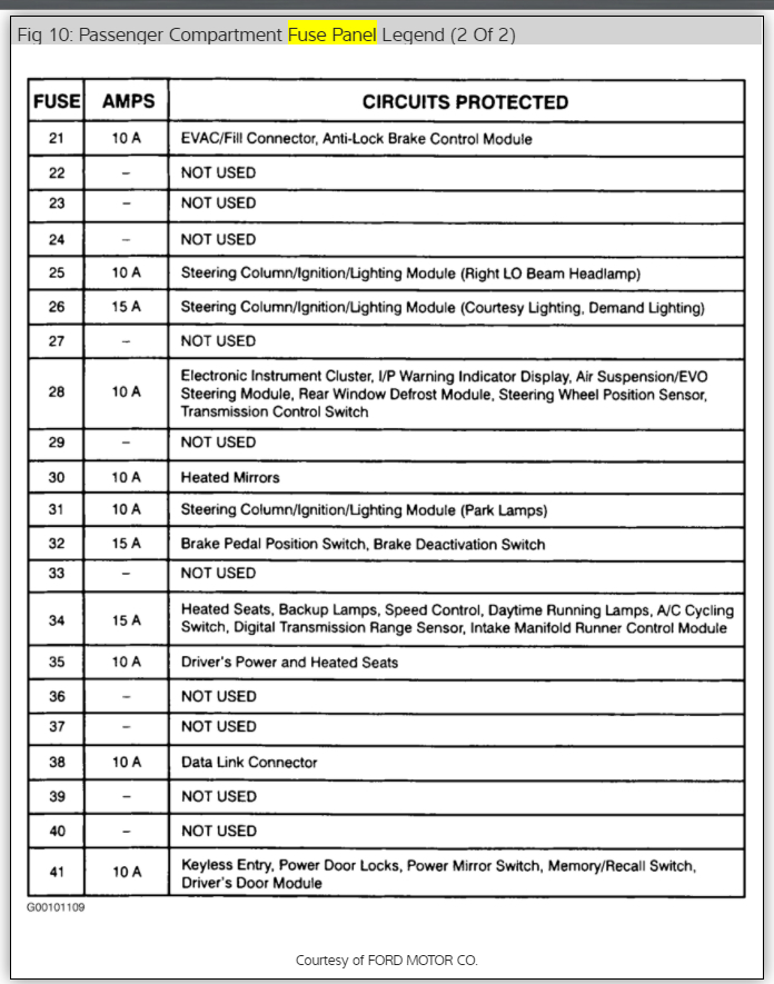

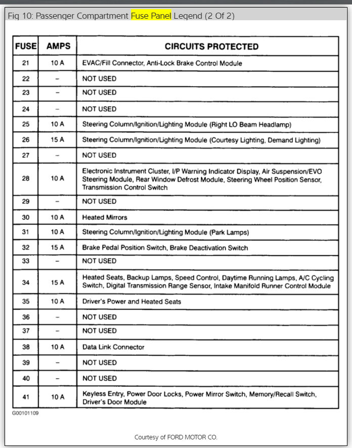

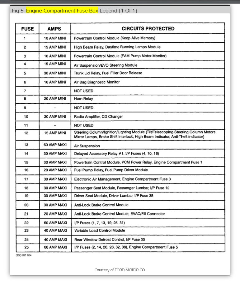

Also, check all fuses.
