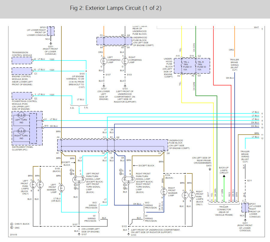

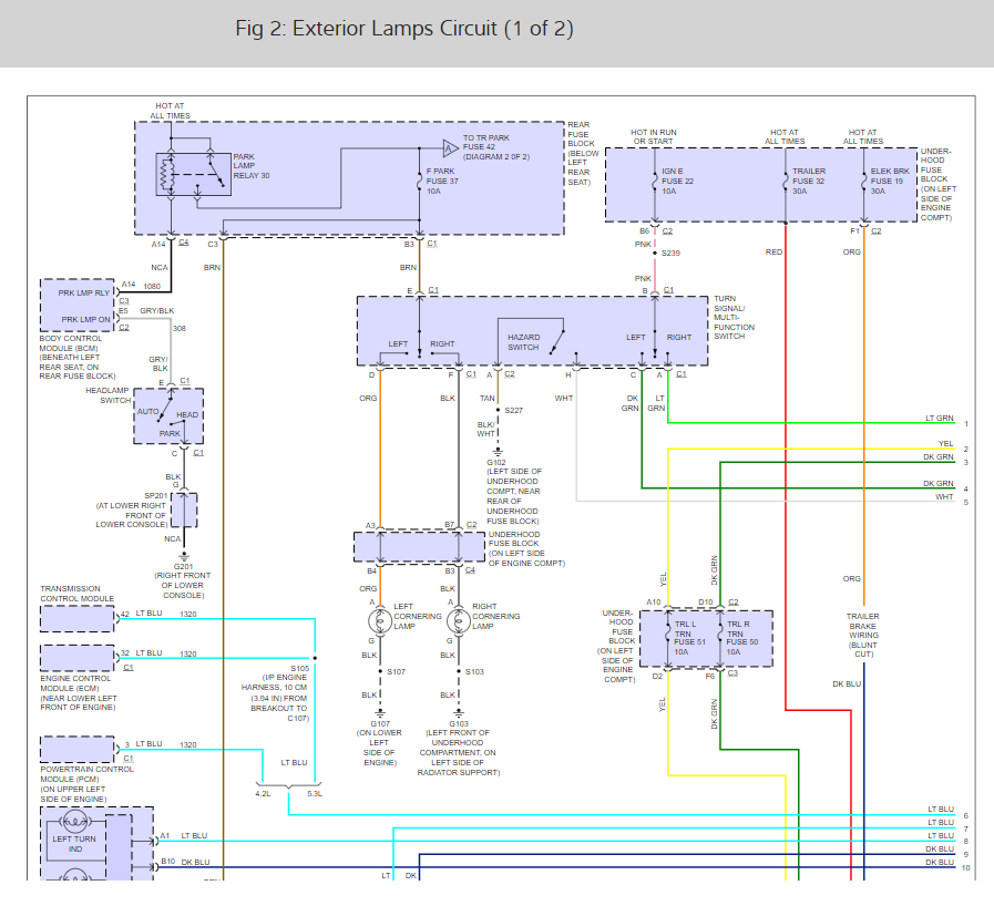

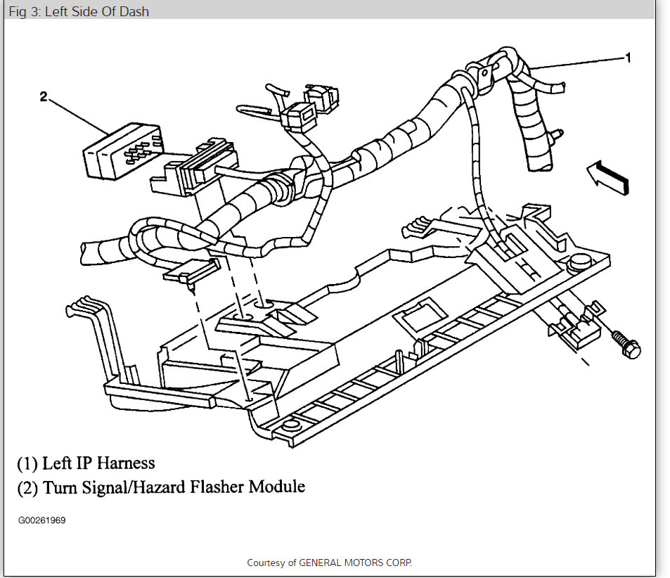

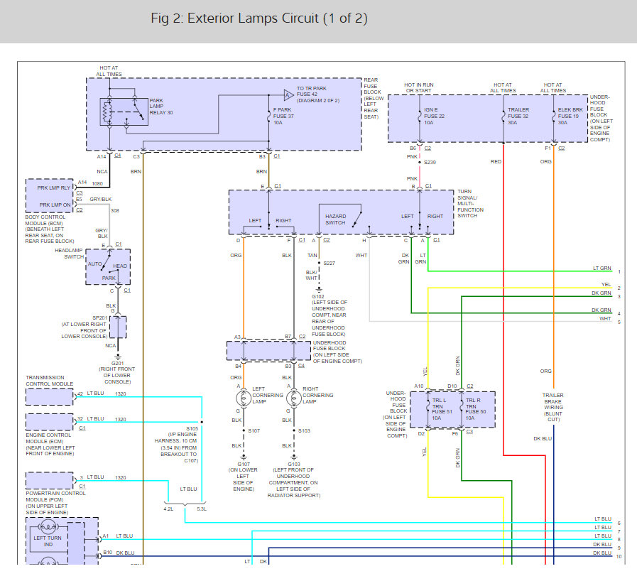

Here is the location of the flasher module and the blinker wiring diagrams to help you see how the system works. Here is a guide to help you check to see if you are losing power somewhere:

I pulled the cover down under dash where I think they say flasher is. but it is not there. My power steering pump and some wires.
Aug 26, 2018 at 5:36 PM
It should be there but it up high under the dash (hidden) use a flashlight to help.

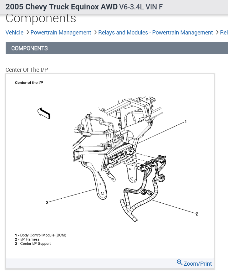

Hmm, maybe it is related. It can be the BCM causing the is issue. Lets remove the BCM electrical connectors to check for corrosion. Sometimes just removing and replacing the connector helps solve the problem. Here is the location.

It cooled to 92, lol. Checked BCM connections looked good, but have no way to check board out looks good no burns or anything like that also flasher is. Also the relay changed that. What you think my friend? Blessings, Bernie
Aug 30, 2018 at 11:40 AM
WHSW2002
  • 9 POSTS
Not sure what you meant after stating you have no way to check out your BCM, could you repeat it please? I have been following this adventure to learn from. I was just out on LI in July, visiting family. Was warm then as well.
Aug 30, 2018 at 11:43 PM
Yep, there is not way for you to actual test the BCM, but you can have the unit scanned to see what the health is. This will need to be done by a shop or the dealer. If the BCM is bad it will need to be programmed into the car before a new one will work which usually costs about $130.00.
