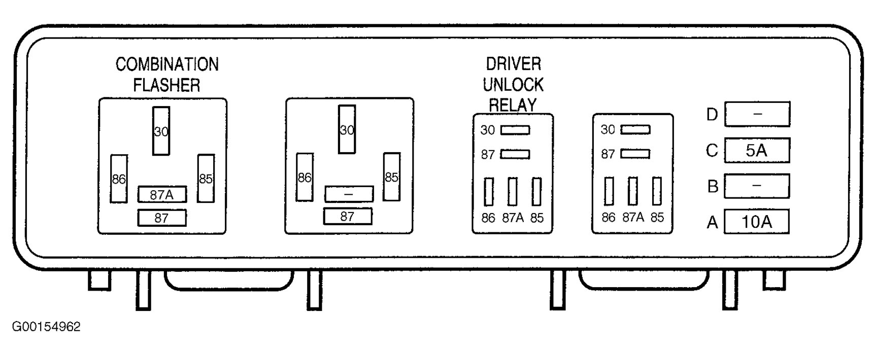

So let's go to both fuse boxes and touch the relays and see which one is clicking. It will most likely be hot as well.
I attached the info below on this. Let us know which one it is and we can go from there. However, I would replace the relay first as that is the most likely cause of this.

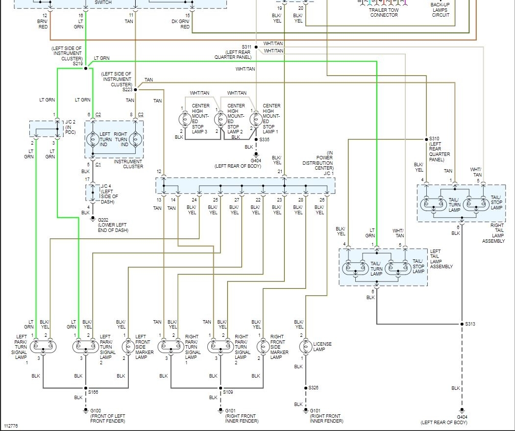

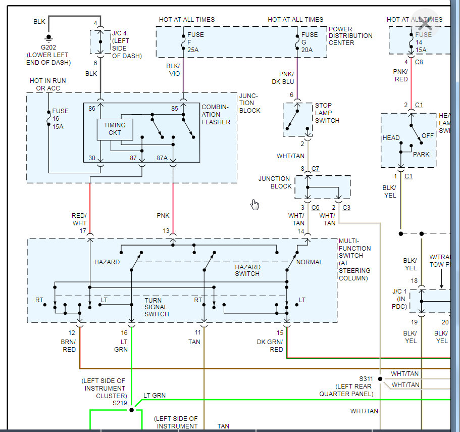

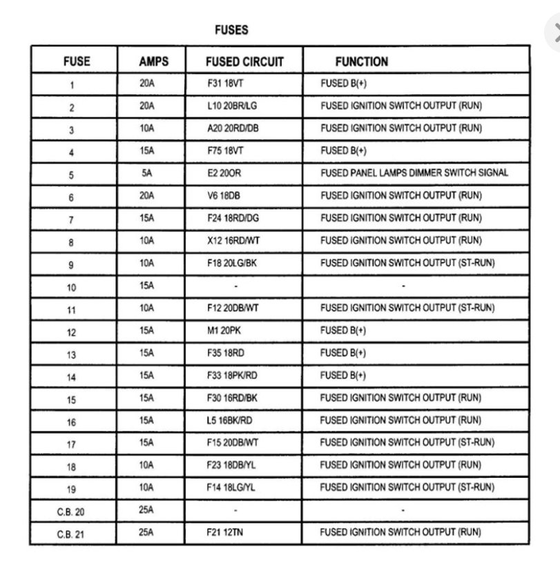

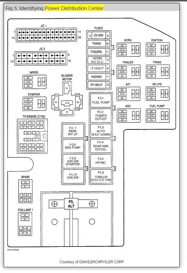

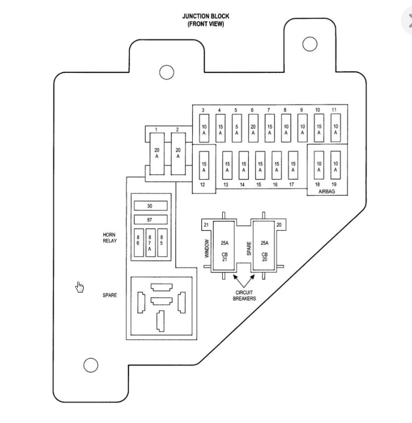

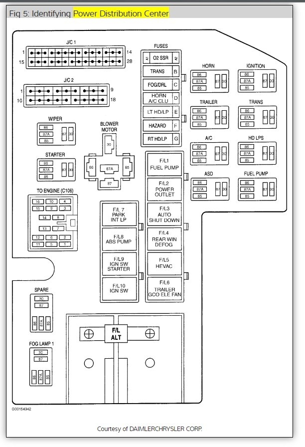

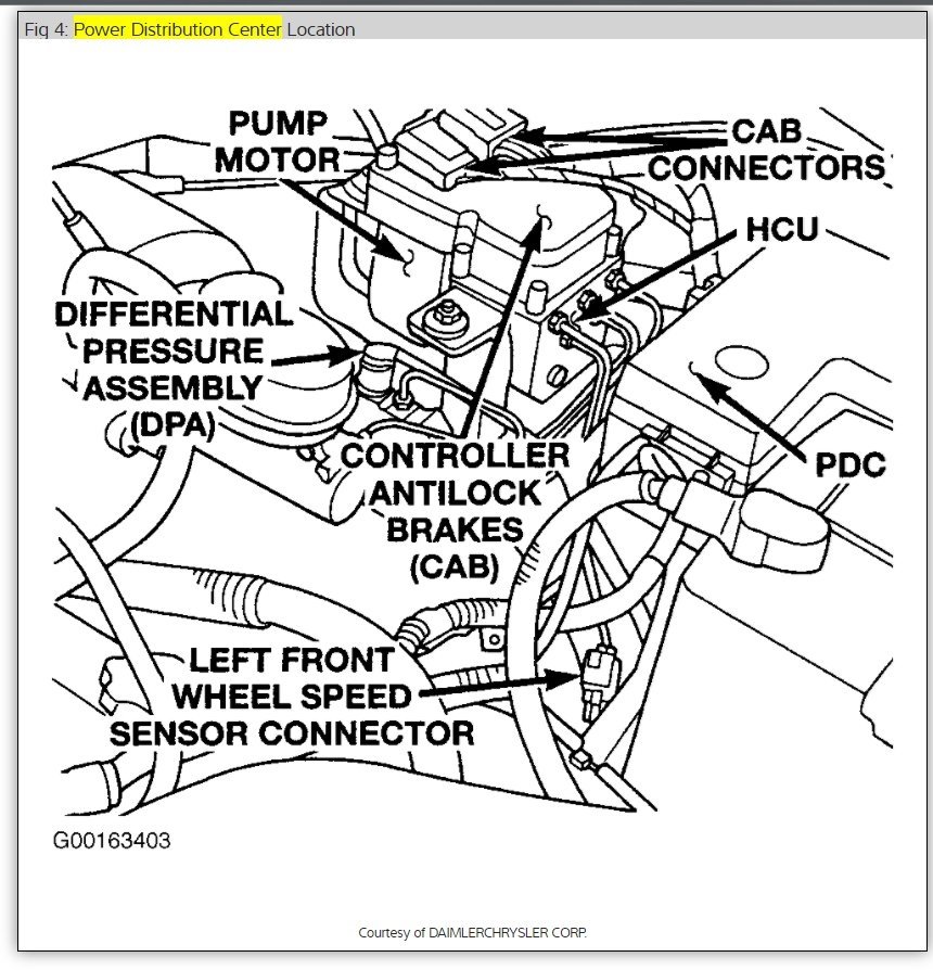

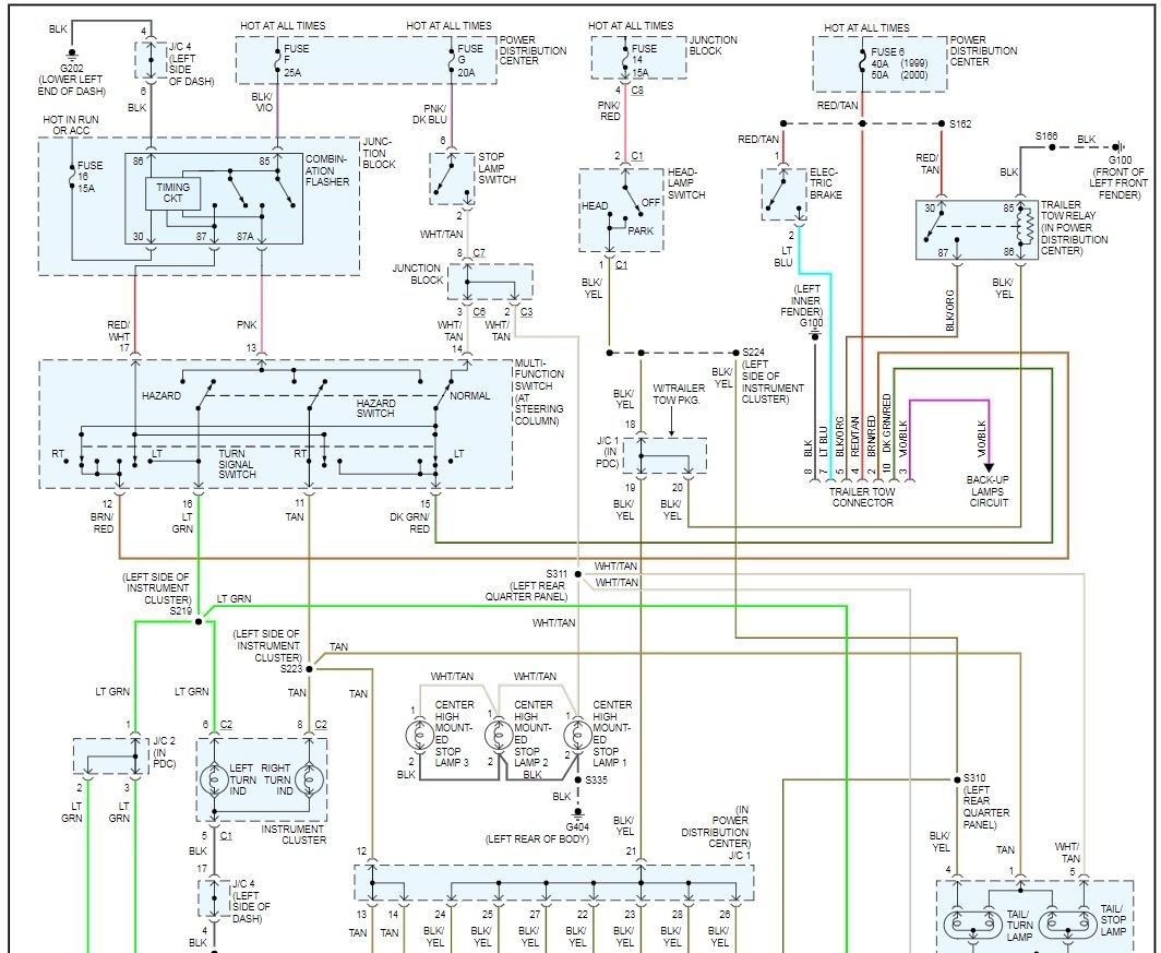

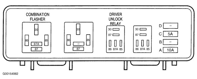

The flasher is in the relay panel behind the end cover at the left side of the instrument panel. diagrams (BELOW)

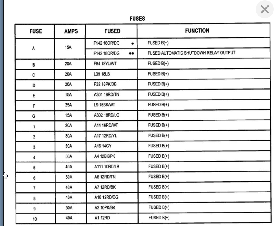

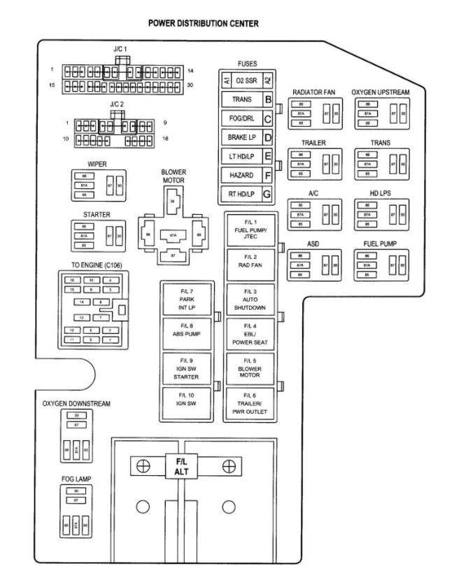

Here is a complete guide on the relay panels and locations.
Fuse (Amp) Application
A (10) Oxygen Sensors, Leak Detection Pump, Ignition Relay & High/Low Speed Cooling Fan Relay
B (20) Transmission Control Relay
C (20) Fog Lamp Relay, Left/Right Fog Lamp & Daytime Running Lamp Module
D (20) A/C Compressor Clutch Relay, Horn Relay & Headlamp Relay
E (15) Left Headlamp
F (25) Combination Flasher
G (15) Right Headlamp
1 (20) Fuel Pump Relay, Powertrain Control Module & Fuel Pump Module
2 (20) Power Outlet & Rear Power Outlet
3 (30) Automatic Shutdown Relay, Fuel Injectors 1-8 & Ignition Coil
4 (50) Rear Wiper/Defogger Switch
5 (40) Blower Motor Relay, Blower Motor & Power Seat Switch
6 (40) Trailer Tow Relay, Electric Brake & Trailer Tow Connector
6 (50) High/Low Speed Cooling Fan Relay & Radiator Fan Motor
7 (40) Junction Block
8 (40) Controller Anti-Lock Brake
9 (50) Engine Starter Motor Relay & Ignition Switch
10 (40) Ignition Switch

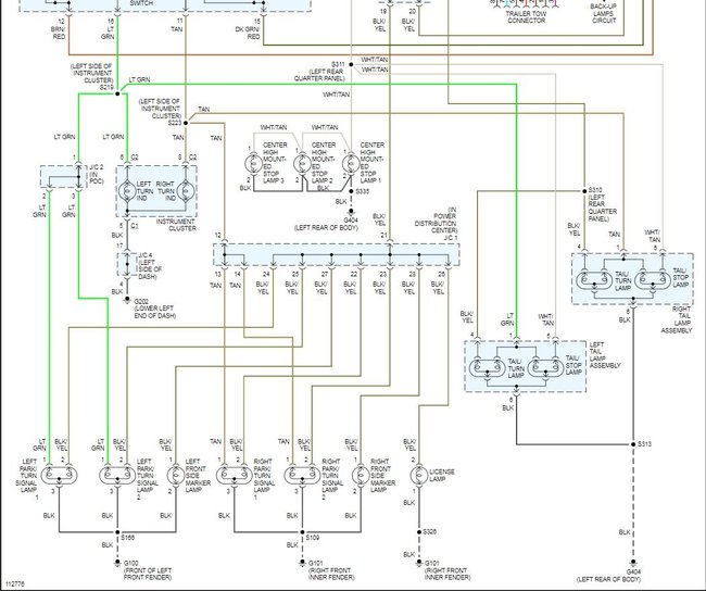

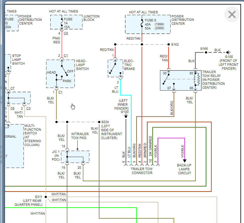

and

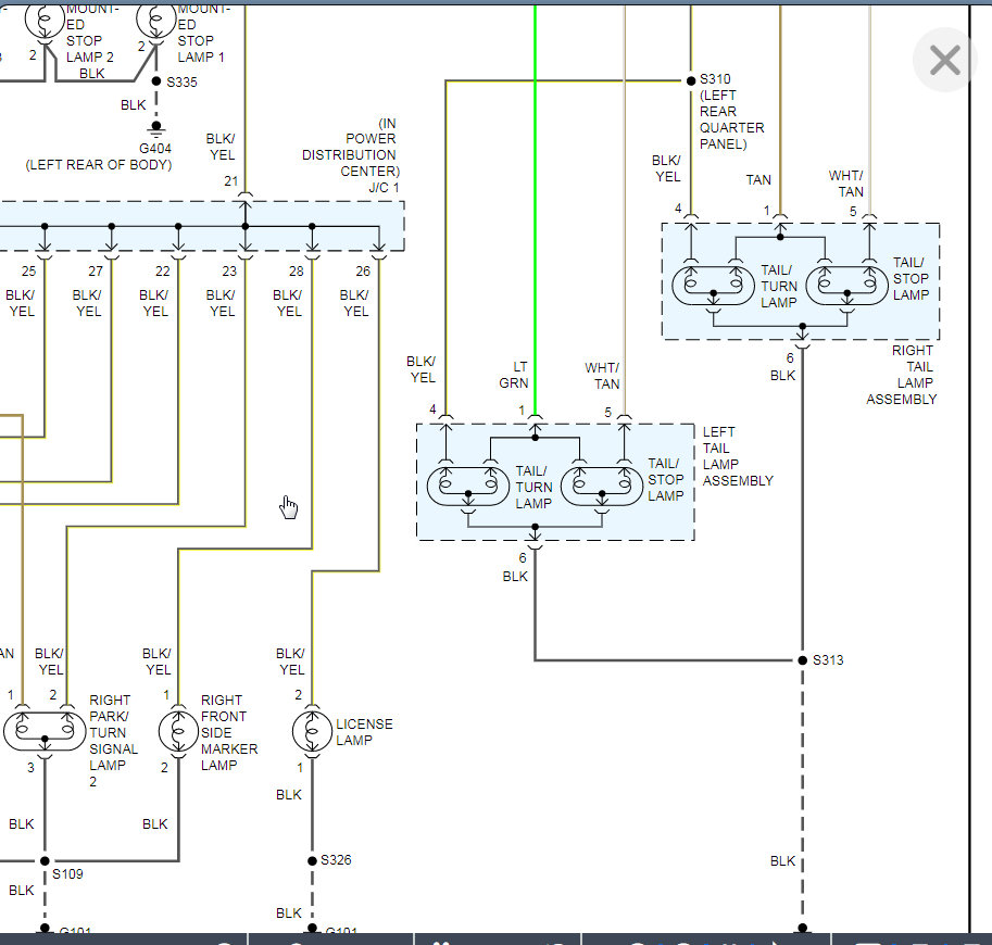

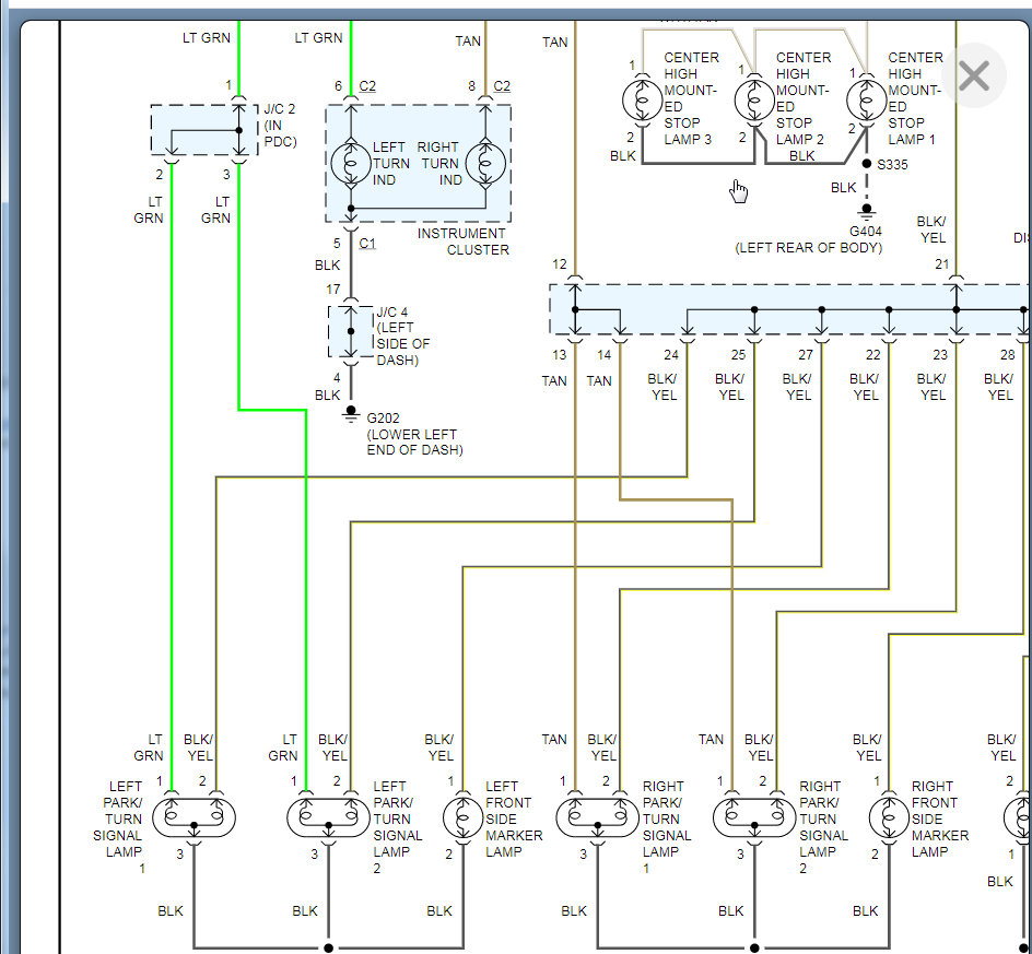

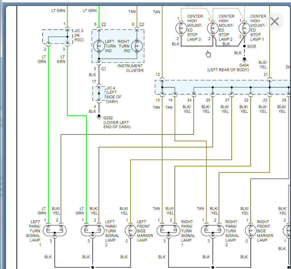

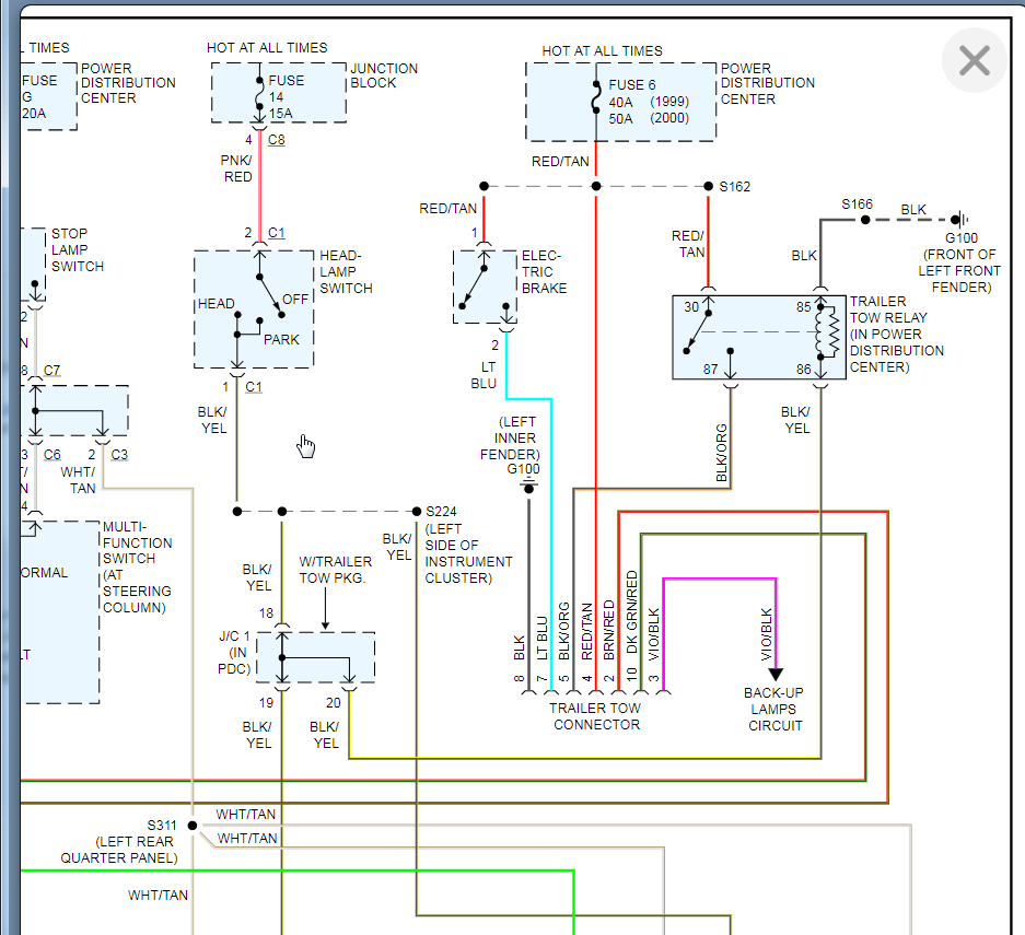

Wiring Diagrams attached below as well
