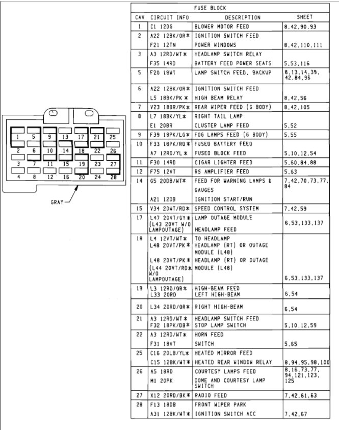

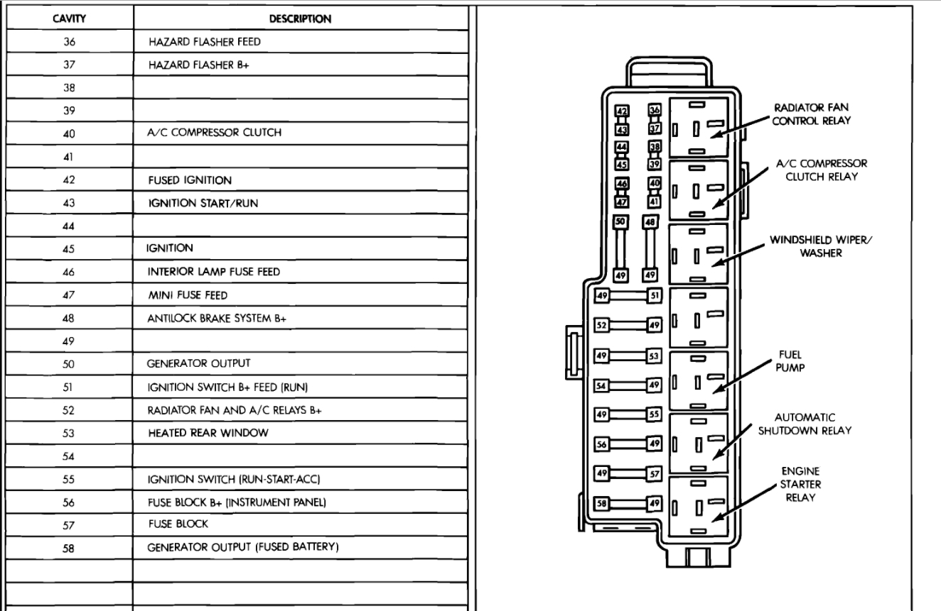

Emergency flashers and blinkers do not work. If this a common thing I need to know where to start?
Apr 16, 2017 at 6:28 AM
It sounds like you have a flasher that is out which is located int he fuse panel but we should check the fuses as well.
Here is a guide to help you check the fuses.
Here are the fuse locations and what they go to (below)
