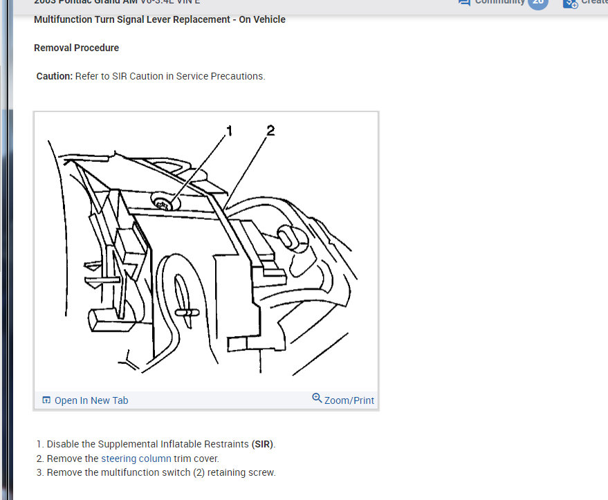

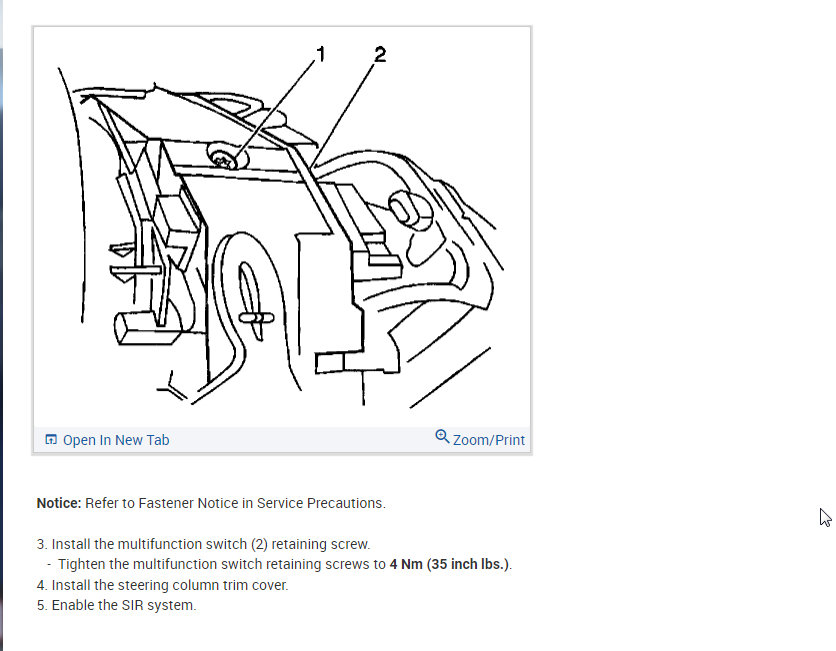

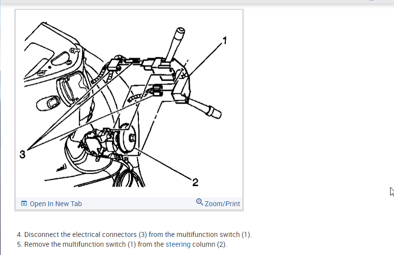

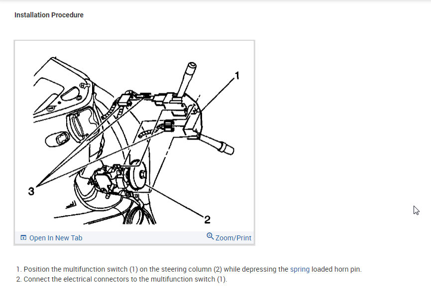

This sounds like you have an issue with the turn lever. I am attaching the process for replacing that but maybe if you get a video of what you have to do in order to get the turn signals to start working, that will help us get on the same page.
