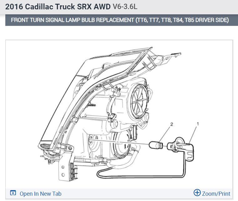

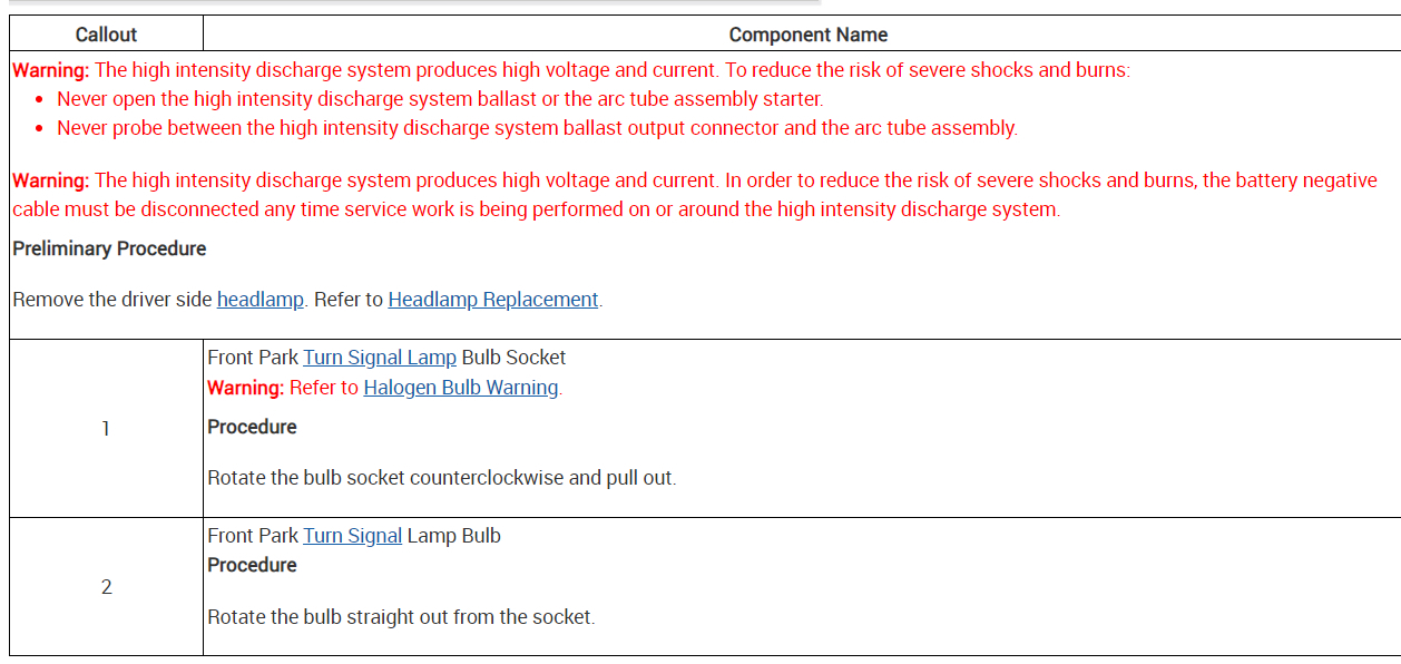

I need to ask if this is an aftermarket part? If so, they are fitted with the cheapest bulb on the market which burns out quickly. I would use an AC Delco long life bulb (LL). Here is how to replace the bulb correctly. Check out the images (below). Please let us know what happens.
