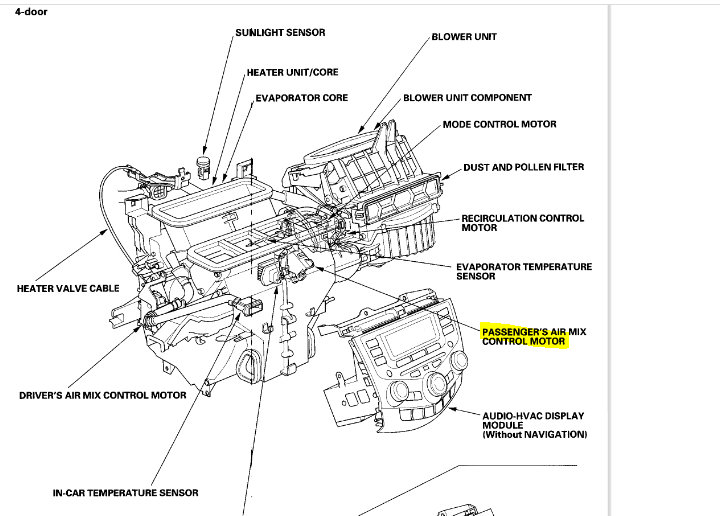

I'm looking at an exploded view of the components. Is it the passenger-side air mix door that is the issue? I ask because above it, I see a mode door actuator and a fresh-air door actuator.
Take a look at the pic below and let me know. Also, let me know if it is the right side that is having the temperature issues and if this has automatic or manual climate control. Also, there is a difference between a 2-door and 4-door. So, confirm that for me as well.
One last question. When you request heat, does the A/C continue to blow cold air or do you feel the air from the outside?
See pic below.
