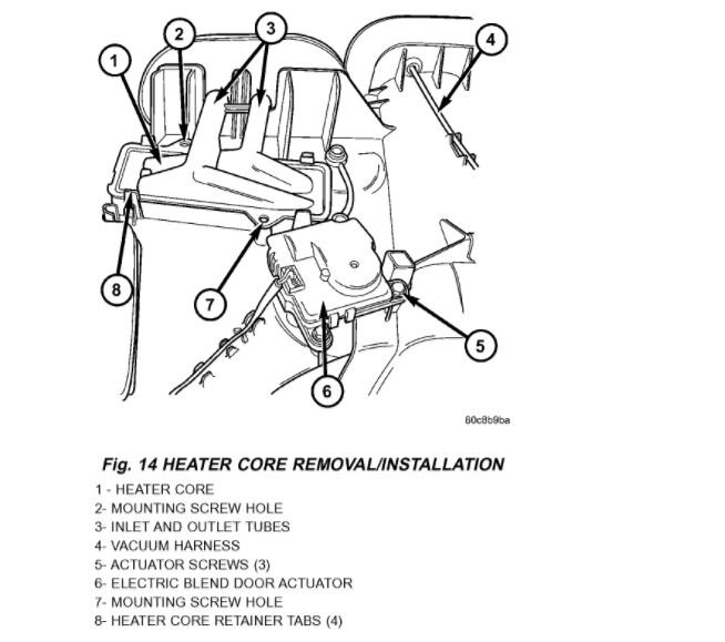

Okay, sorry, but the answer is yes. the dash has to be removed to gain access to the top of the heater case. I attached a picture for you to view.
