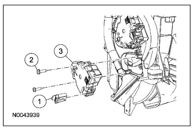

If the heater is coming on this would be a blend door problem. Here is the location of the blend door actuator on the drivers side which it sounds like you are having the issue with. If I am wrong please let me know. Check out the images (below). Please let us know what happens.

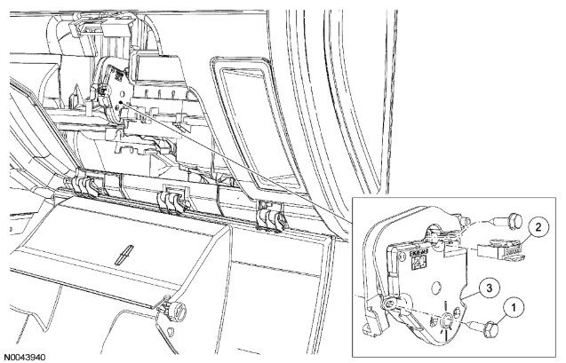

Hmm,, not really, it should not turn the heat, but can you tell if the AC stops working and this is why it gets hot or if the HVAC system turns the heater on? Here is the location of the passenger side blend door actuator. You will need to remove the glovebox. Check out the images (below).
