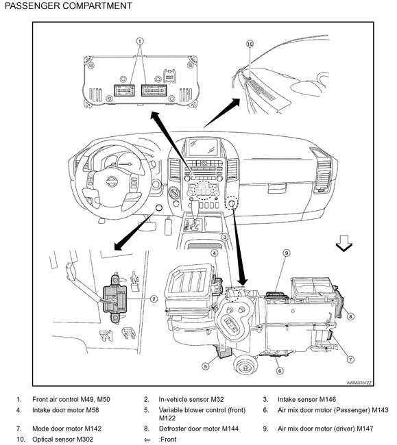

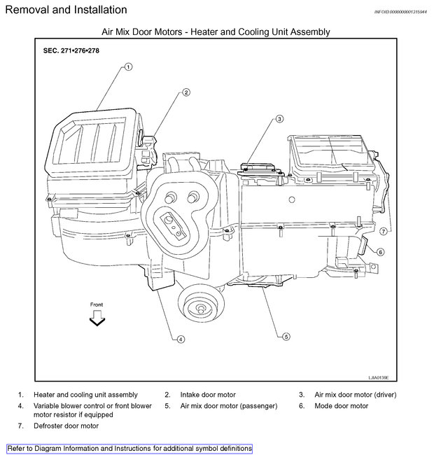

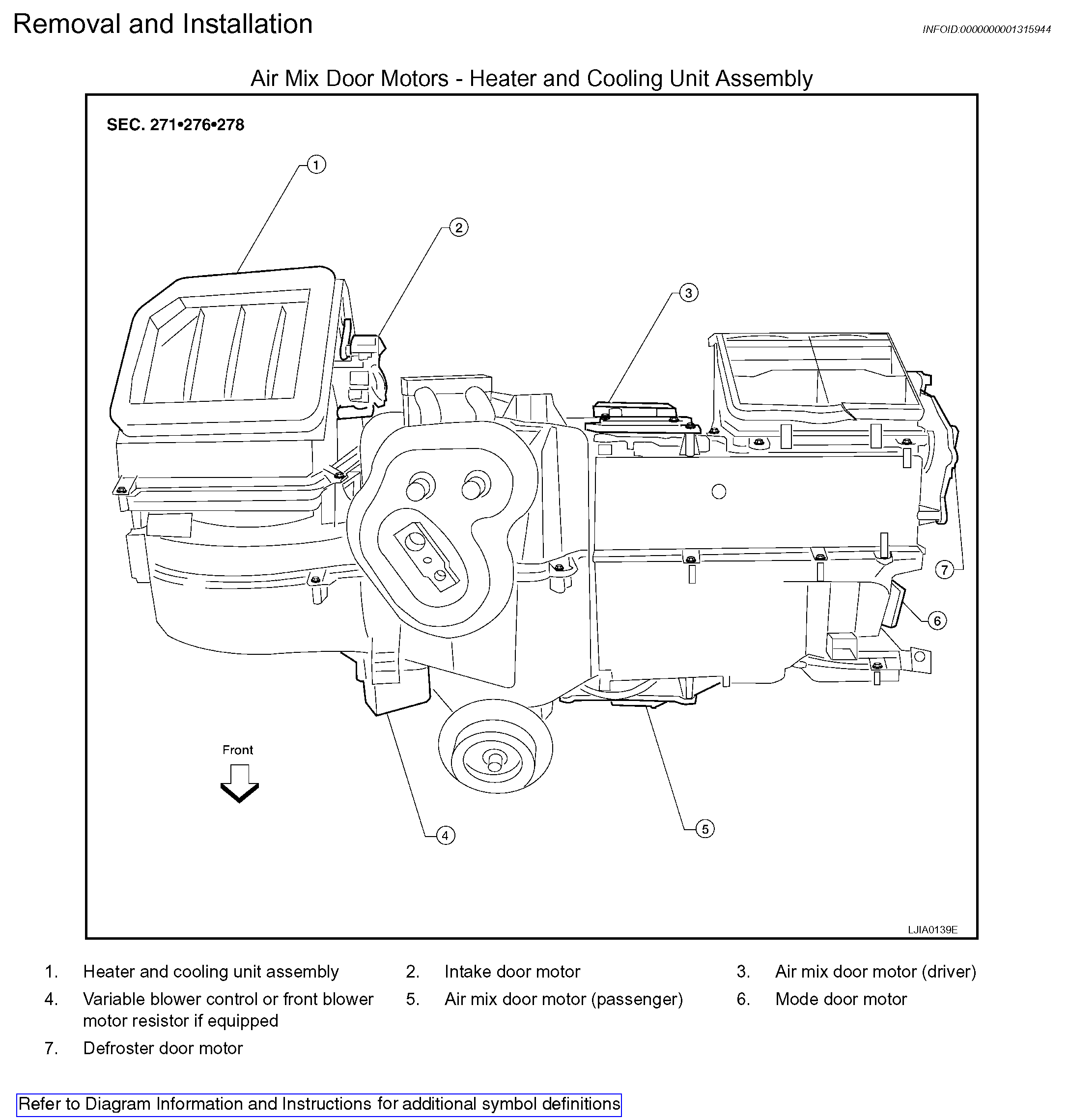

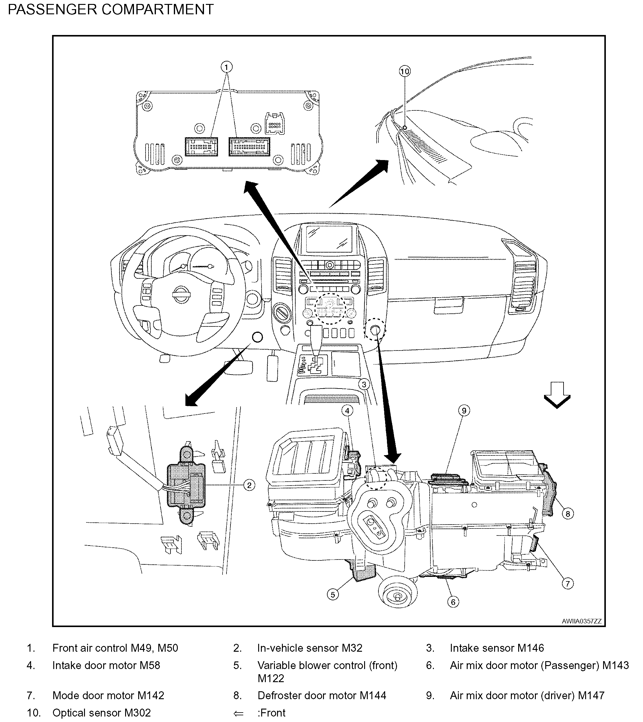

It is located under the dash on the AC/heater box. There are two of them, one for each side. First, here is a link that shows in general how one is replaced:
Here are the directions specific to your vehicle for replacement. Also, the attached pictures correlate with these directions,.

Exploded View VTL-20
See Pic 2
AIR MIX DOOR MOTOR (DRIVER)
Removal
1. Remove the heater and cooling unit assembly.
2. Remove the steering member from the heater and cooling unit assembly.
3. Disconnect the air mix door motor electrical connector.
4. Remove the three screws and remove the air mix door motor.
Installation
Installation is in the reverse order of removal.
AIR MIX DOOR MOTOR (PASSENGER)
Removal
1. Remove the center console lower cover LH.
2. Disconnect the air mix door motor electrical connector.
3. Remove the three screws and remove the air mix door motor.
Installation
