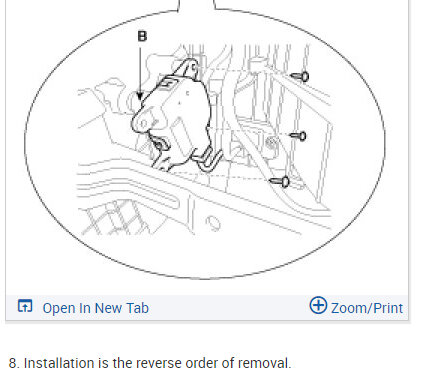

Hello, I have the vehicle listed above Koup and every time i turn my A/C system on i hear a knocking noise for a couple of seconds and then stops. However, this does not occur when turning on the heat, just the cool air. So, I am unsure of what blend motor actuator I need to change and where they are located on my vehicle.
Jul 27, 2024 at 12:07 PM

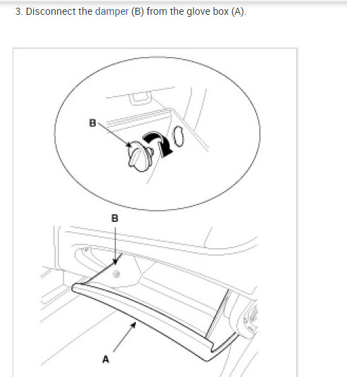

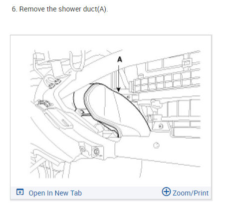

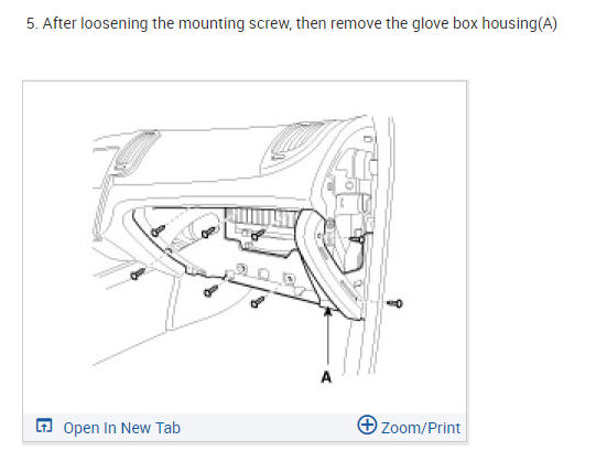

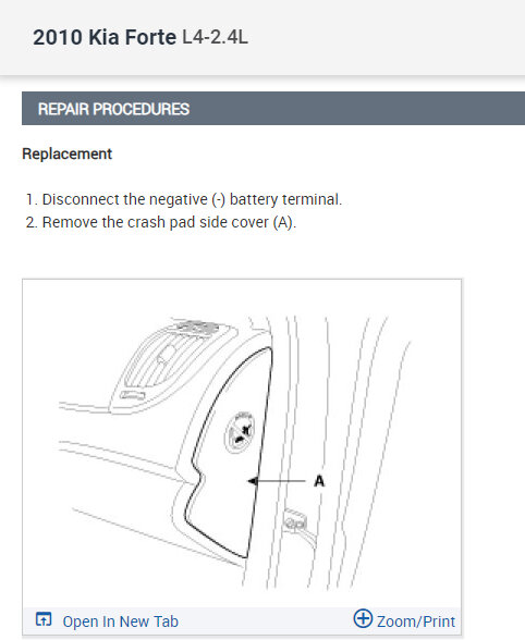

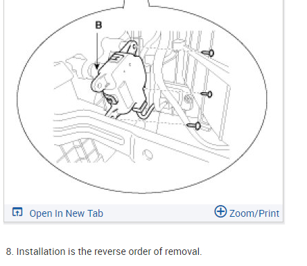

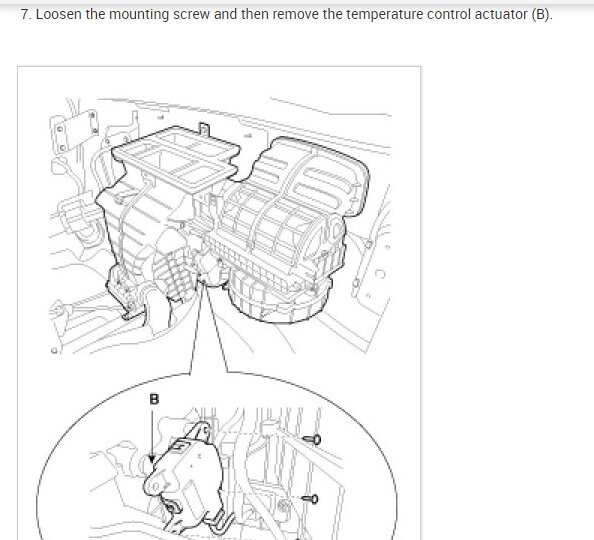

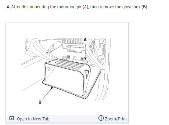

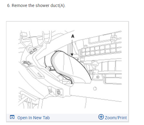

It sounds like the plastic gear in the actuator motor is failing. If you look below, I attached the directions specific to your vehicle for replacing it.
Additionally, here is a link that explains in general how it's done. You may find it helpful to look over it prior to starting the job.
Let me know if this helps.
See pics below.
