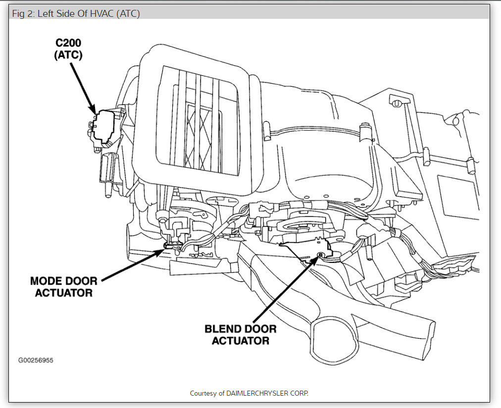

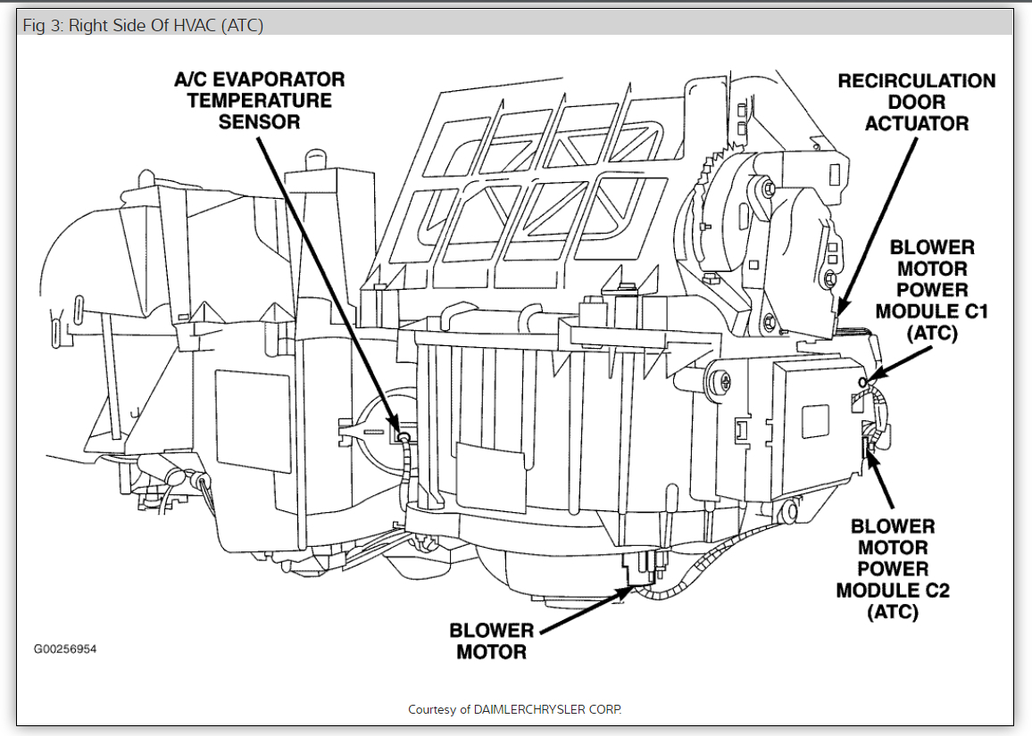

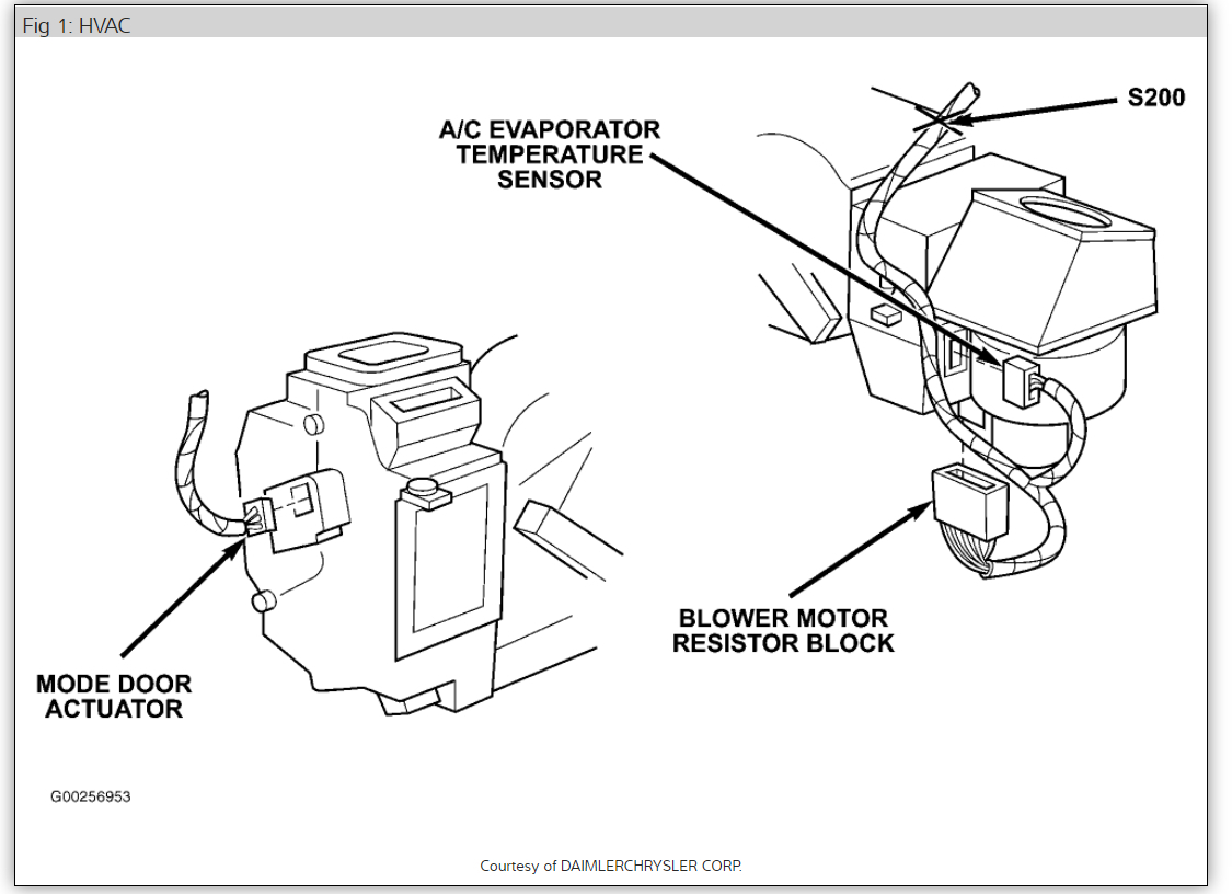

Sounds like you need to check the fuses and power and grounds to the controls. Being that either the blend door or mode doors are being controlled that is where I would start. Also look at the temperature blend door actuator here is a guide to walk you though the steps with the location for your car below.
Check out the diagrams (Below). Please let us know what happens.

Thank you for this post I had to get a new temperature blend door actuator for $87.00 all fixed I love this site.
