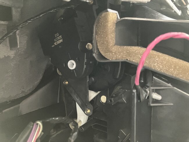

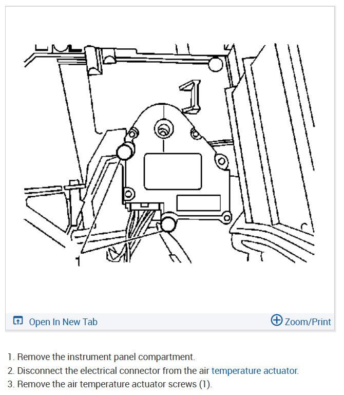

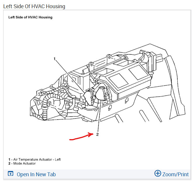

Yes, let's make sure you have replaced the correct actuator. Here is the location of the actuator on the right-side actuator. Also, I have marked the mode actuator in the images below as well.

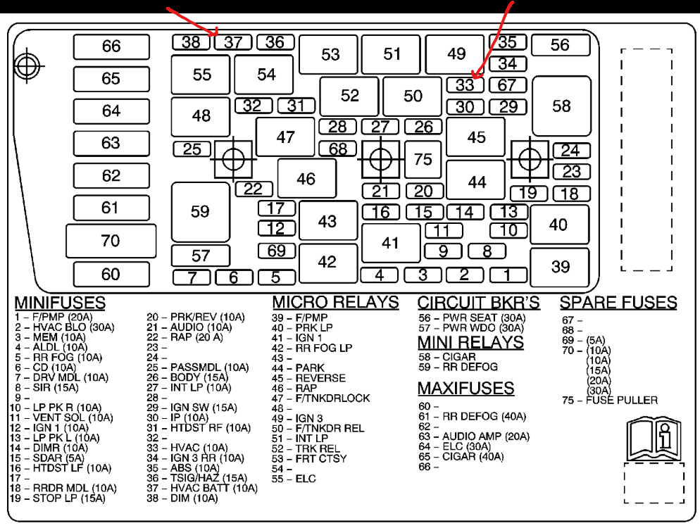

RE-CALIBRATING ACTUATORS
CALIBRATION PROCEDURE
Use the following steps to perform the calibration update:
1. Turn OFF the ignition.
2. Remove the battery positive voltage circuit fuse of the HVAC Control Module.
3. Wait 60 seconds.
IMPORTANT: The module memory will not clear if the battery positive voltage circuit fuse is installed in less than 60 seconds.
This guide can help as well to reset the entire HVAC system.
https://www.2carpros.com/articles/step-by-step-guide-to-reset-your-cars-hvac-system-an-essential-for-every
Here are the fuses (37 and 34 in the rear fuse panel) you should remove. Check out the images (below). Please let us know what happens.

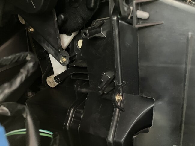

I cannot find the 3rd actuator that I believe controls the driver temp - picture attached. I see where I believe the 3rd actuator would screw into.
Jul 11, 2025 at 5:34 PM
Yep, you are correct. This is non dual HVAC controls.
Temperature Blend Door Actuator (Passenger Side)
ACDelco GM Original Equipment: 15-72646
GM OEM: 89018365
and
Mode Door Actuator (Driver Side)
GM OEM: 52491800
ACDelco Replacement: 15-72647
Let me know what happens.
