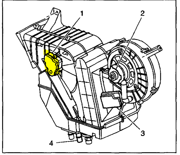

I have replaced both actuators up front and have full adjustment ability. My rear HVAC does not have temperature adjustment just fan speed. I pulled off the rear passenger panel to see the system and there was not a blend door or actuator.
When I run heat up front then I turn on the back system the back vents blow ice cold. Did I install it wrong or is there a blend door that is stuck?

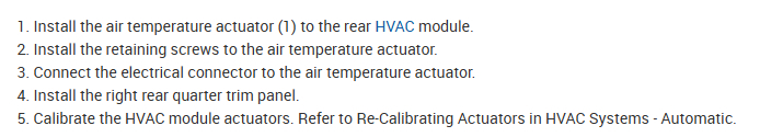

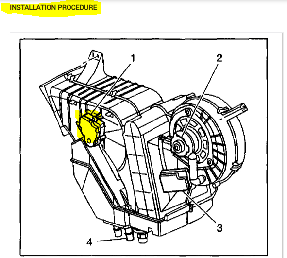

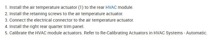

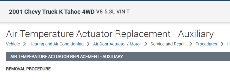

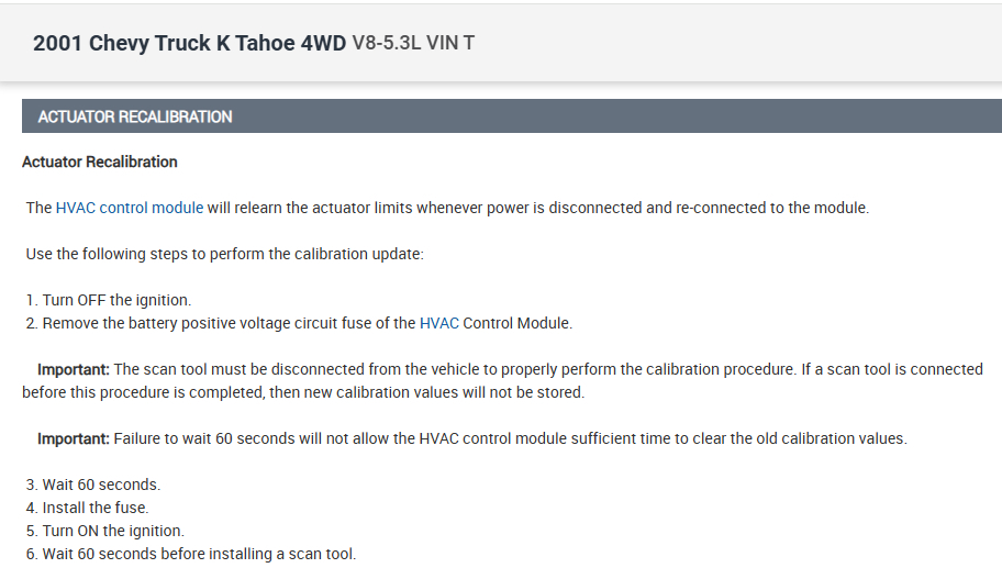

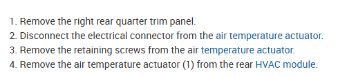

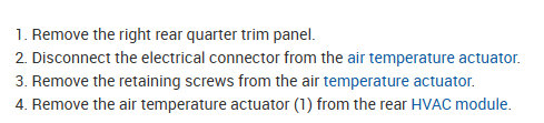

There is an air temperature actuator for the rear HVAC. It is located behind the passenger side rear trim panel.

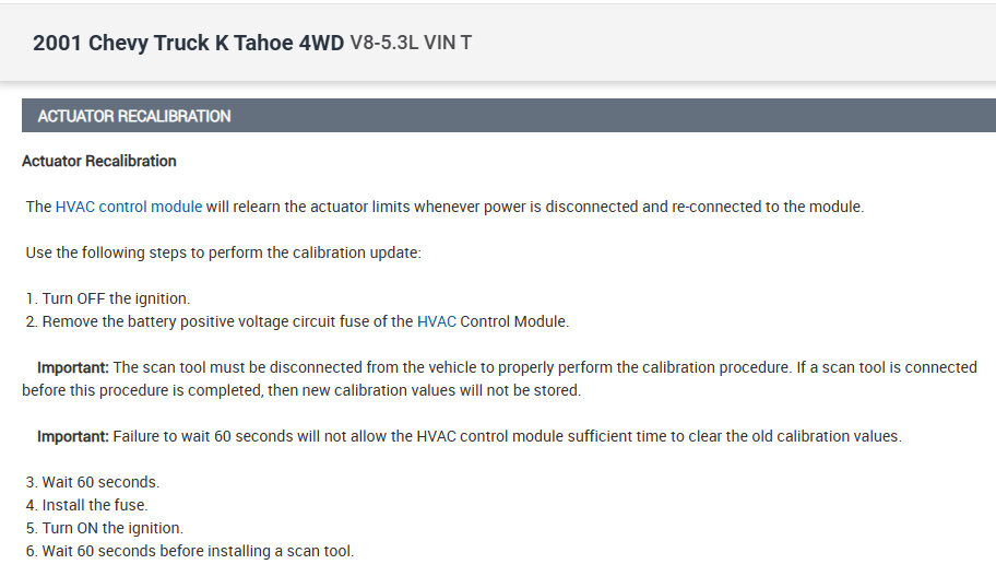

If you look below, I attached the directions for removing and replacing it. Also, the last pic provided the re-calibration process.
Let me know if this helps.
See pics below.

I took off that panel yesterday and there is no blend door actuator in that area. The controls for the rear are fan speed only.
