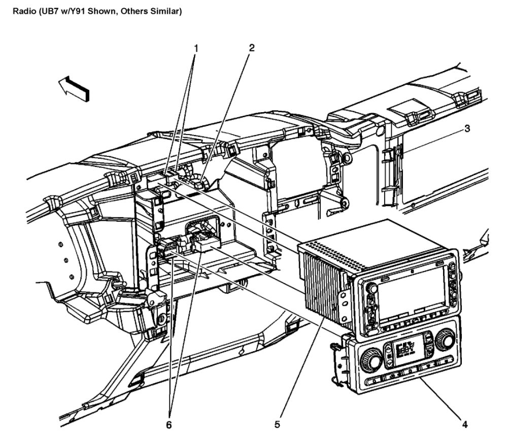

It sounds like the controller is going bad. Here is a diagram to help you get it changed out. I would try a used one because they do not go out that often.
Here is another guide that can help:
