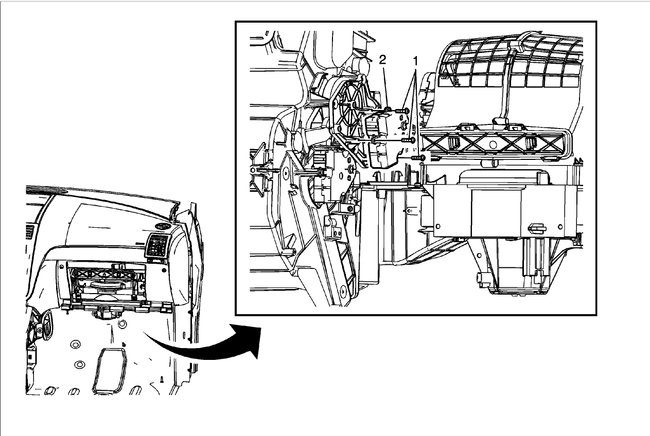

how to install replacement? it still will not change between defrost and floor.
Oct 15, 2017 at 2:37 PM
Yes, it sounds like you have a mode blend door actuator that is not working.
Here is a guide that will show you whats going on and how to fix it:
Check out the images (Below). Please let us know what happens.

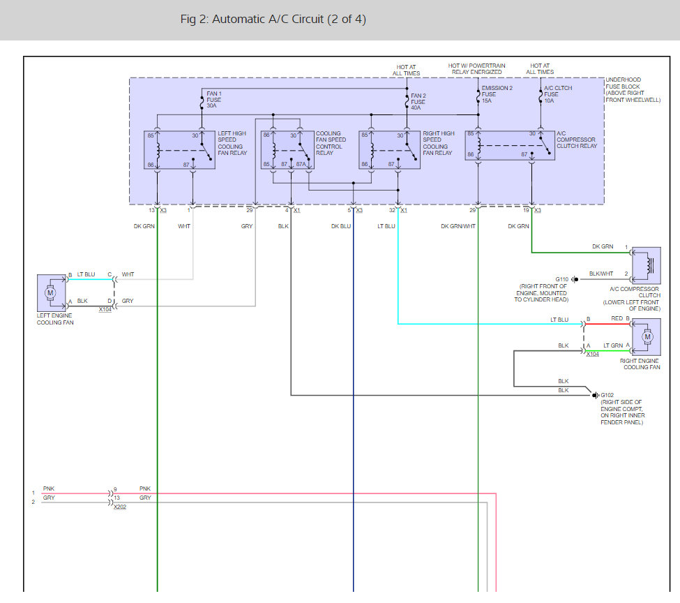

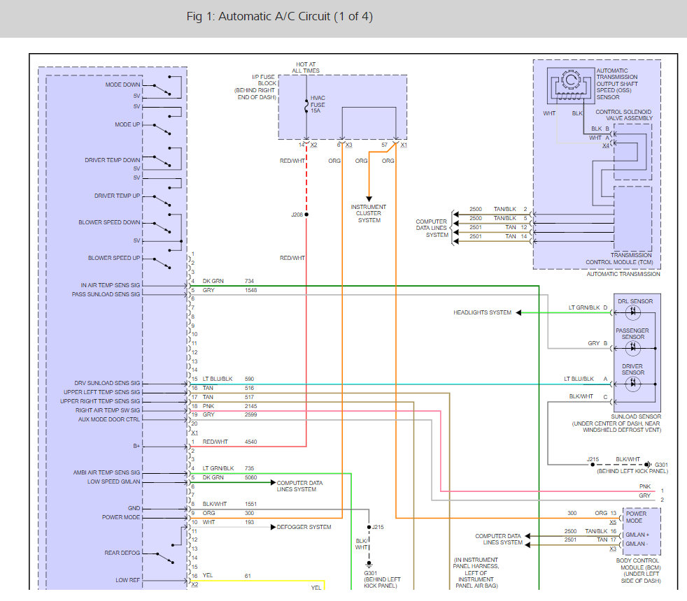

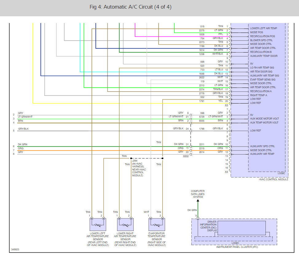

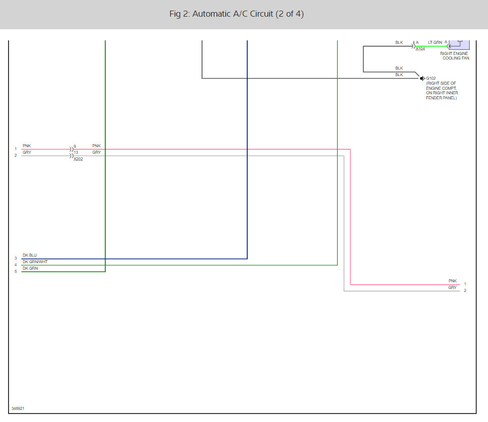

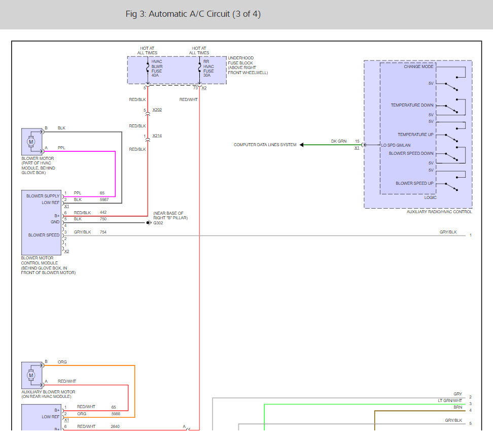

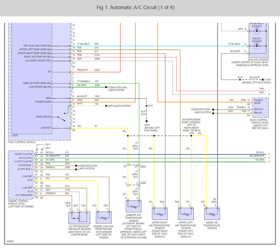

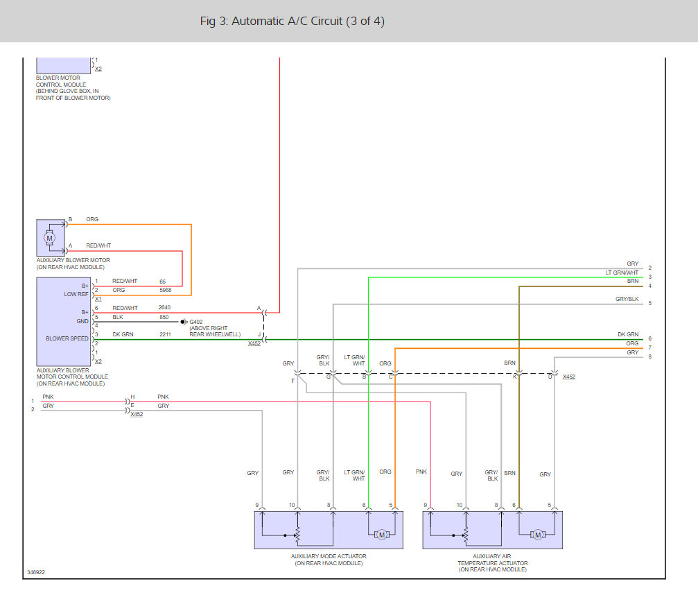

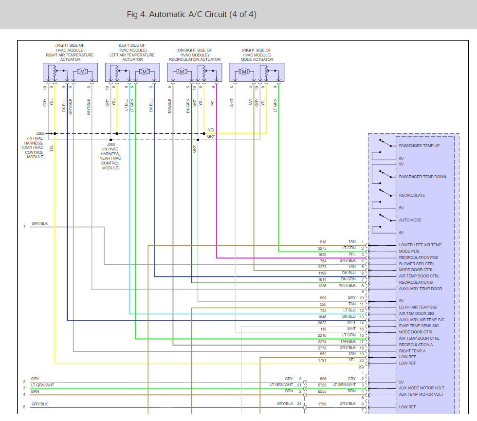

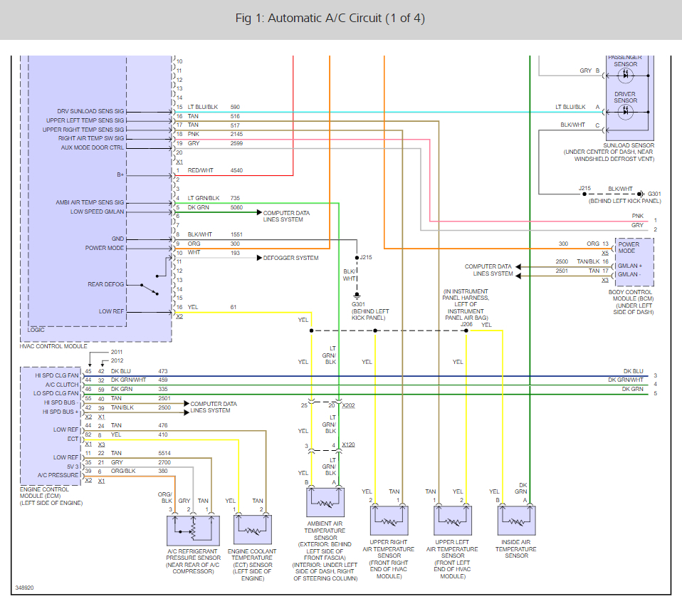

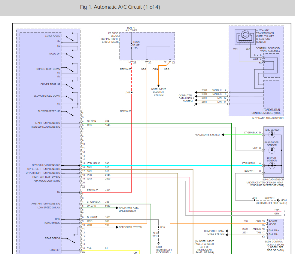

Here is a wiring diagram to help us see what the problem is and what is all in the system.
Use this guide and check for power and the five volt references. I sounds like the controller is out.

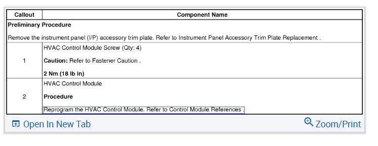

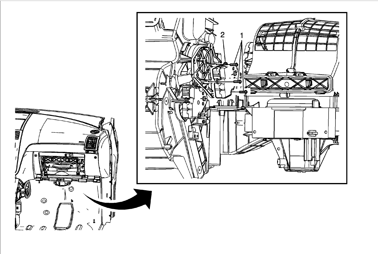

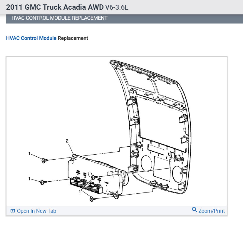

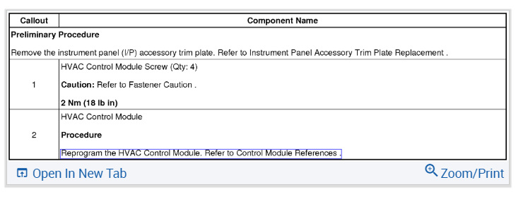

That will vary with the position of the actuator. Have you tried the system reset- calibration? Check out Steve W. post above. If that doesn't work it sounds like the control module is out here is how you replace it. Check the diagrams below.
HVAC System Control Module Programming and Setup
Each of the following service procedures may require programming or setup procedures to be performed on the HVAC control module or HVAC actuators.
HVAC Control Module Replacement
If the HVAC control module is replaced it must be programmed with the latest operating software and vehicle calibrations. Refer to Service Programming System (SPS) (See: Vehicle > Programming and Relearning > Service Programming System (SPS)).
HVAC Control Module Reprogramming
Do not reprogram the HVAC control module, unless directed by a service procedure, or a service bulletin.
Reprogram HVAC Control Module-Refer to Service Programming System (SPS) (See: Vehicle > Programming and Relearning > Service Programming System (SPS)).
Actuator Replacement
If an actuator is replaced, the following procedure must be performed:
* Re-Calibrating Actuators-Refer to Actuator Recalibration (See: Heating and Air Conditioning > Programming and Relearning > HVAC - Manual) for the manual system.
* Re-Calibrating Actuators-Refer to Actuator Recalibration (See: Heating and Air Conditioning > Programming and Relearning > HVAC - Automatic) for the automatic system.

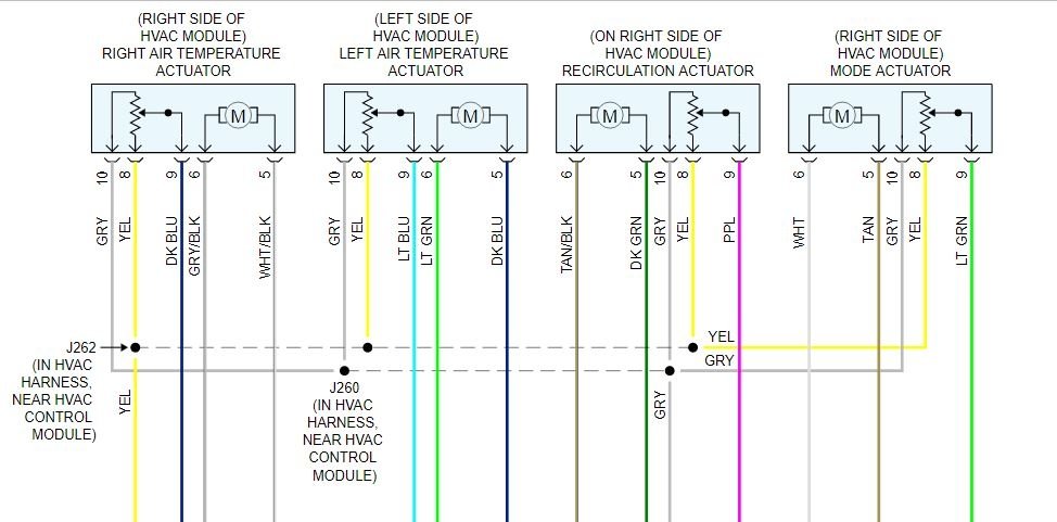

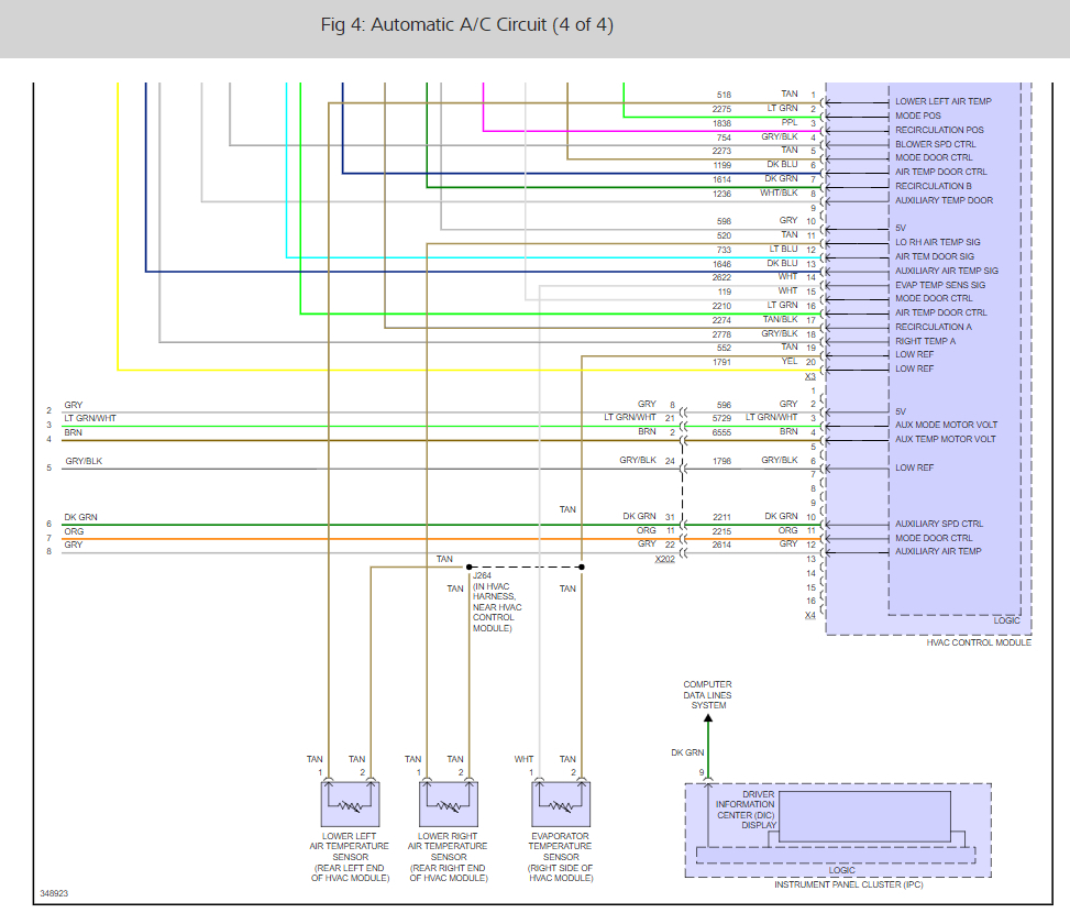

If none of the actuators move in response to the controller, the fault is likely in the controller. The mode and blend actuators are simple motors with a feedback circuit and each has a different control feed and return signal so if all of them are not working the common item is the controller. Voltage wise the Gray wire should be the 5 volt feed. The Yellow wire is ground (low reference) from pin 20 on connector X3 on the controller and the signal wires depend on which actuator you are testing. See the wiring diagram attached for those colors.

Okay, try this, take a jumper wire and connect the yellow wire (low ref) to a good ground. Test the system. Any change? The sensors in each actuator share the 5 volt and the ground, you said you found that was there already. You say the actuators return to the default positions, is that after you move them or do they not move at all? They use simple revering polarity to move them, connect your volt meter across the drive wires and see if you get a voltage when you select that actuator. If not then we will need to look at the powers and grounds into the controller.

Yes the yellow wires should all read the same and they should read as the low reference which is a ground buss inside the control module. It is pin 20 in connector X3 should be next to another low reference Tan wire in pin 19 of the same connector. The yellow wires from each actuator come back to a splice in the harness not far from the controller connector.
