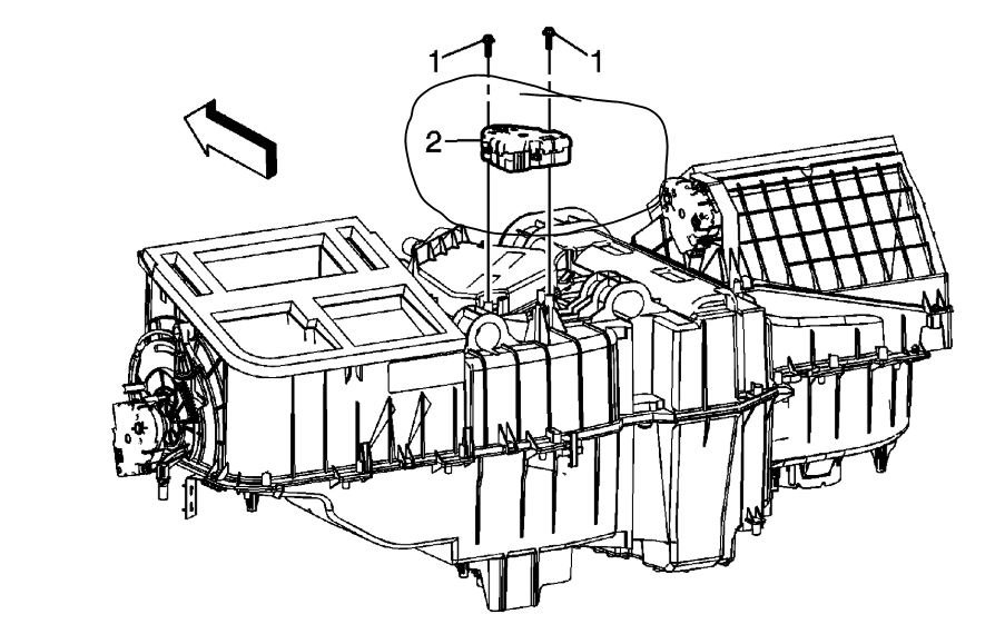

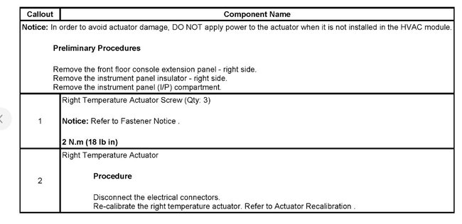

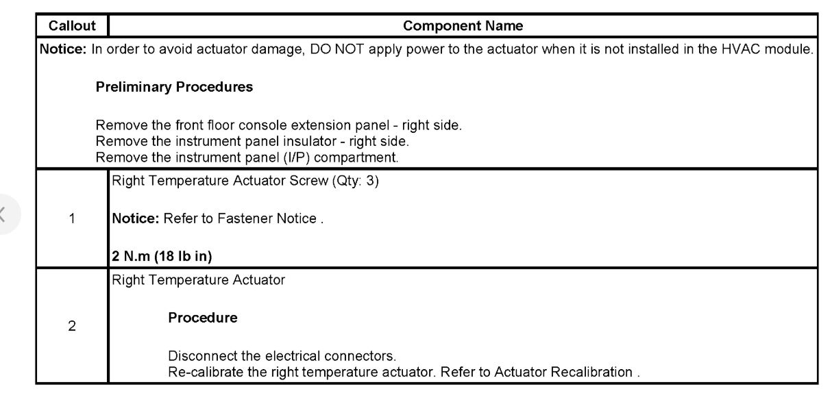

Blend door actuator on the passenger side need to be replaced, and the part it connects to don't know the name. The first one you can see through the glove compartment on top.
