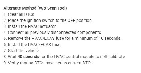

Do me a favor. Try the relearn procedure listed below in pic 1. If that does nothing, we need to move on to testing.

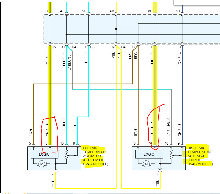

See pic below.
