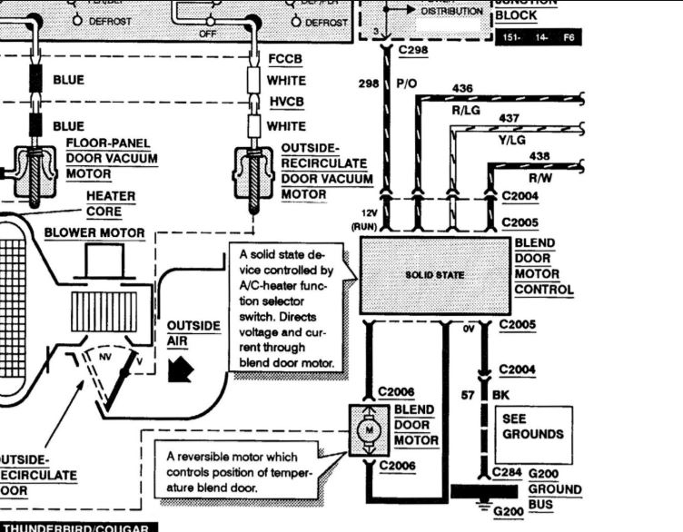

In the beginning I heard clicking coming from behind the dash, accompanied with the inability to change temperature. After taking out the glove box, I noticed the source was from the blend door actuator, which went bad. I went to rockauto.com and got a replacement, and quickly replaced it. It may have been foolish not to disconnect the battery, but I figured that it would not be that big of a job. After plugging it in, I found out that no power goes to the new actuator. Any advice that I could get?
Oct 24, 2018 at 10:14 AM
Good afternoon
The battery does not have to be removed for this repair. they key should be off.
I will attach a wiring diagram for you to view. make sure there is power to the blend door actuator when you command cool or heat. make sure the connector is not damaged as well. inspect the pins for any damages or burned pins.
Oct 24, 2018 at 2:29 PM
SURGEIMPULSE
  • 67 POSTS
This diagram is for inside the dash, correct? The air also only goes through defrost and and floor, no matter what I set the climate control to. I checked the wires connected to the BDA, and surrounding areas, including fuses. No issues.
Oct 25, 2018 at 6:12 AM
If you verified all voltages to the actuators, then you either have a bad actuator or the doors they are moving are seized.
Oct 25, 2018 at 7:58 AM
SURGEIMPULSE
  • 67 POSTS
Used a ratchet to see if the doors have any move, they work perfectly. New actuator I ordered must have been damaged on shipping or something because the replacement works great! Thank you.
