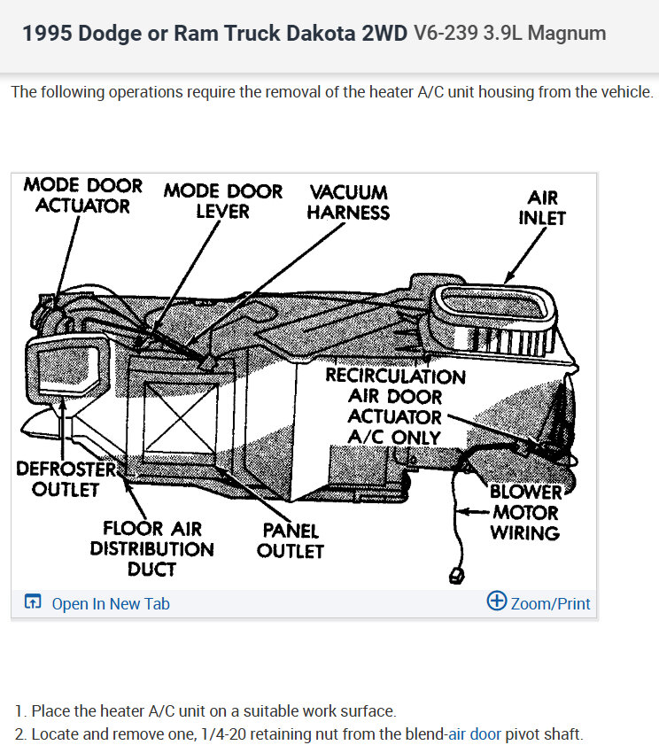

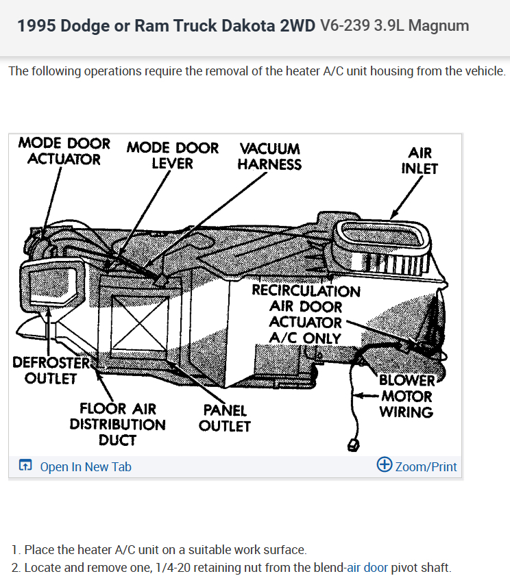

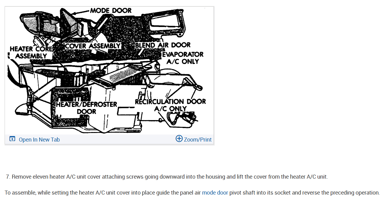

Here are the blend door locations which are vacuum operated. Check out the images (below). Let us know if you need anything else.
