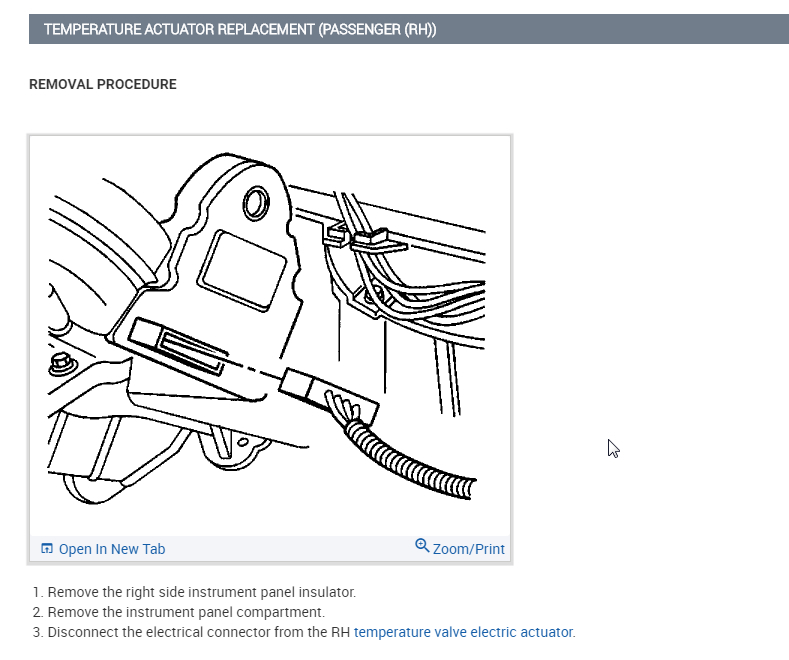

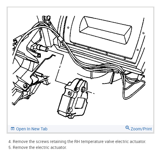

Yes, the diagram is for the passenger side actuator. That's the easy one. The driver's side is nearly impossible to get to. It's by the gas pedal and up to the right behind a jungle of cables and hoses and harnesses. Nothing fits in there, no wrenches, screwdrivers and even mini ratchets. I managed by some miracle to take it out but now I can't install the new one I bought back.

I totally understand. A tool that I came across that seems to bail me out when I am in that position is the one shown in this video. Clearly I don't endorse this specific one but it just illustrates how it works. There are many other brands but they all function the same.
All you would need to do is be able to get the bit up to the screw and then get your hand close to it just to how it in place. Then you can bend it down out of the way where you have more space and are able to spin it.
